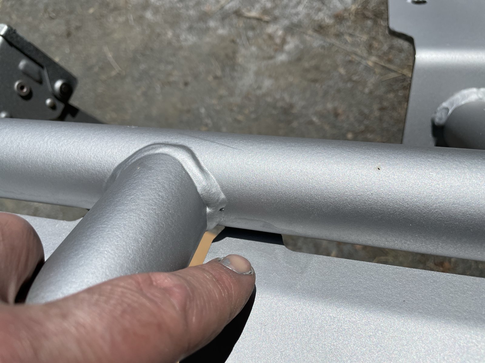

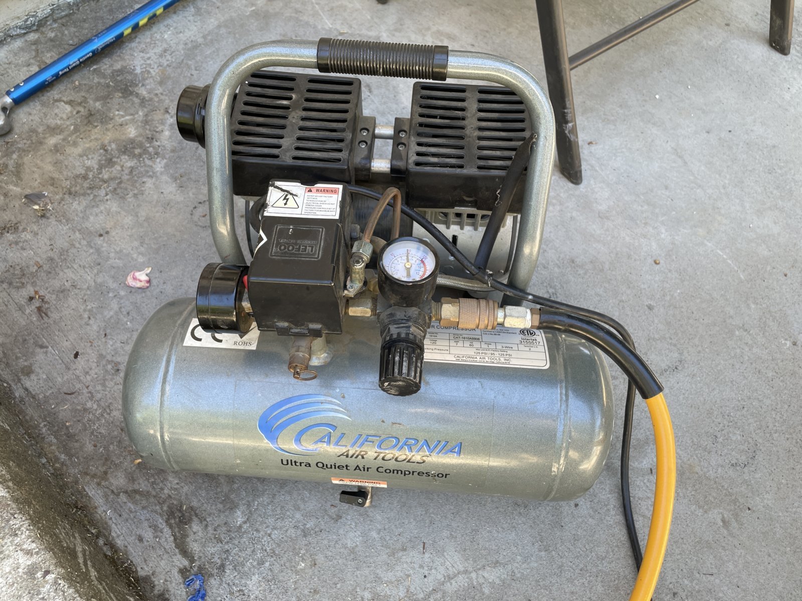

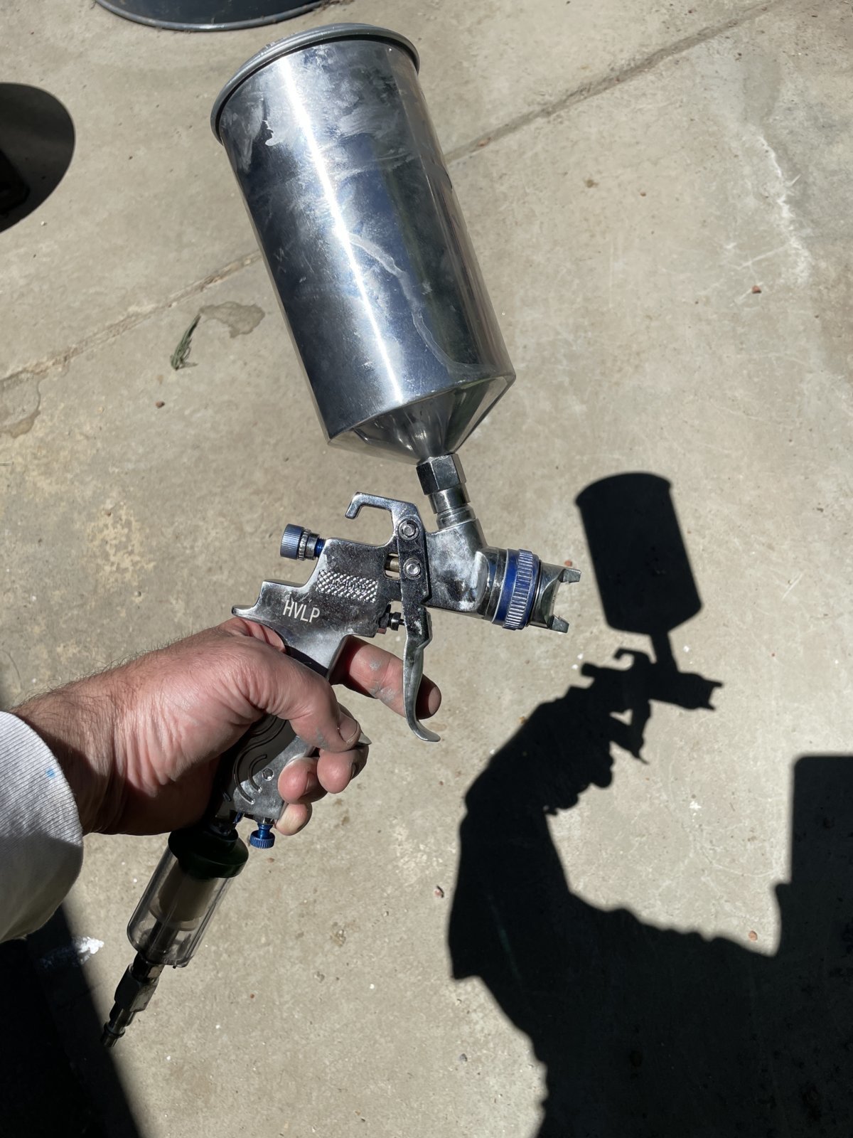

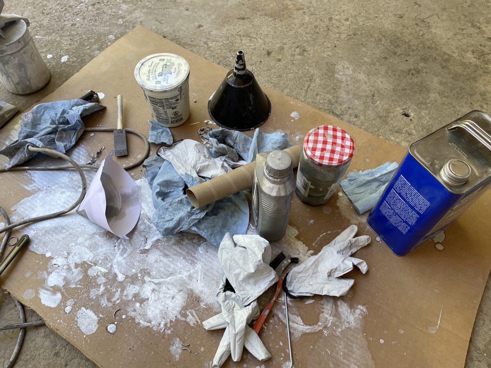

    The magic of Amazon Prime delivered me a cheap HVLP sprayer (about $60ish.) Never used one before so I put half a quart of rubbing alcohol in it to figure out spray patterns vs. air flow, and what my little 2 gallon 1HP air compressor is capable of. (Rubbing alcohol, not water, because alcohol evaporates quickly & completely; didn't want even the tiniest trace of moisture in the HVLP gun which could cause local gunking/thickening of the metal primer I'm using, which cures not by air-drying/evaporation, but through polymerization promoted by water vapor/humidity.)
    HVLP sprayer is definitely the correct tool for this job. The essentially 100% stainless/metal seals & channels inside the simple HVLP mechanism can be thoroughly cleaned with acetone pretty easily. R.I.P my poor $400 airless sprayer from 2 days ago. :redxfall:
    Some equipment, along with the obligatory pile of dirty crap that painting usually seems to require:

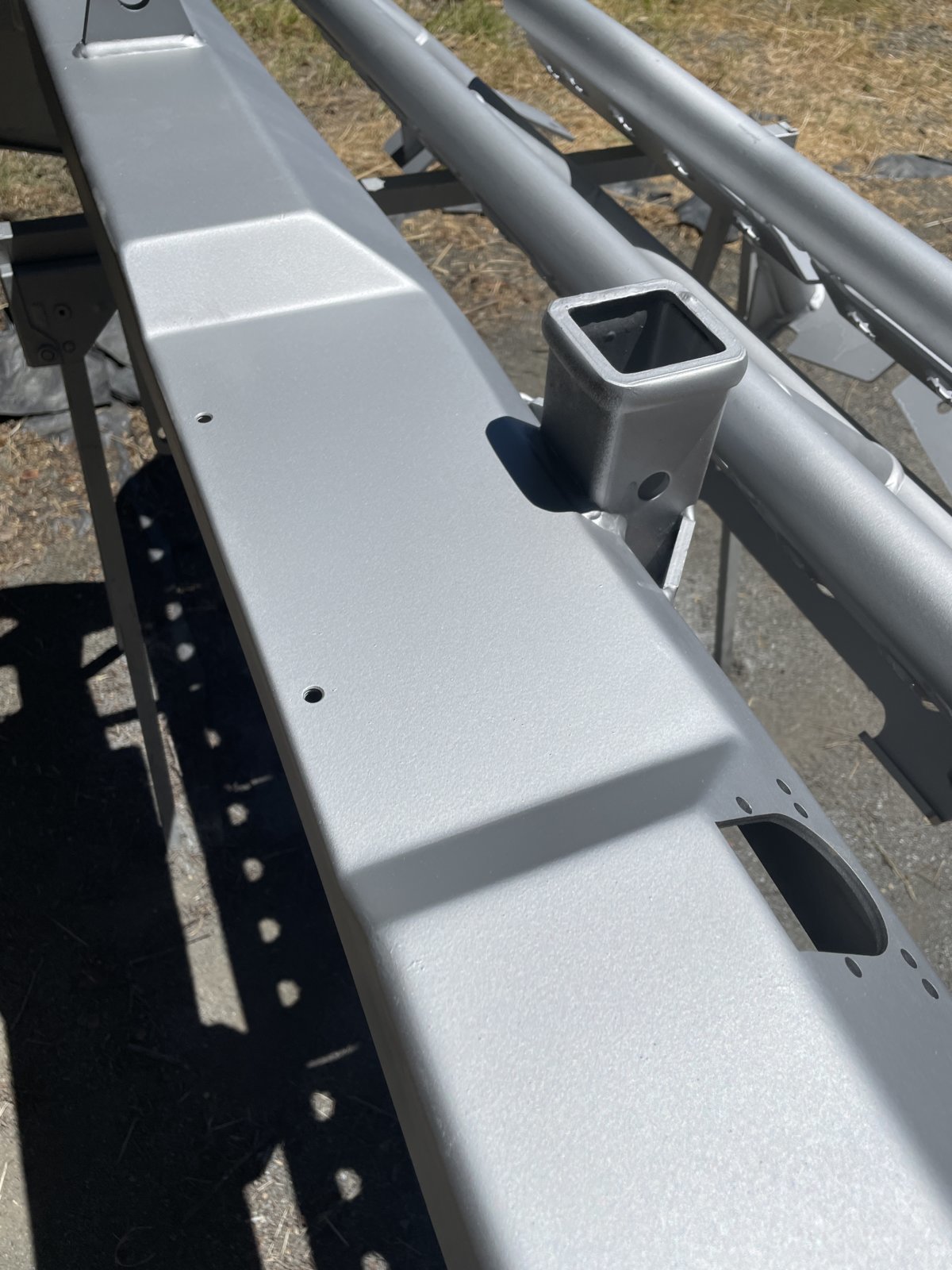

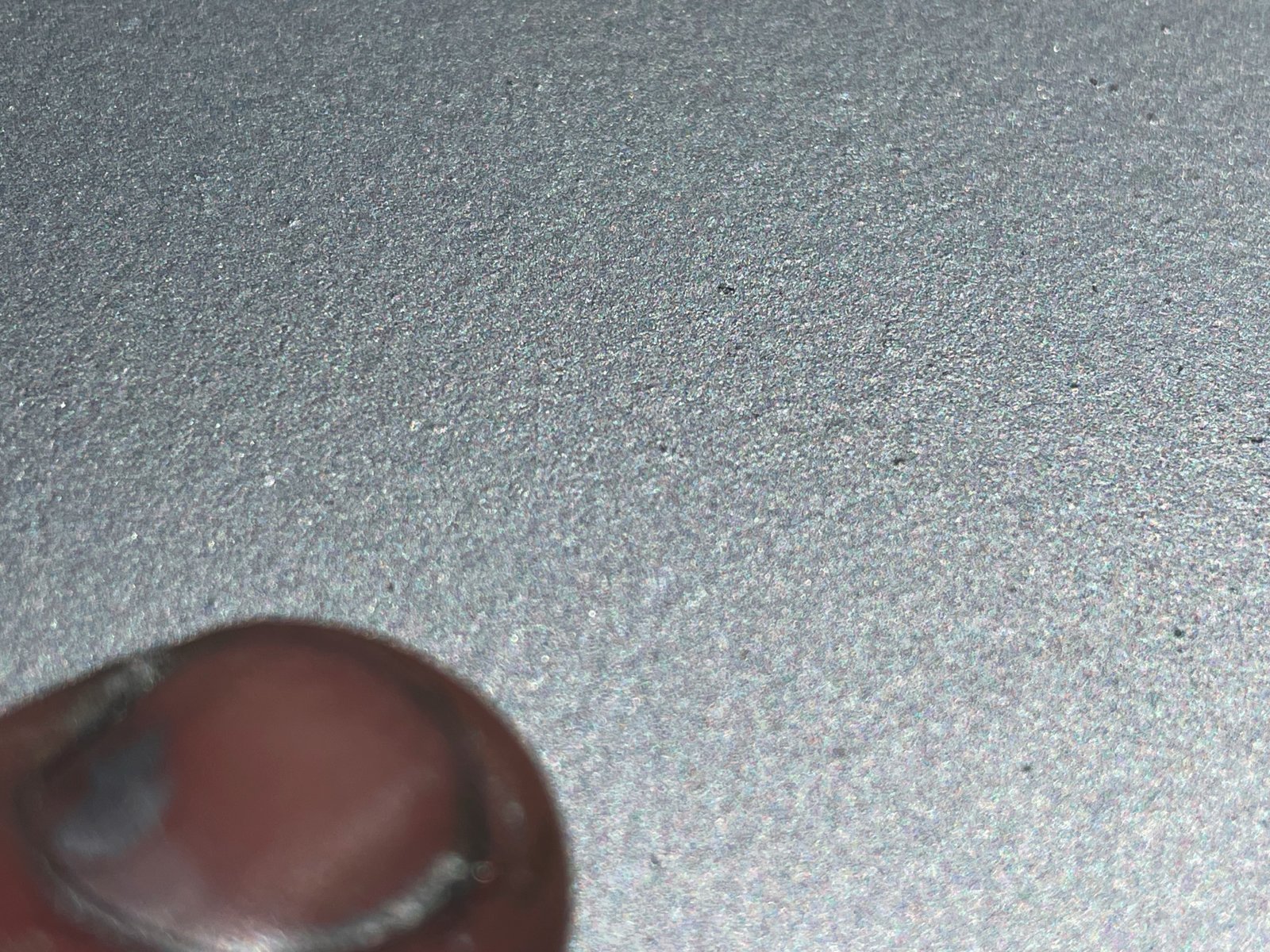

    Here's the final-final after 2 to 2.5 coats of primer. Basically this primer is about 30% aluminum powder (Al) by volume in (I believe?) a urethane-type substrate, probably with some other magic ingredients to help the aluminum powder bond & flow well onto steel. The Al is lower in the galvanic corrosion hierarchy than steel, so it will corrode first & preferentially, sacrificing itself (for a time) to protect the steel.
    I had some issues with the 40-micron filter basket in the HVLP sprayer not allowing adequate flow, so I thinned the primer a bunch -- too much -- and it still didn't spray hardly at all. Ended up removing the 40-micron filter entirely, but I had already over-thinned & couldnt go back. Resulting finish is probably not as smooth as it could be, i.e. when the excess thinner evaporates it leaves (microscopically-speaking) too-large gaps between the solids in the coating, resulting in a rough surface. But this was a second coat anyway so I didn't sweat it too much.

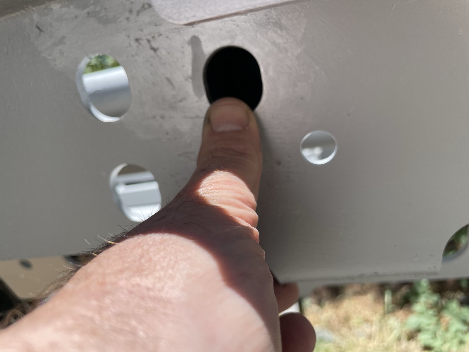

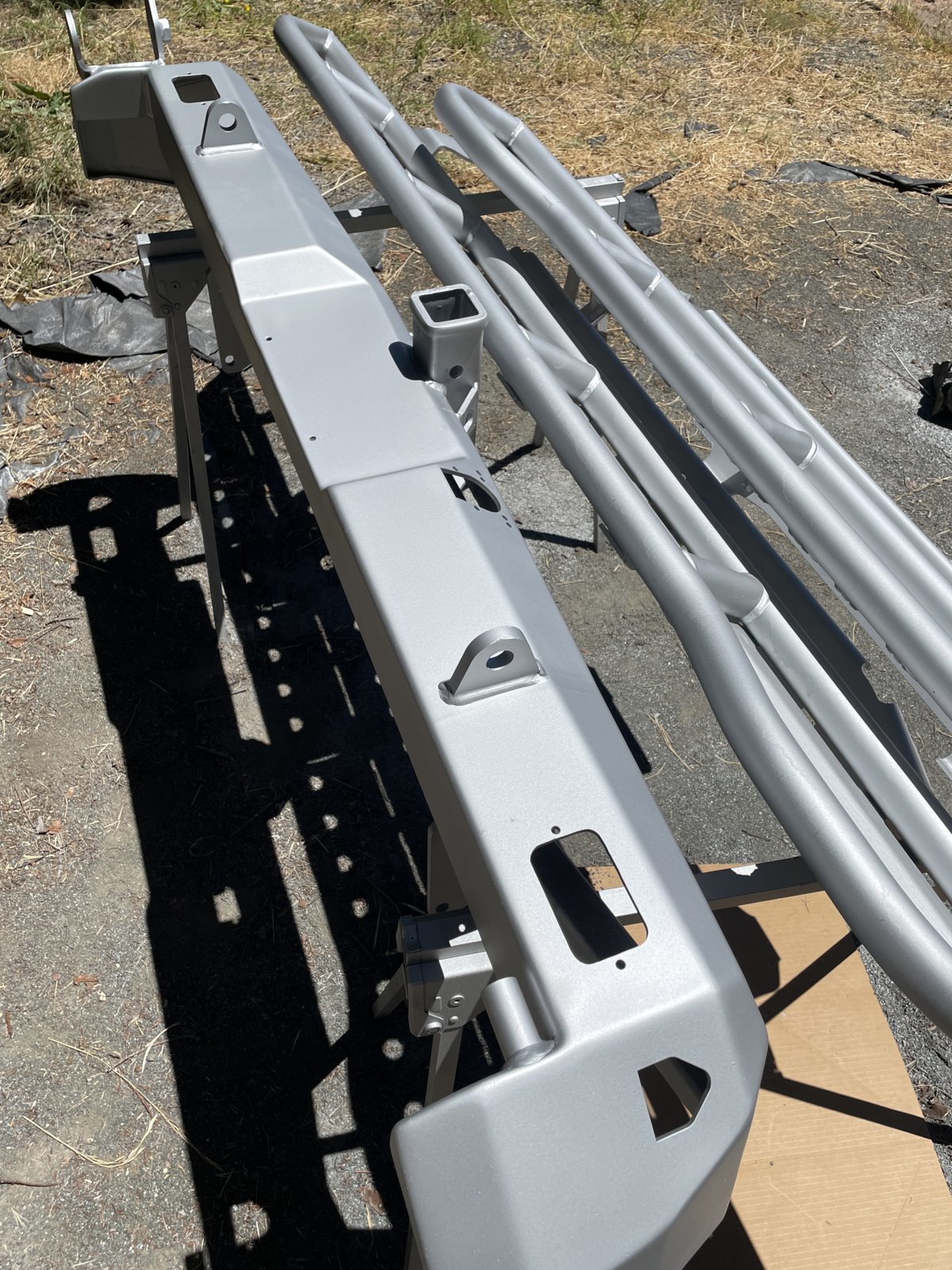

    Made sure to coat every square millimeter of surface, using a foam brush to get into the weld joints that are inaccessible to spray:
    Also completely flood-coated to full depth the inside of the single open tube in these sliders (no other openings) then let the excess drip out vertically into a catch container:
    Letting it all cure overnight & plan to do the first coat (of 2) of the 2-part epoxy black matte finish coat tomorrow.
    Learned a lot on this project. I've done plenty of 1-step rattle-canning on steel in the past. This is my first time ever prepping bare steel down to base using acid, using metal-specific primer & an epoxy finish coat, using an HVLP sprayer, etc.
    Without a proper spray booth & wire-suspension system this job is taking excessive time, i.e. have to spray, wait 6 hours, flip the parts over on their resting stands, then spray again, for basically twice the work per coat in a 2-coat primer / 2-finish coat process. I have a lot more respect for what a proper paint shop can accomplish with their dedicated painting spaces & equipment. I don't think I've saved any money over just sending this to a paint shop for maybe a $400 fee or so, but I value the learning and also the certainty that I've covered 100% of the surfaces.

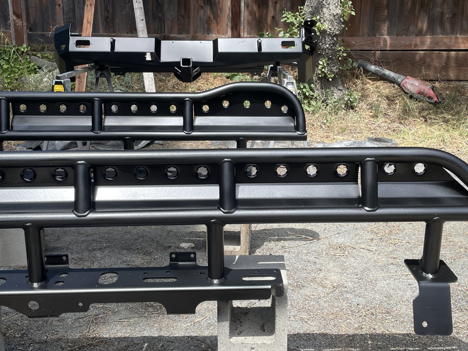

    Alright, it's finished. Rather than add to this thread here, I re-organized the whole process into a more coherent write-up over at this new thread. A couple photos of the finished parts are at the bottom of that post.
    TL;DR it appears to have come out pretty good. Certainly good enough considering my skills & doing the work in an open back yard w/ dust, bugs etc. occasionally filtering down out of the trees.
