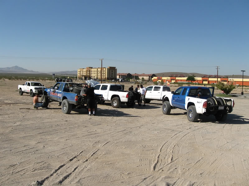

    Met up with some guys in Barstow behind the KFC. Their trucks were sick!

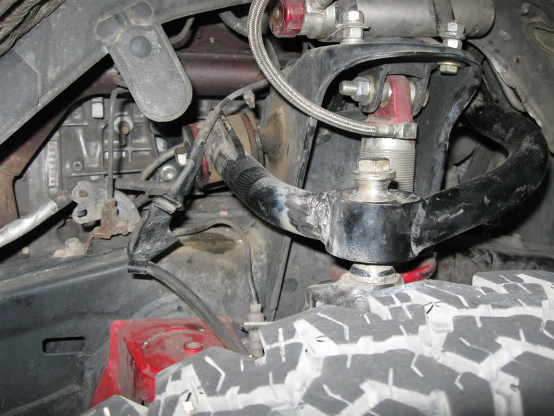

    Worn out coil-overs. That didn't take too long.

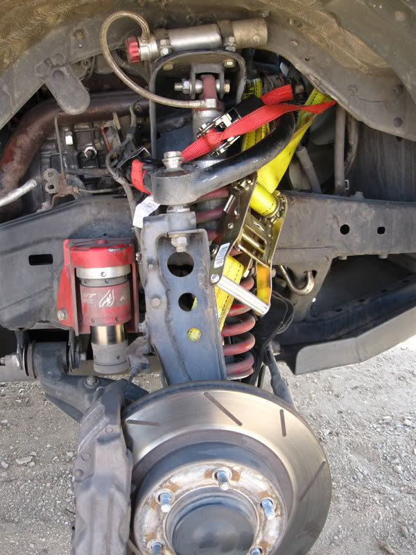

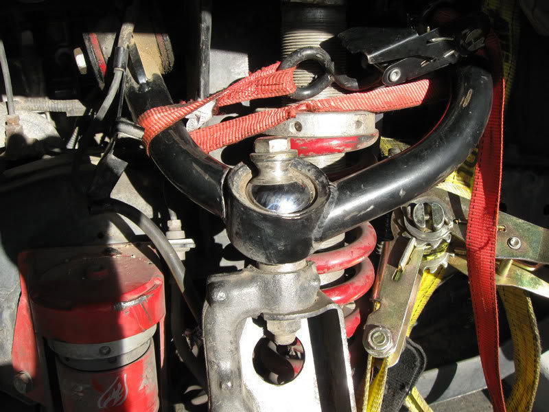

    And then the carnage came.
    With the help of Cody I got my front suspension strapped together well enough to idle the 8 miles out of the desert. It came apart 6 times so I had a little break in the monotony every now and then. ;)
    Back in the parking lot, lined up, and awaiting a mobile welder.
    If ever you break in Barstow, call this guy! His weld got my arse back to NJ!

    A ratcheted strapped UCA.... has to be one of the best jerry rigs i've ever seen :thumbsup: +1

    what exactly is the purpose of the limiting straps? i'm not entirely clear on what they do. plus they seem like they would break everytime. seems to fragile to be on a truck, much less a baja truck

    Concept is that the straps will reach their limit before the shocks do, or whatever other suspension component is the limiting factor for wheel travel. For most of us, either the shocks reach maximum extension or the UCAs bind to restrict wheel travel. Do that enough times and something's gonna break. The straps are there to limit travel before anything bad happens to a critical component.
    The straps are actually amazingly strong, but I'm doubling them up for the next go-around. I started replacing the coil-overs last night and got the driver's side done. I should have more pictures posted after this weekend.

    that makes sense but fabric seems too weak. it there a reason they dont use thick cable instead?

    Flexibility, and think of it as a fuse. If it breaks, then you're pushing pretty damn hard and had better slow down before something else goes.
    I know a few rock crawler guys that use chains, but then they're not moving at more than 4mph and trailer their trucks around so the noise isn't a concern.
