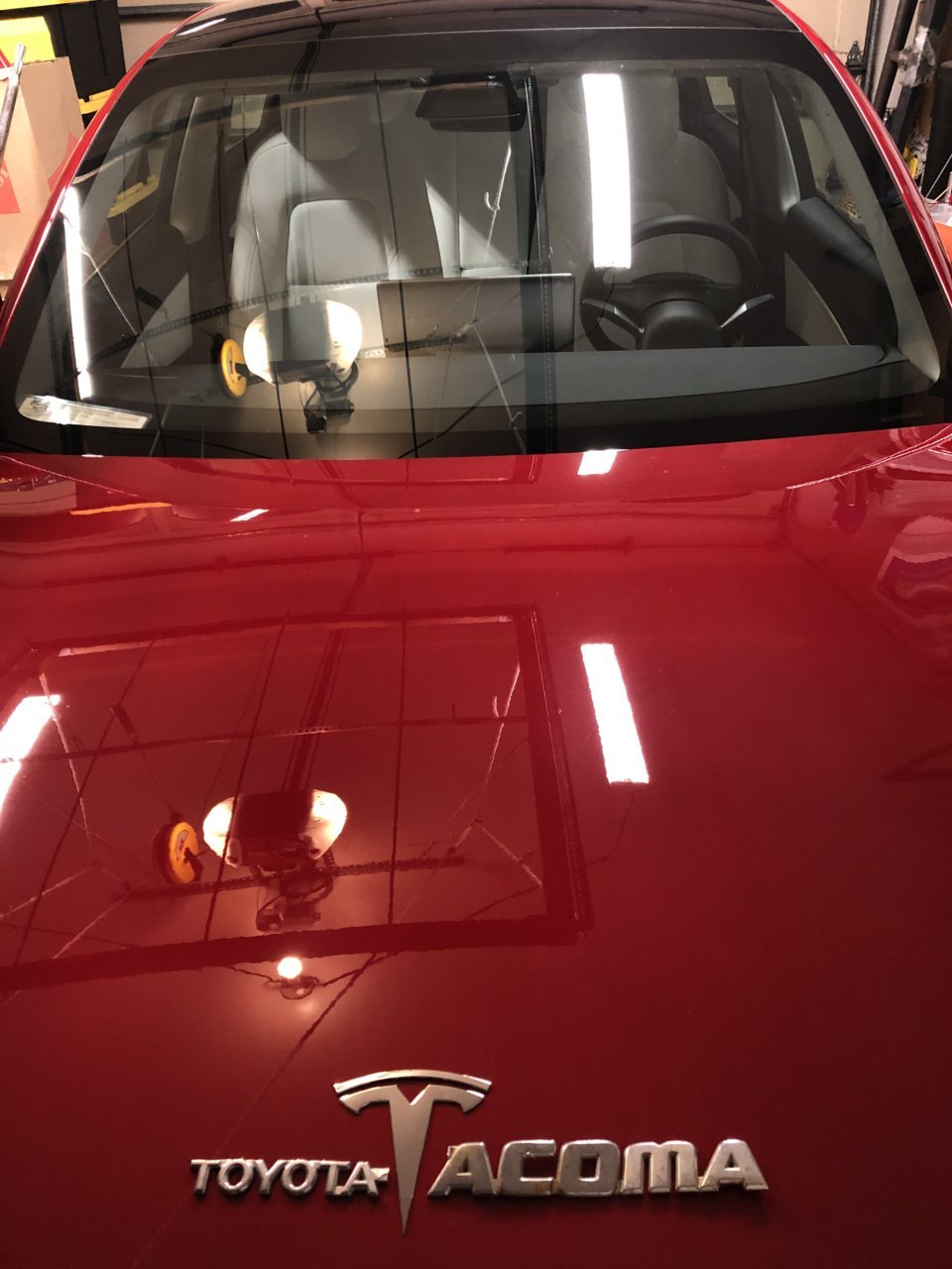

    Ditched the Tacoma, got a Tesla Model 3.
    Or did I?

    It's less Tacoma and more mod
    It's a V6 thing
