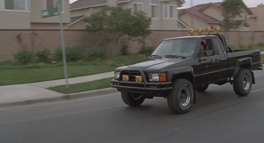

    Same one on Marty’s truck. It’s a rollbar from a 1985 Toyota Pickup.
