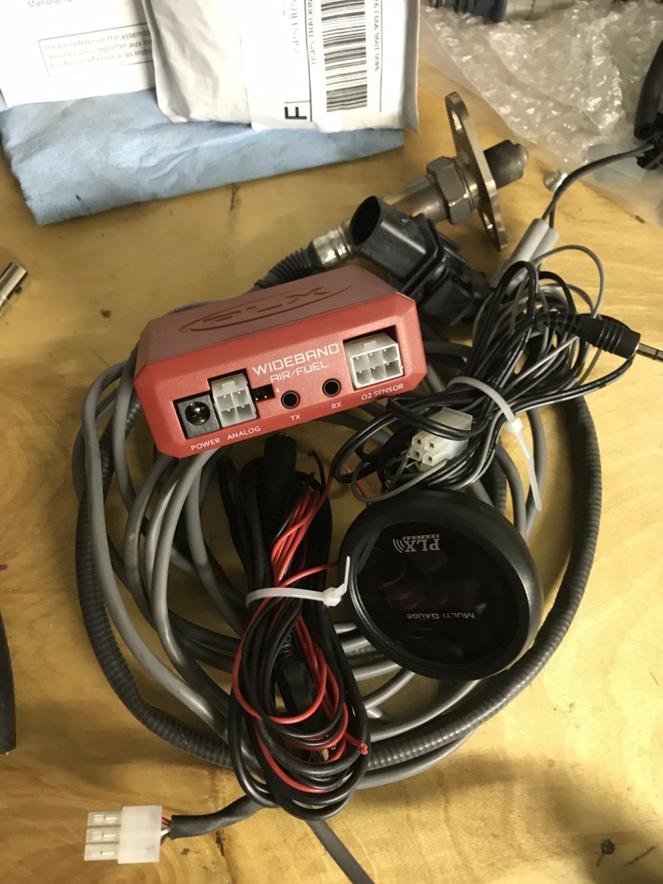

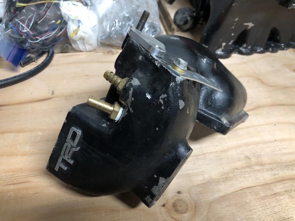

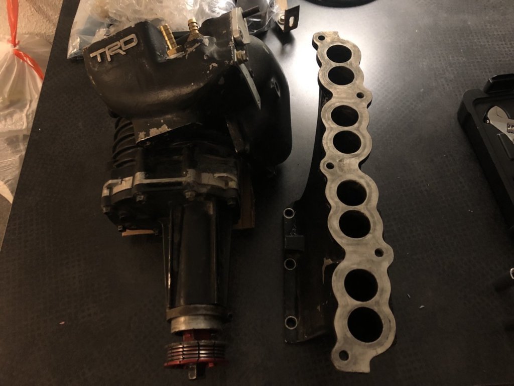

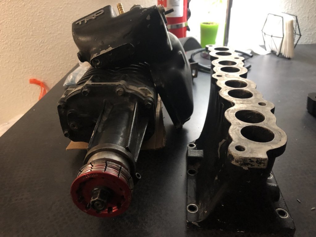

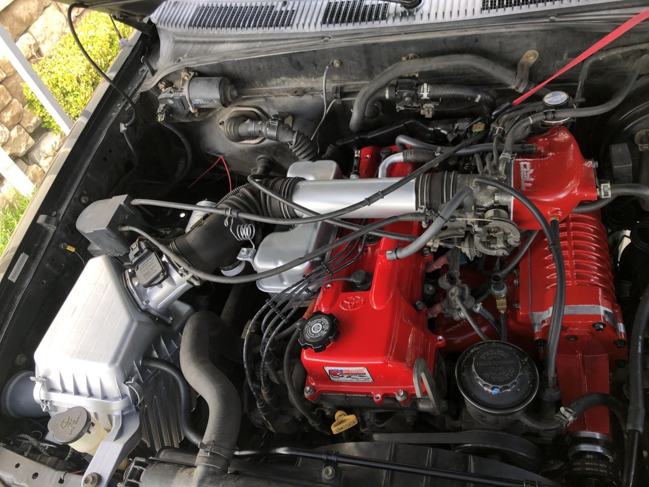

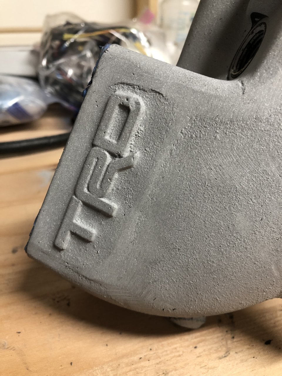

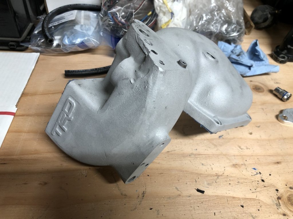

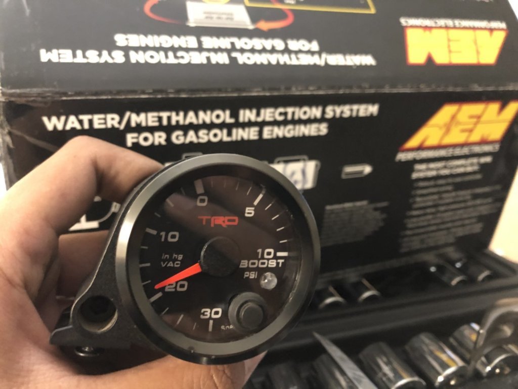

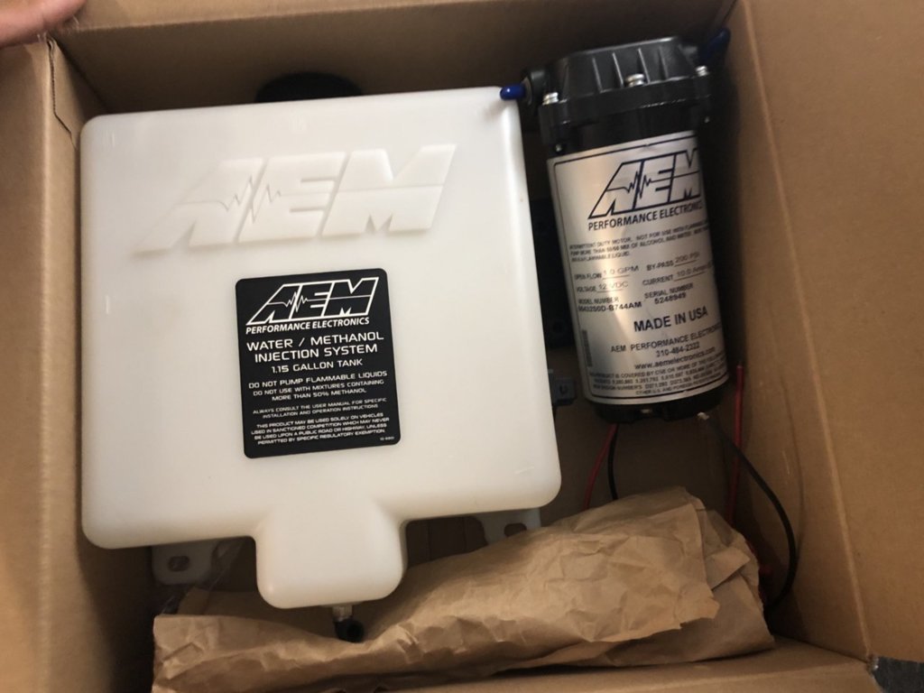

    Exciting new addition to the truck in the works!
    A SUPER rare original TRD Supercharger for the 3RZ-FE made by Alpine. The wine pairings for this evening include an AEM Methanol Injection System, a PLX DM-6 Multigauge and SM-AFR Wideband Simulator, along with a tasteful modern reproduction of the original TRD boost gauge made by Speedhut.
    This is a well used supercharger, I would be Owner #3. It's in excellent condition in exception of the EGR system. The PO ran a block-off plate so it wasn't an issue. However, California with it's strict emissions laws would never let that fly. Both EGR stud holes are stripped. One side was drilled out to an M9 or M10 bolt, while the other remained precariously attached with Helicoil.

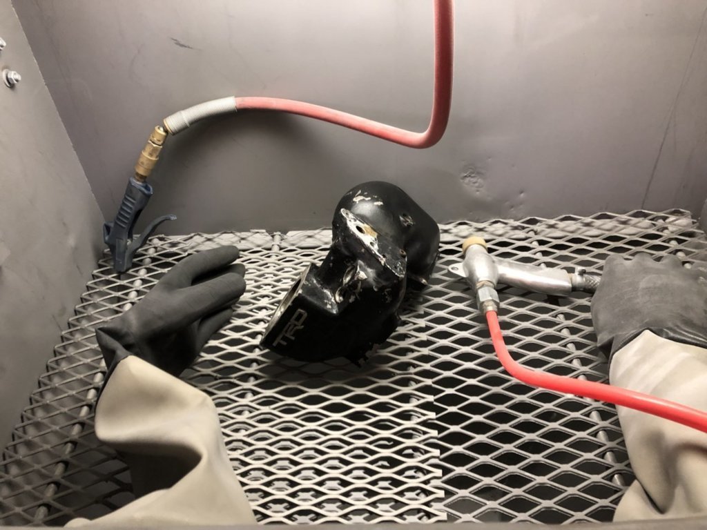

    That wouldn't fly for me. I dropped off the intake plenum at Tech Machine Shop in Livermore, CA who is currently TIG welding the holes shut, machining, and re-tapping the holes with brand new studs. Also with a well deserved jetwash.
    I have sandblasted the manifolds in preparation for porting and polishing. After that comes paint!
