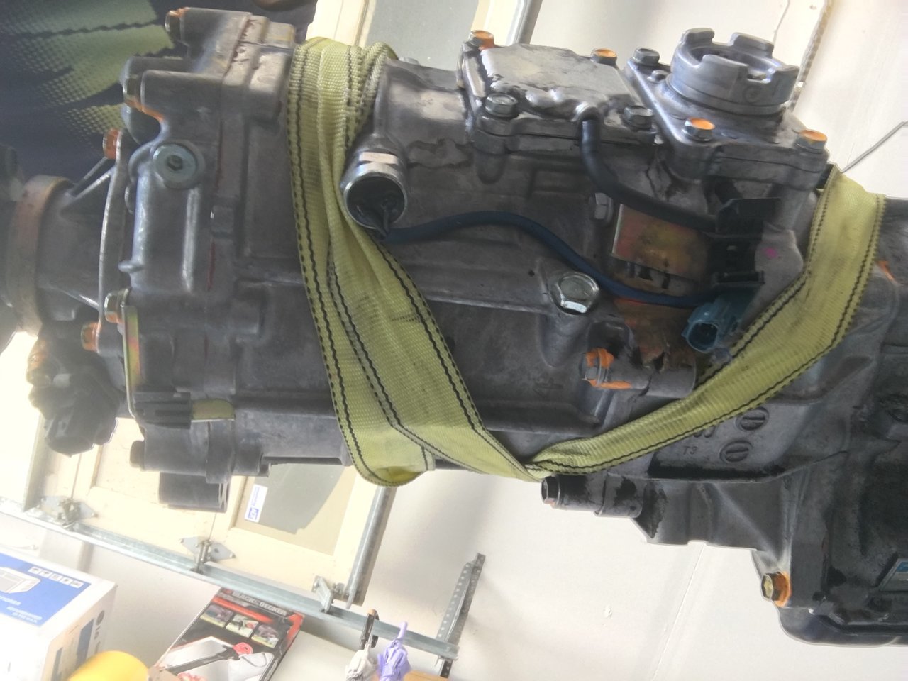

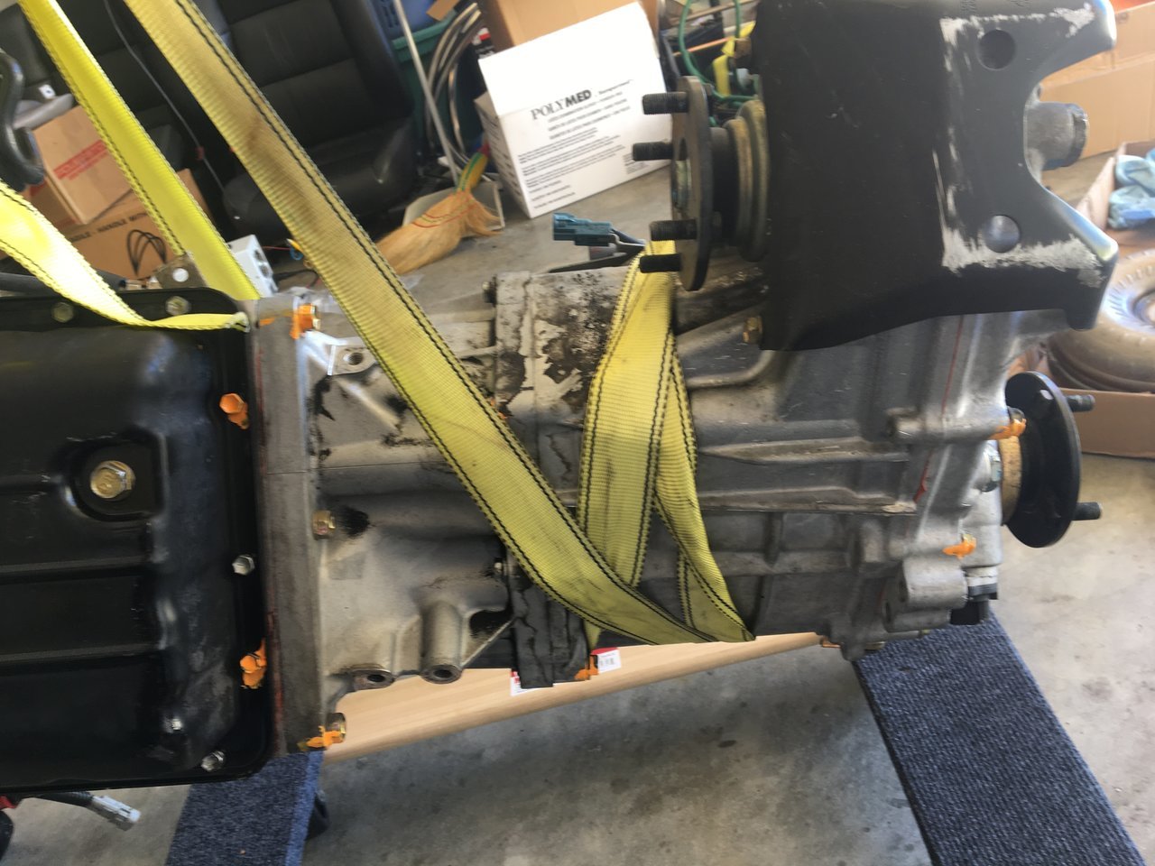

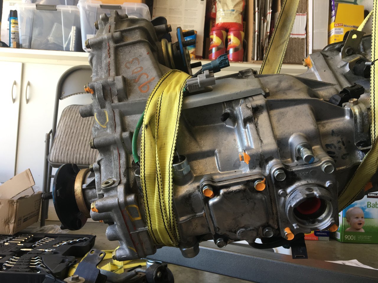

    Will do. It's a standard J-Shift. Came from a truck with non-ADD and manual hubs. There are some connectors on it but I don't know what they're for -- VSS maybe?

    Possibly. I'm just looking at that transfer case, it just looks different from that end, idk maybe I'm just crazy

    Ah gotcha. Just looks a little different, could be because it's off a 4cyl. I think for whatever reason I just pocture the tail housing that the t case bolts on to looking a little different than that

    I think I'm just crazy, looks like a sweet find. What other parts did you get with it

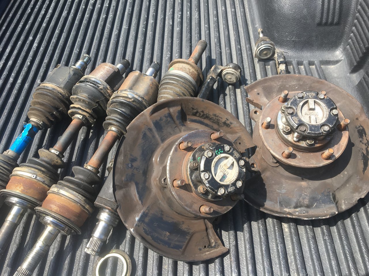

    Picked up the Manual Hubs, Steering Knuckles, and 2 sets of CV Axles today for $350.
    I actually paid more for these than I did for the transmission somehow. Red/Black Powdercoat coming soon!

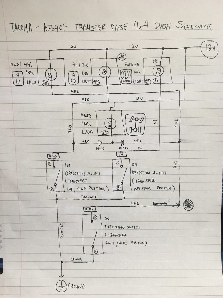

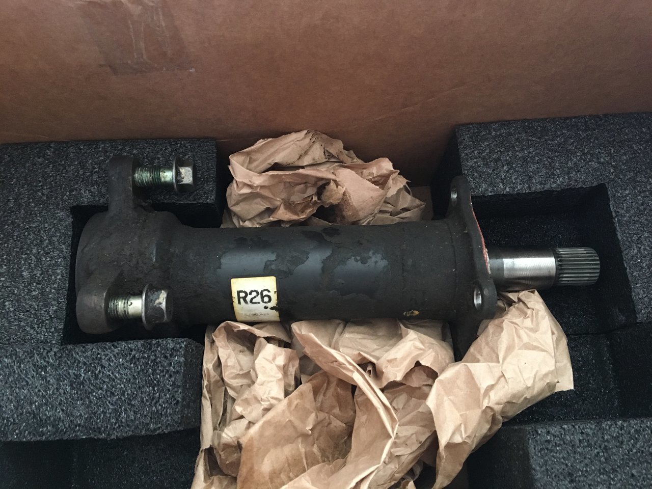

    Making some progress on parts. I have a manual tube axle shaft being sent to replace the vacuum ADD 4Runner one I have, and the half driveshaft plus some wiring is coming in soon too.
    I'm using the unused RR DIFF LOCK and ABS light sockets to tell me if I'm in 4HI or 4LO. Planning on having some custom gauge faces made.

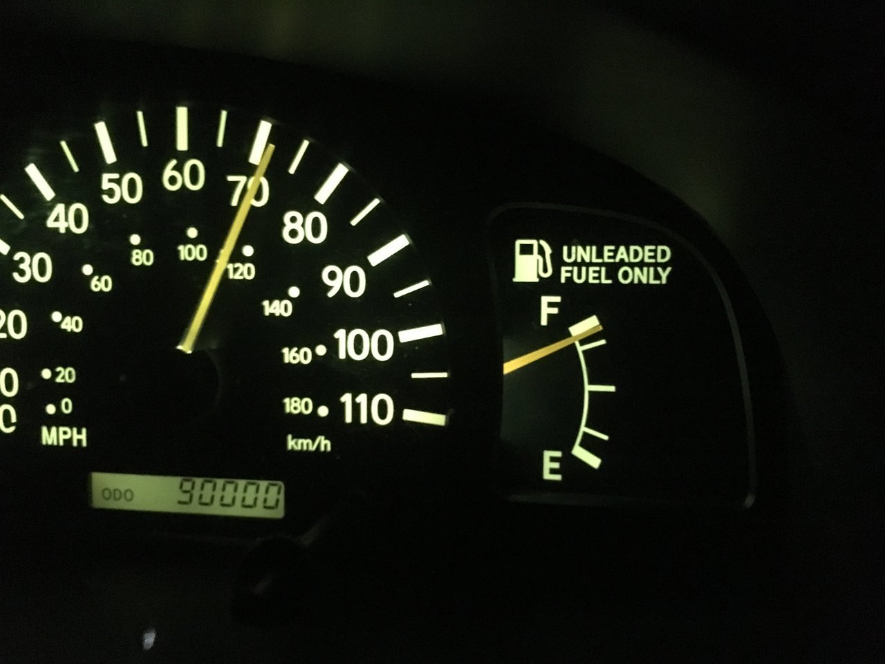

    Just rolled over 90,000 today.
    Manual hub axle tube for the front differential came in the other day, as well as the correct length driveshaft for the 4x4 swap.
    Swap will be happening soon, stay tuned!

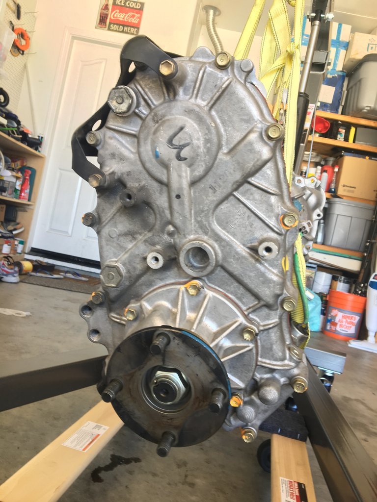

    I found out why you thought my transfer case looked different from yours. The transfer case between the 4 Cyl and 6 Cyl are indeed different.
    Check this post for info.
