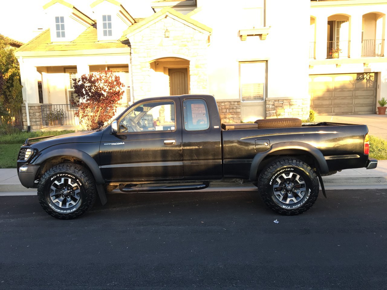

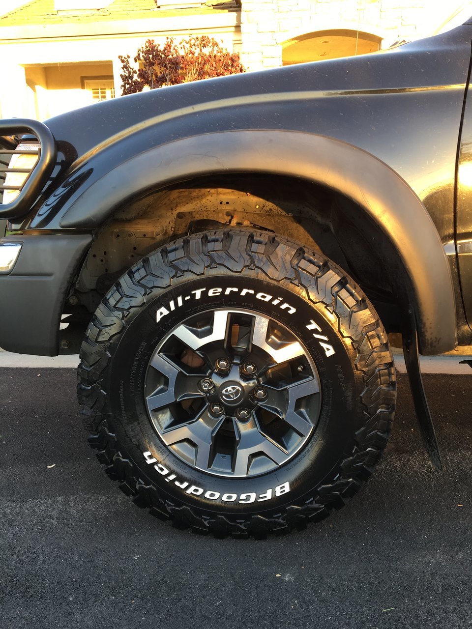

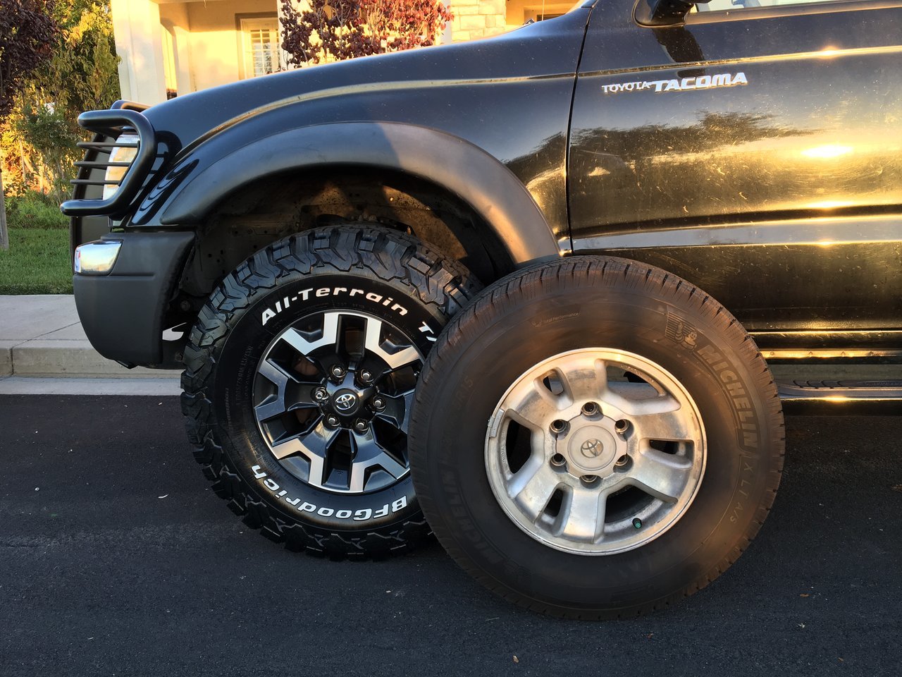

    Got some new wheels and tires to replace my old ones!
    I bought the old Michelin XLT tures in August last year when I was still naive about trucks, hence why they are small and wimpy. I literally told the service adviser at Costco to "put on the stock size". The truck originally had Firestone AT 265/75/R15 from the dealer (still have the original dealer spare) and I replaced them with Michelin XLT 235/75/R15 tires. Fast forward to this month - I found a good deal on 2017 TRD Off-Road 16" rims for $400. Discount Tire was having a $100 off $400 sale so I pulled the trigger on some new BF Goodrich KO2 P275/75/R16 tires for $600. Spent $100 to mount and balance them. 2nd Gen Toyota wheel locks were $40. This setup cost a total of about $1,200, not bad for what it is.
    Now there is some rubbing on the UCA at full lock, I can feel the truck shudder when at absolute full lock so I'm going to have to run wheel spacers and trim the pinch weld area to get them to fit right. The fit fine right now, I've put about 100 miles on them but parking and making sharp turns is really difficult due to the size and restrictions of the tires. Also, RIP fuel economy.

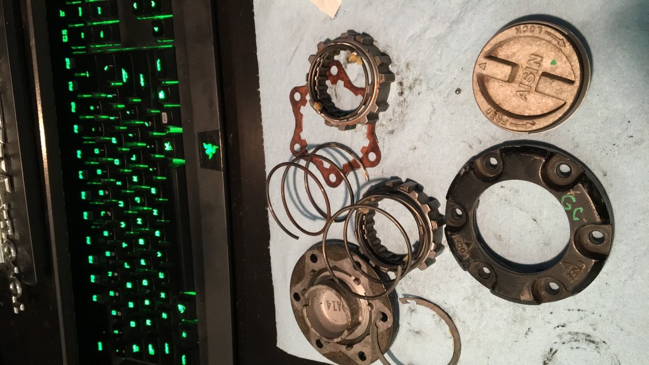

    Thanks man! Getting my manual hubs powdercoated red/black Monday and finish rebuilding them.

    That'll look really good. Pay extra attention when reassembling them, I put one of the springs in upside down and the hub wouldn't lock

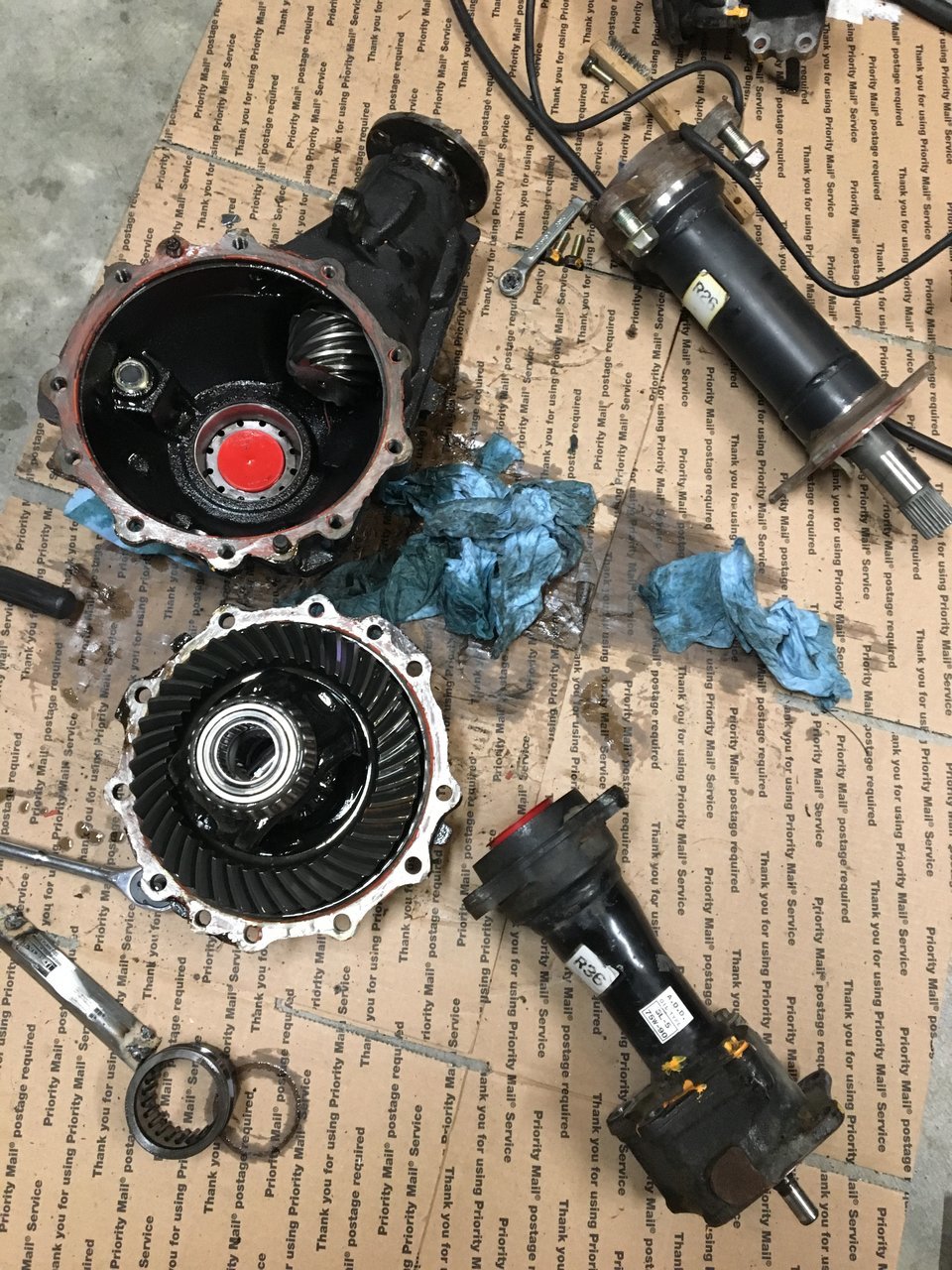

    Turns out the yard in Reno where I bought most of this stuff gave me a 4.10 front differential instead of a 4.30. I would've never known if I didn't open up the pumpkin to swap the manual output shaft for the manual hubs.

    Me neither! I just know you have to have matching gear ratios in the front and rear or you'll fry your transfer case pretty quick.

    Dang those look badass. I swear the 3rd gen wheels look better on first gens than 3rd or 2nd gens by a long shot. Truck looks great! Good thing you found that oopsie by the wrecking yard - they're not always that accurate - I ran into a problem with a rear axle shaft that cost me a $100 or so in shop fees when they took off the bearings and saw it wouldn't swap over. So are you going to stick with 4:30's?

    Yeah I think I'll stick with the 4.30 - I don't want to make the fuel economy worse than it already is. I'm planning on buying a parts truck to swap the v6 over, including the rear locking axle so no point in switching the rear axle now.
