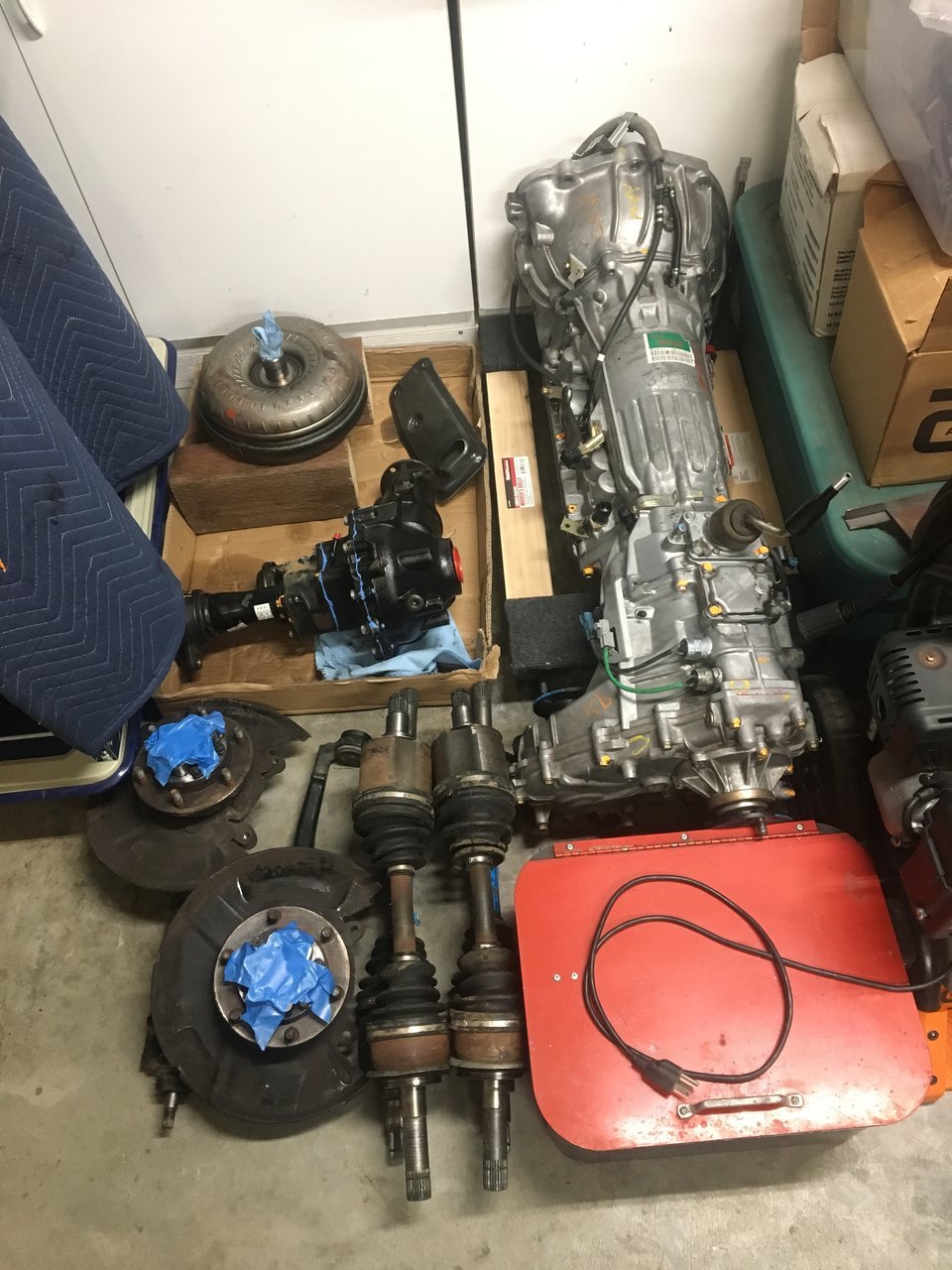

    It's getting there! I only need the correct front differential now.

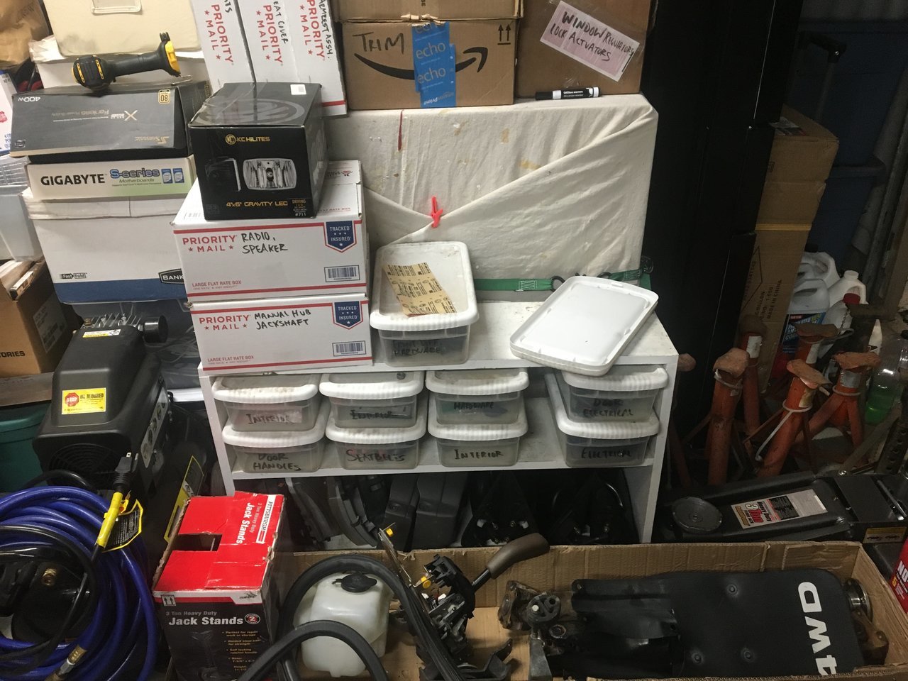

    Finally took the time to organize my hoarde of Tacoma parts.

    You can indeed reuse the A340E 2WD transmission for a 4WD system. The only difference is the length of the output shaft which on the A340E isn't long enough to accommodate a tail section and transfer case. The A340E and A340F are identical in exception of aforementioned output shaft.
    The V6 and I4 variations do have differences. The v6 transfer transfer case has a side transfer case shifter, wile the I4 transfer case is top shift. The bellhousings between the two are also different but can be transferred from your original transmission.
    A good shop can swap the output shaft for you, but with the cost of labor it's cheaper to just buy a new transmission. I only paid $250 for mine when a shop would charge a couple hundred plus the cost of the output shaft to convert the A340E to an A340F.

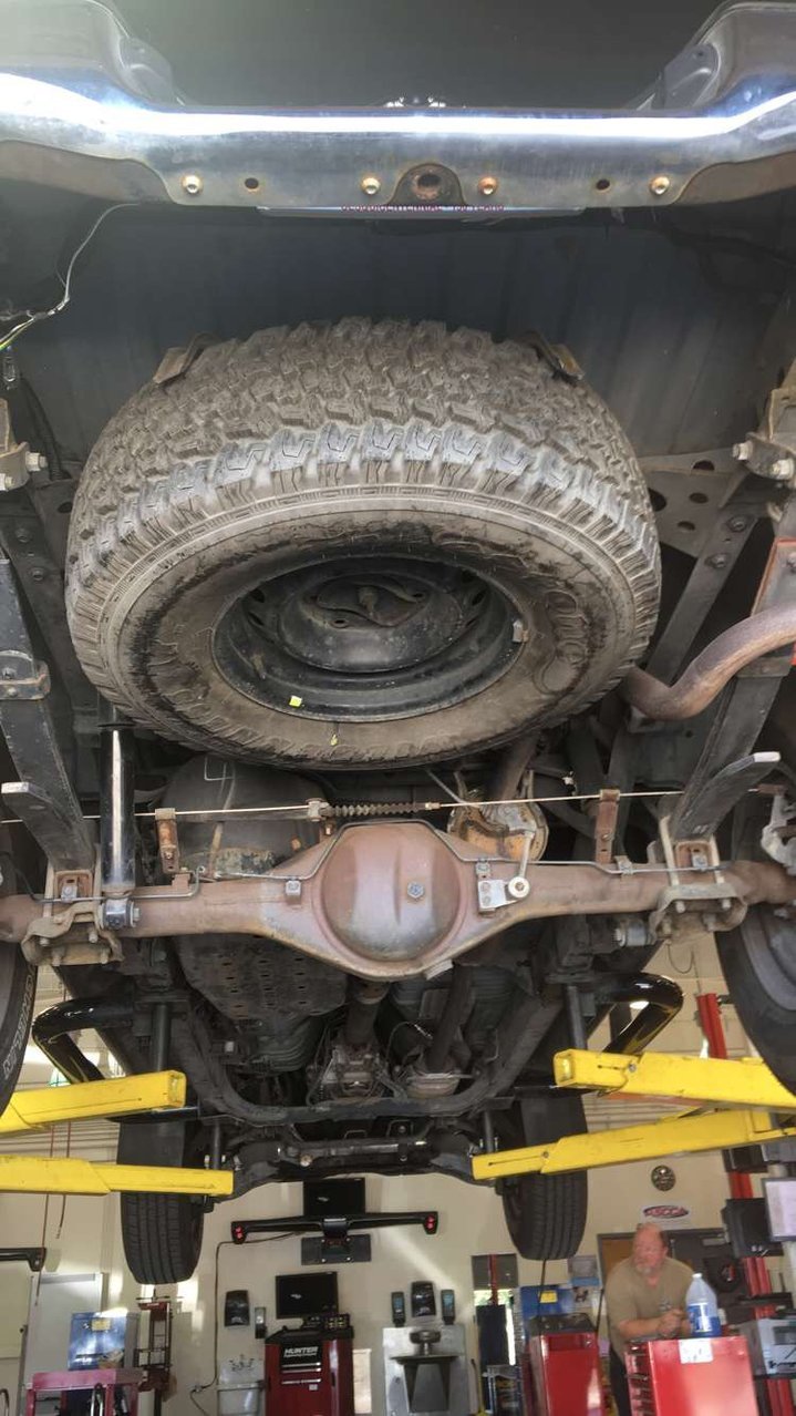

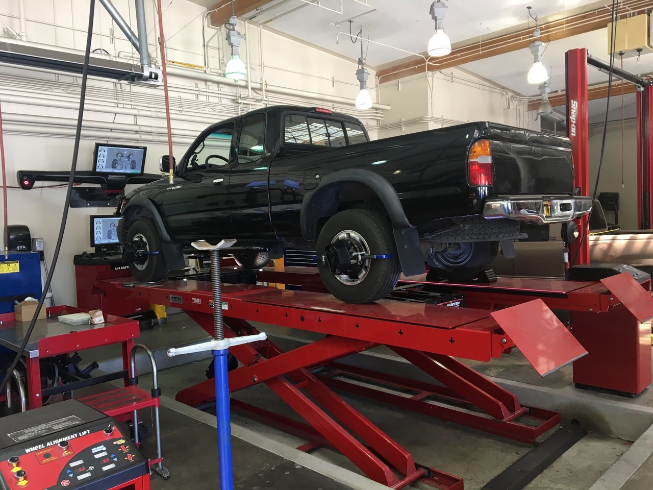

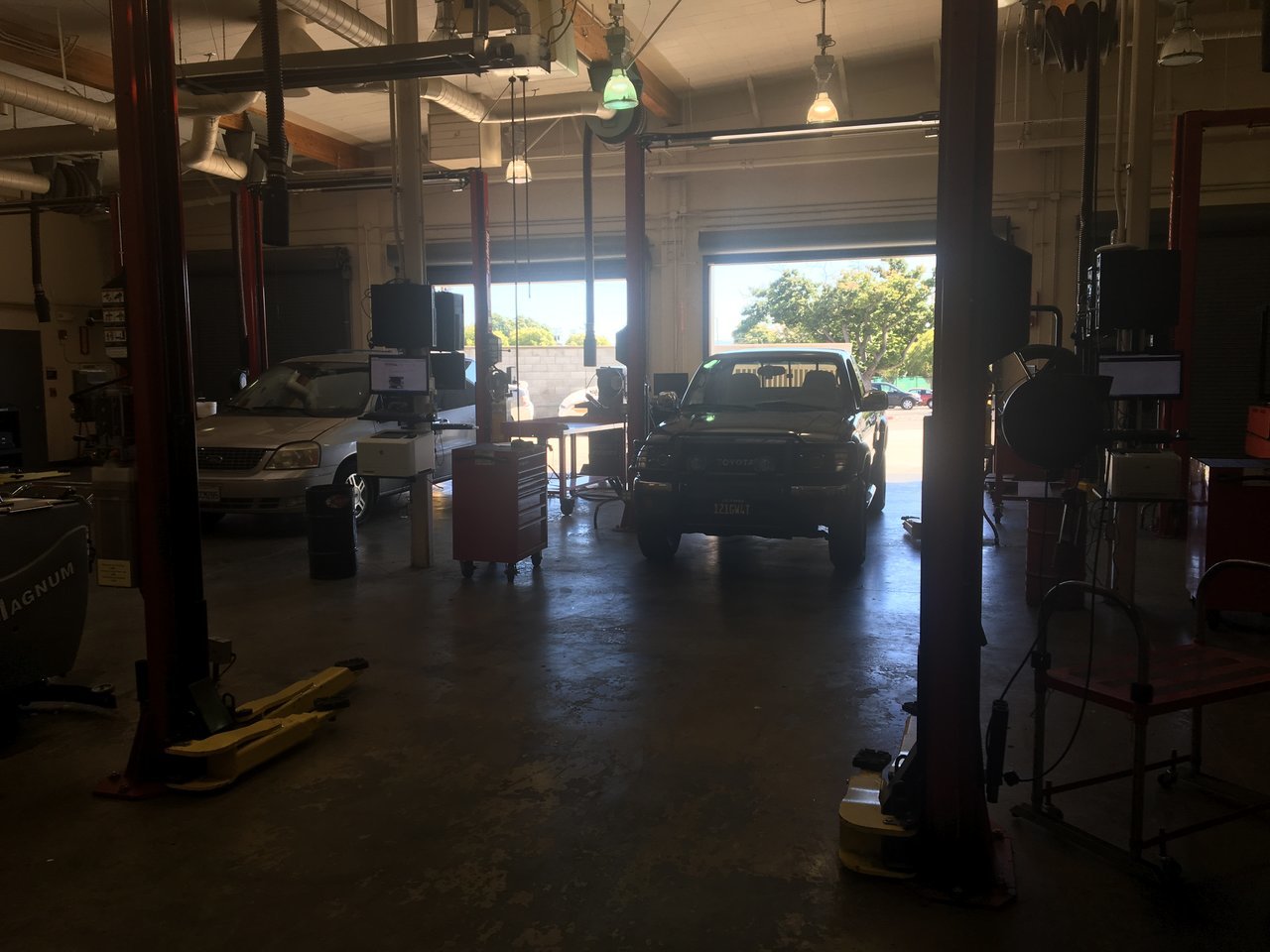

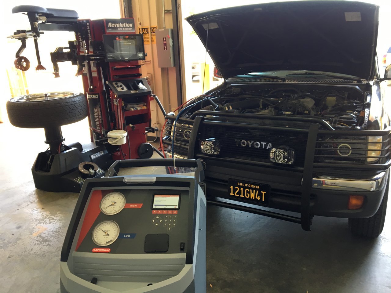

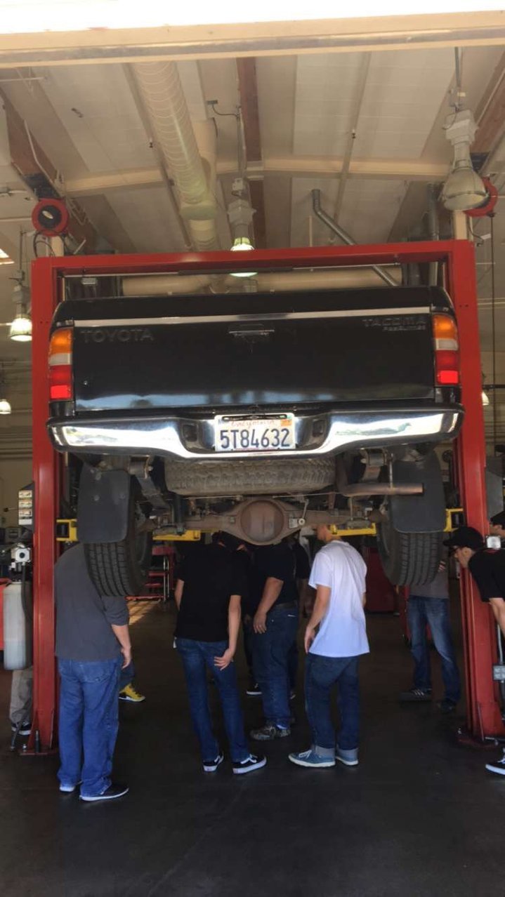

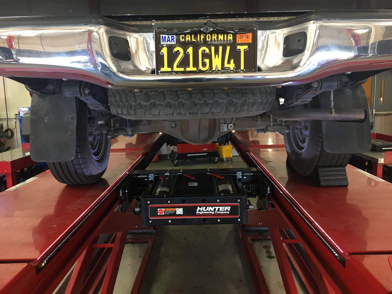

    In case I haven't posted these yet, here are some pictures from the shop. Hunter Engineering, a tire balancing and alignment rack manufacturer, uses it as their training facility so all the equipment was the newest in the industry at the time.
    I did an alignment, changed the rear differential oil, flushed and recharged the air conditioning system, and tested all the fluids. One thing I wish I did was run it on a Dyno, they had one there. My professor didn't know how to use it unfortunately.

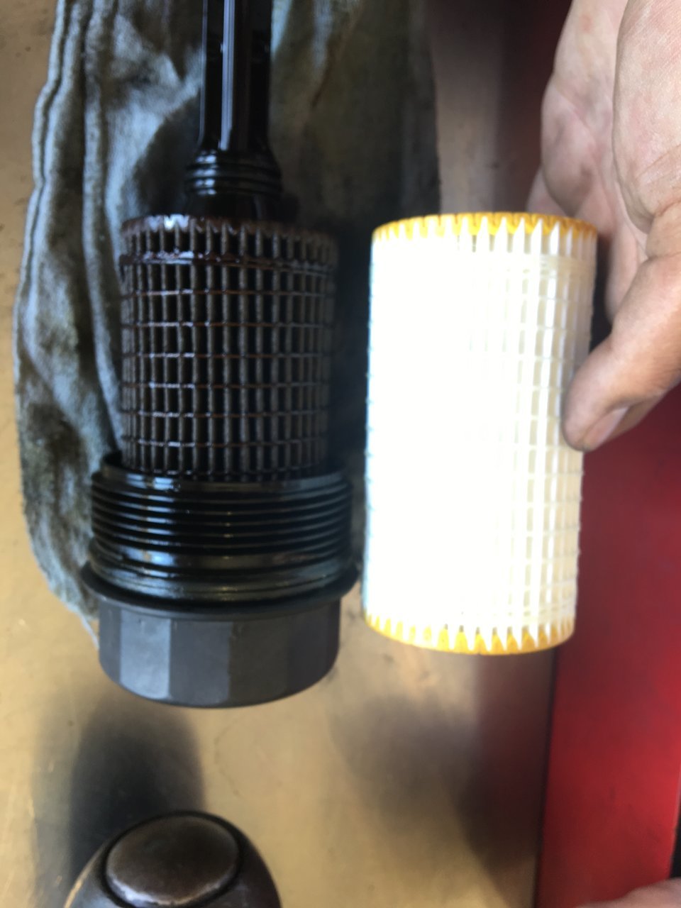

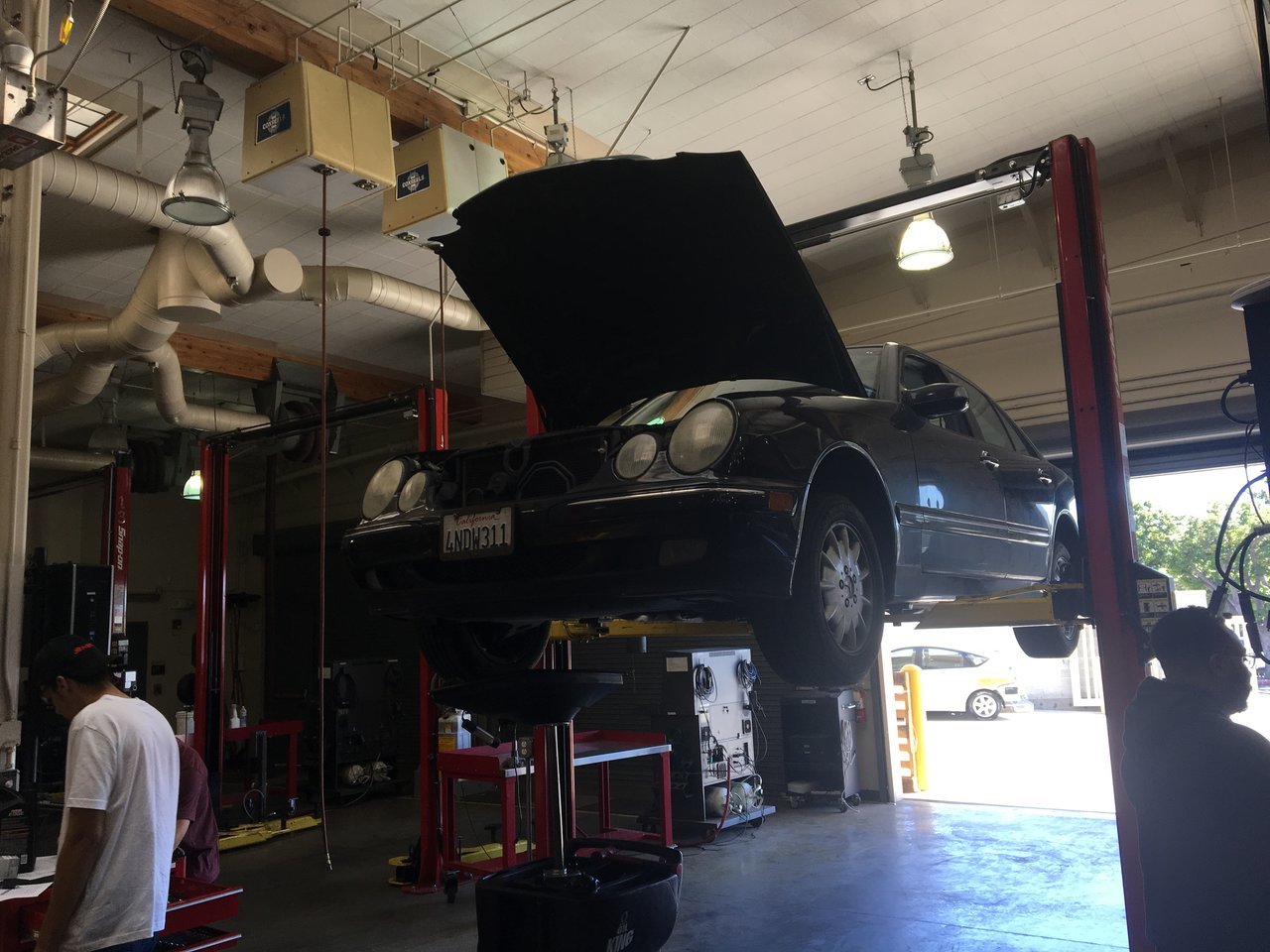

    Here's my E320 getting an oil change. One thing I love about that car is how easy it is to change the oil filter compared to the Tacoma. At least the Germans got one thing right. You just unscrew it from the top of the engine block.
