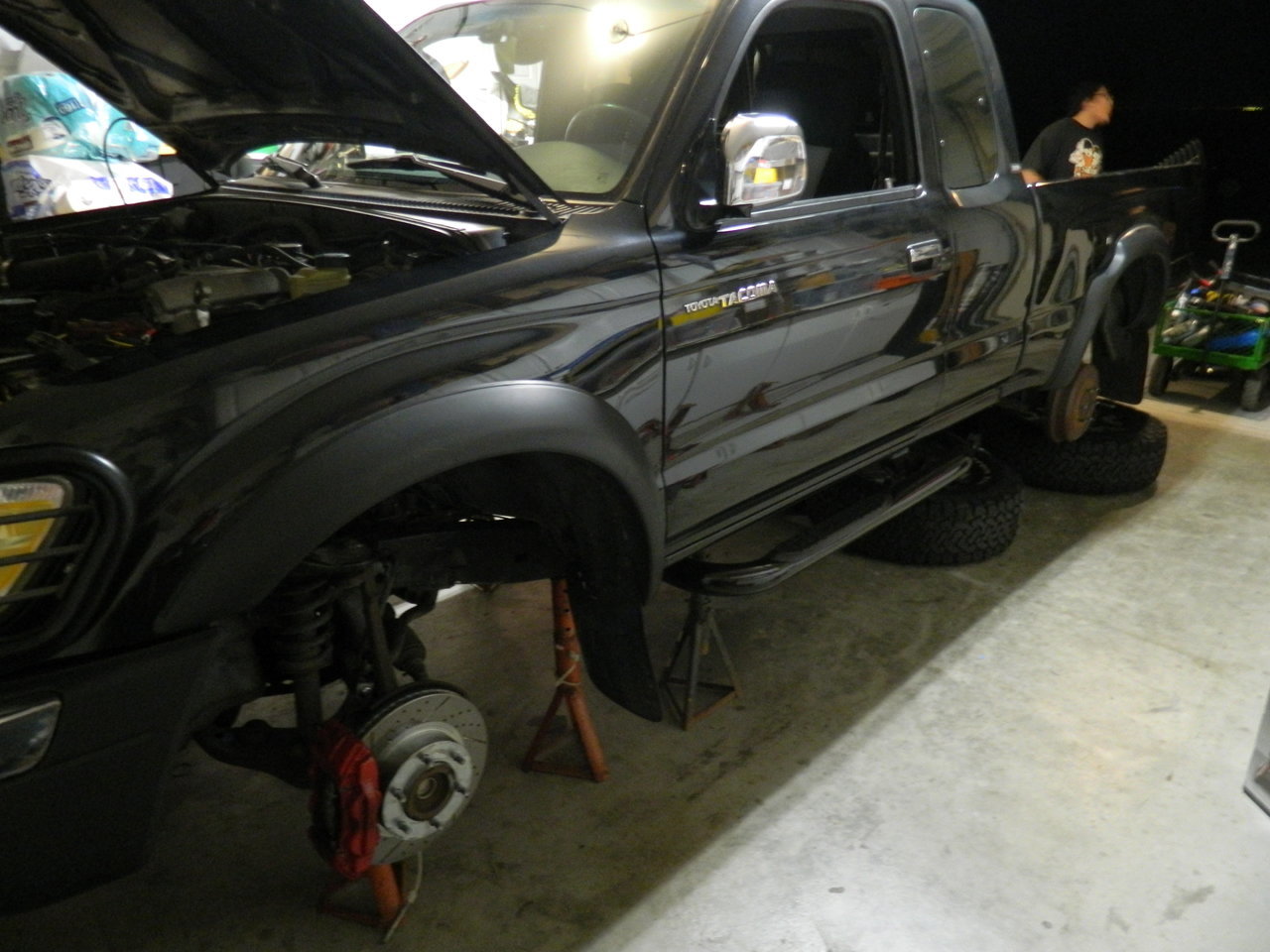

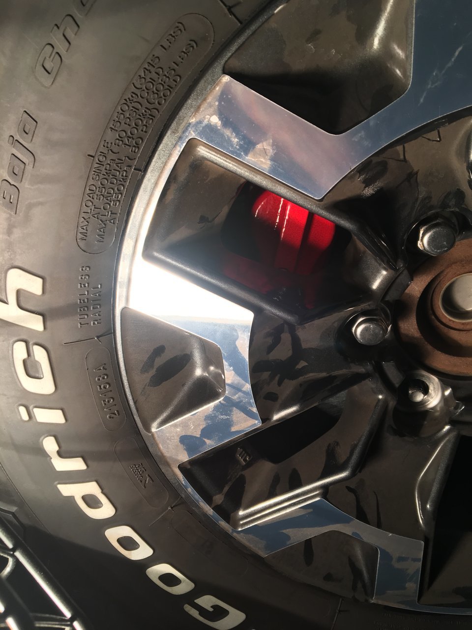

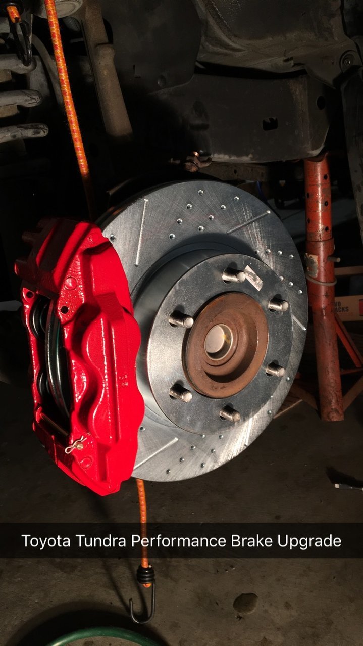

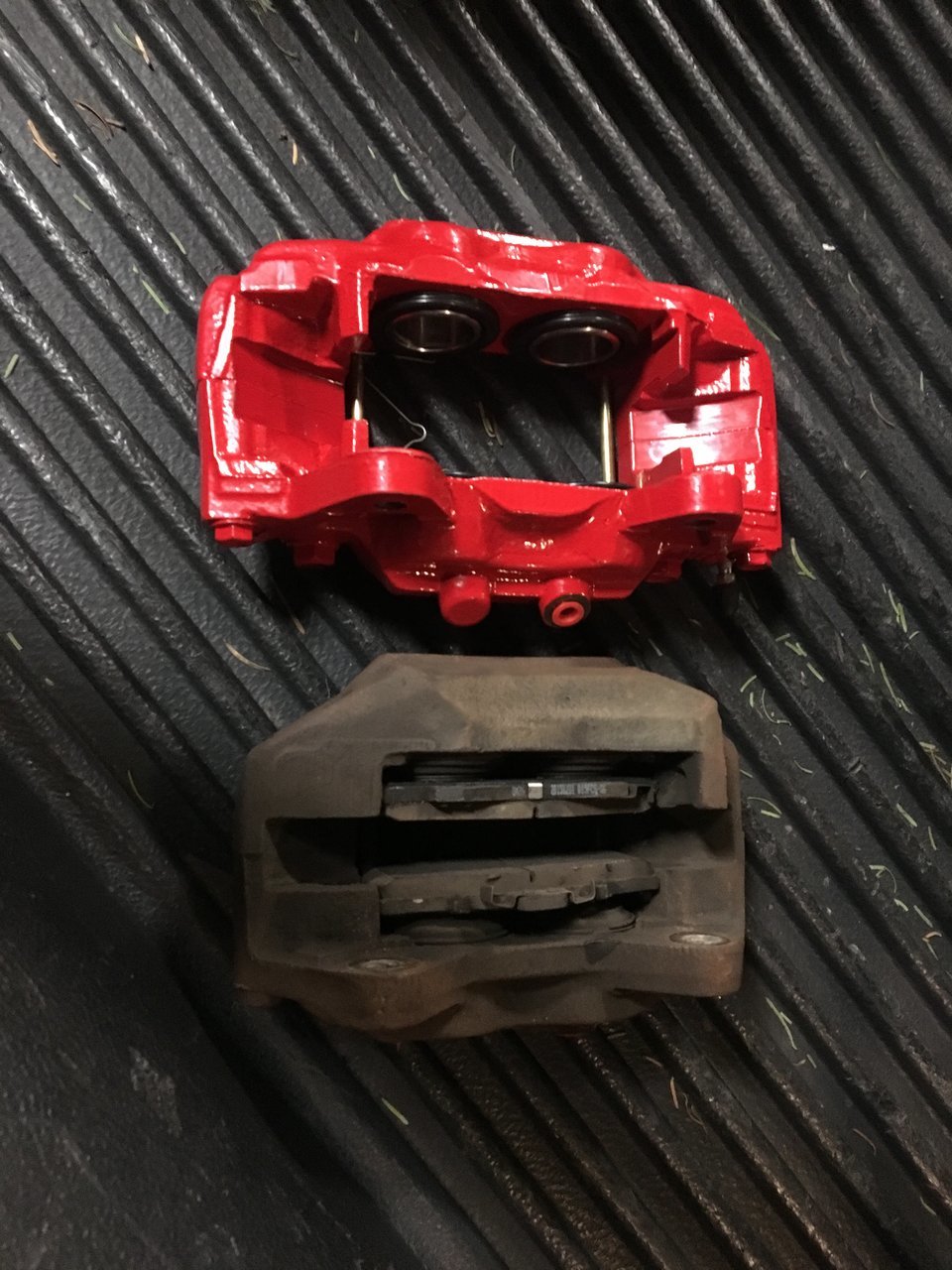

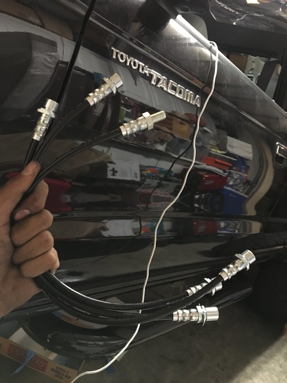

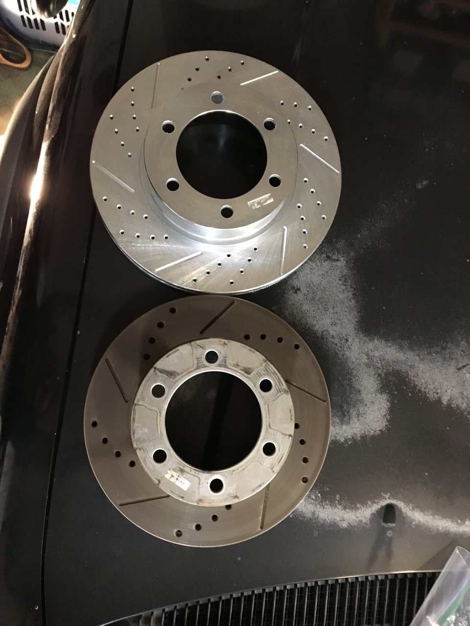

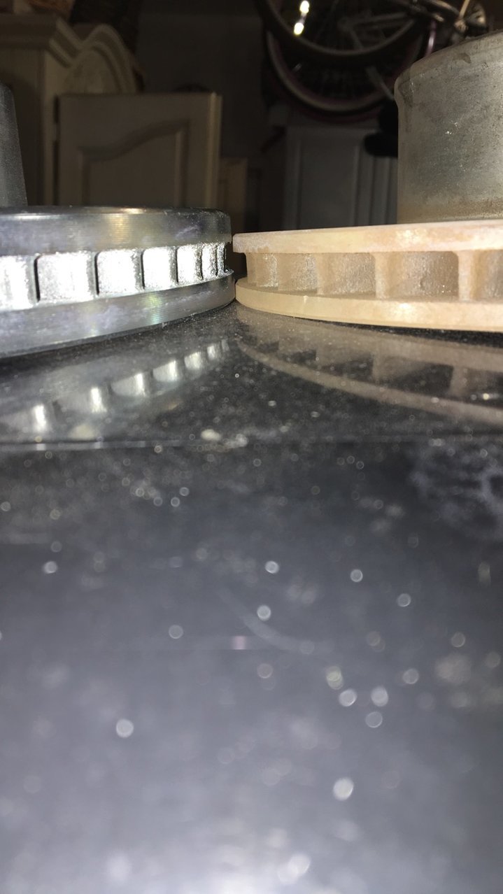

    Did my Tundra big brake upgrade last weekend!
    • Rebuilt 13WL Red Powder Coated Calipers
    • Baer Drilled and Slotted Performance Rotors
    • LC Engineering Stainless Steel Brake Lines & Hardware
    Love the braking performance compared to stock, I really can't complain. The Tundra hardware is so much more robust compared to Tacoma hardware.

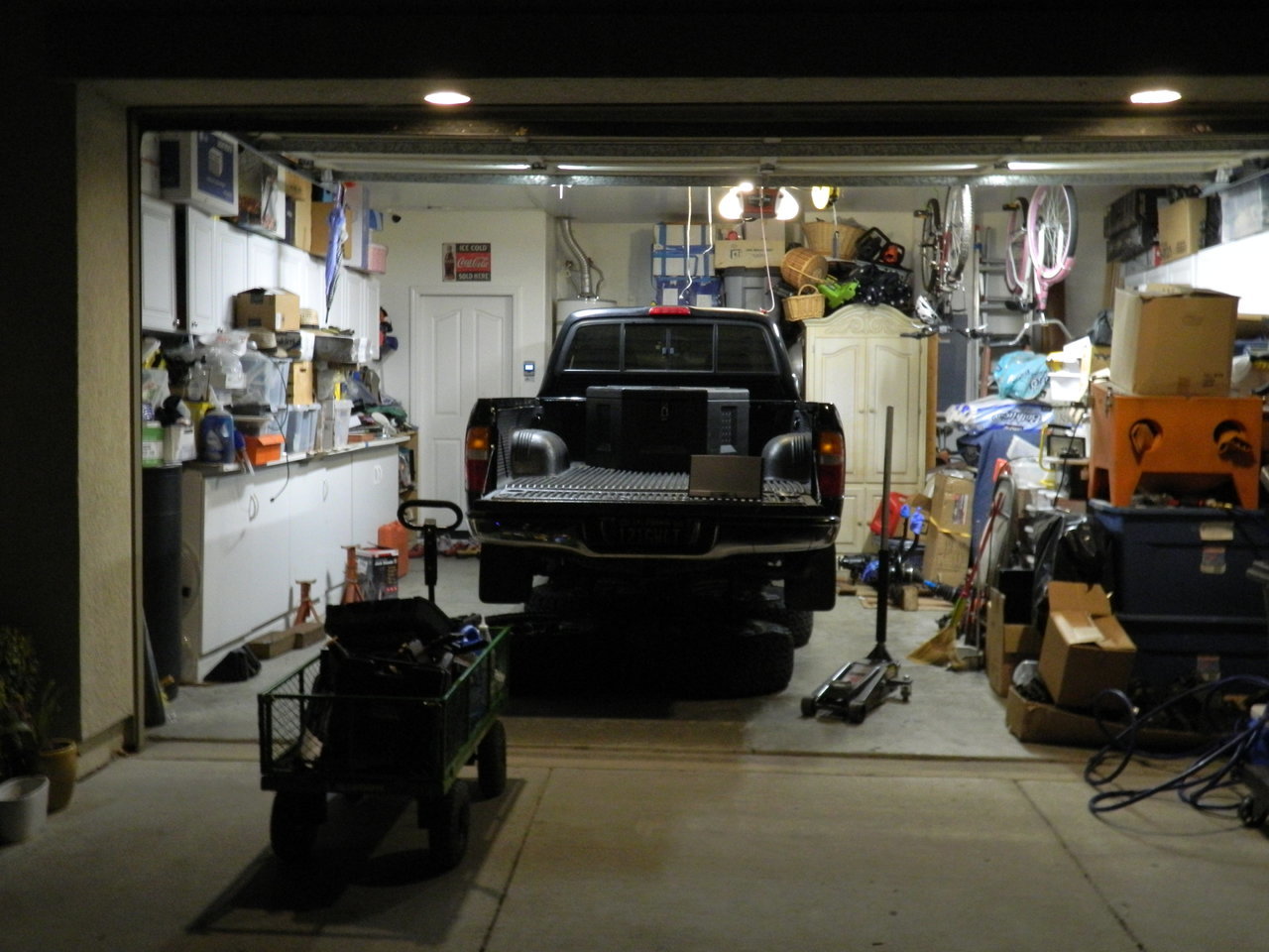

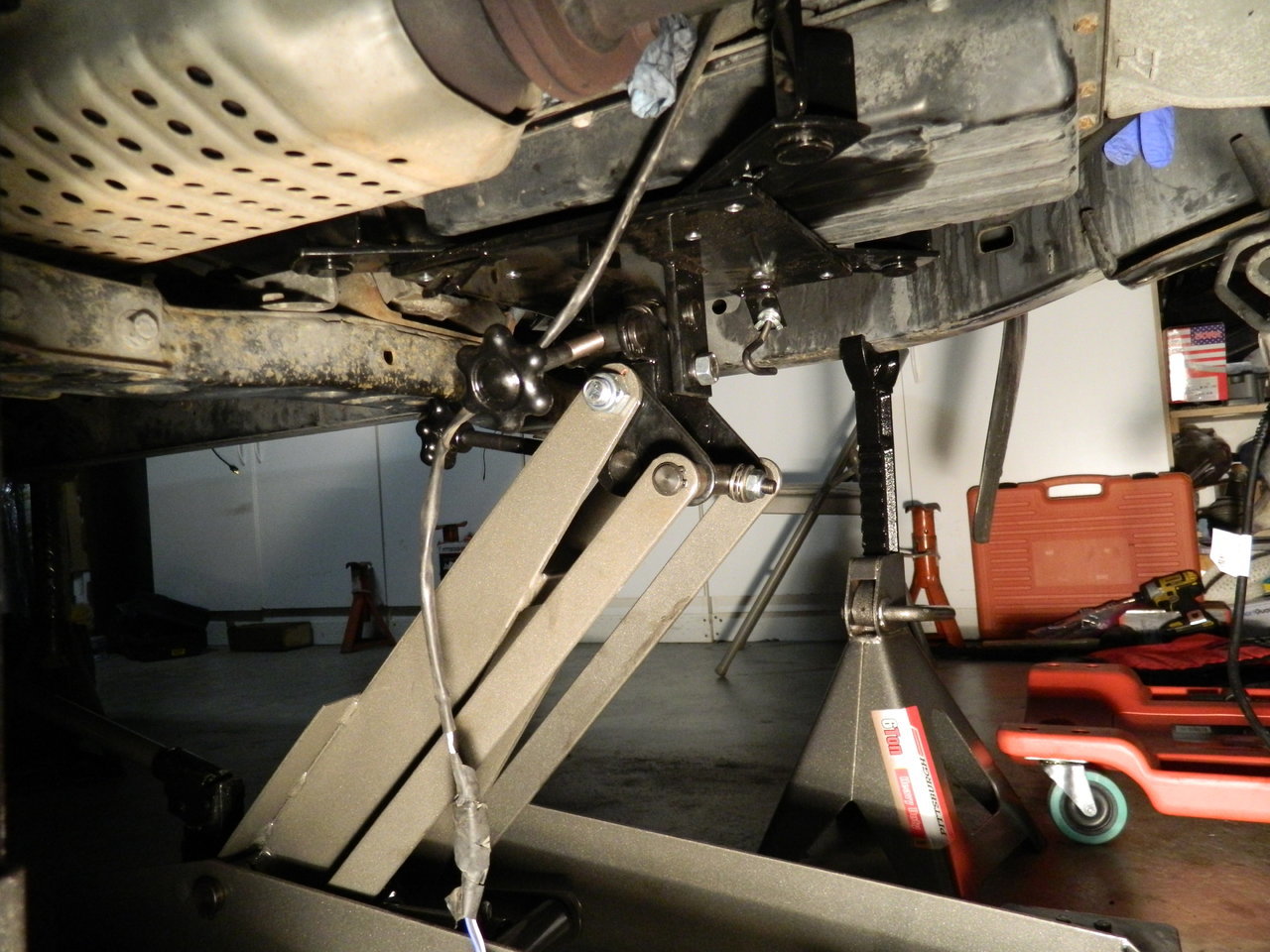

    How can I neglect my own build thread... I'm in the middle off the 4WD swap right now. I have everything on the A340E besides the bellhousing bolts and it's ready to drop out.

    What's your plan for getting the bellhousing bolts out?
  17. Dec 29, 2017 at 10:03 PM
    #97
    BartMaster1234
    BartMaster1234 [OP] American Auto Horns
    Aug 21, 2016
    #195197
    45,641
    Tyler
    San Francisco, California
    Flux Capacitor
    A fuckton of extensions and my impact gun. @Speedytech7 suggested removing the crossmember and slanting the transmission down, which as he said did give me much easier access to the bolts.

    That works. I suggest getting one long extension so you have less play and more accuracy for torquing the bolts on installing the new trans. If you are actually attempting to torque them to spec that is.
