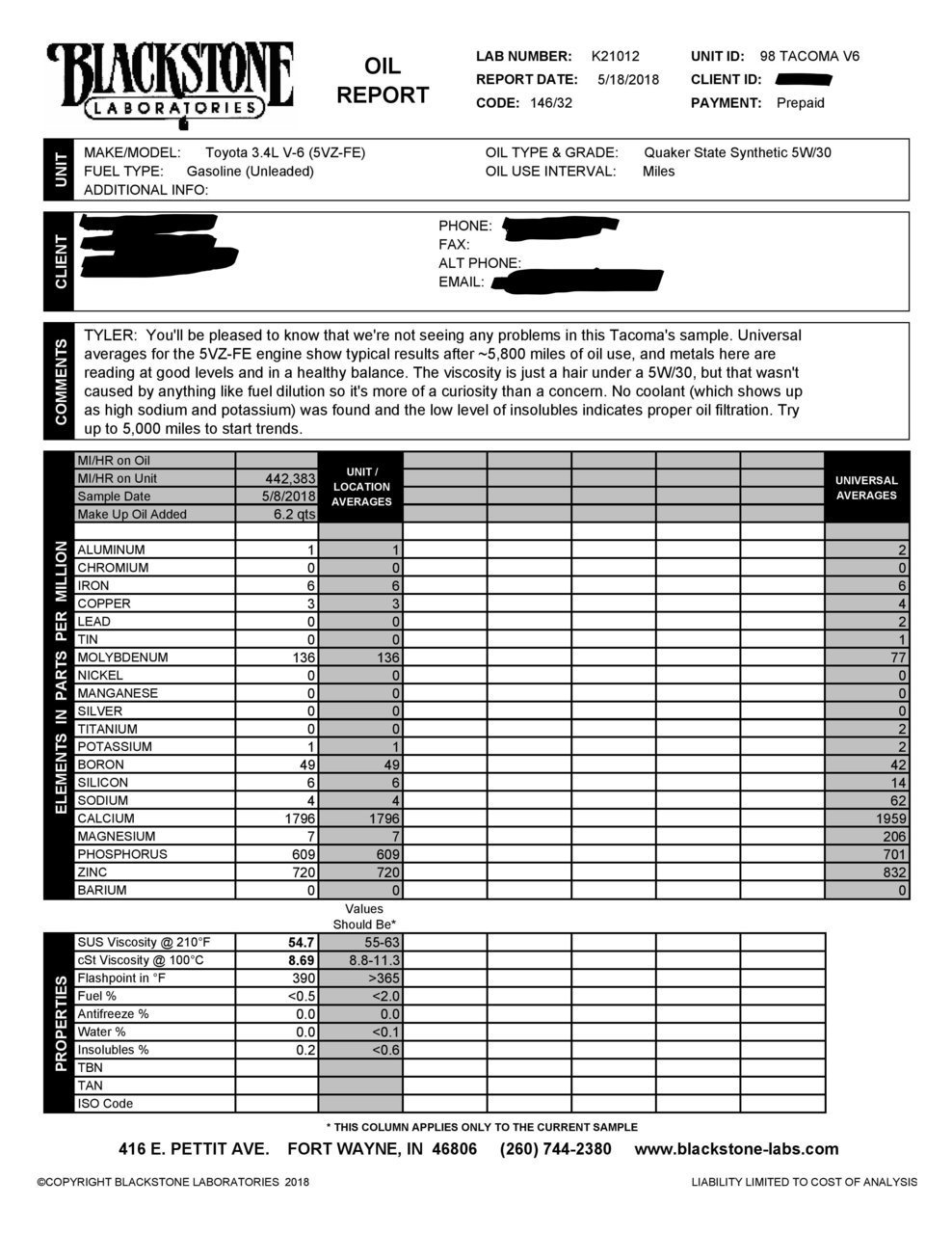

    When I changed the oil, I collected a sample to send into Blackstone Labs to take a closer look at the health of the engine. According to to Blackstone, there is nothing wrong at all and the engine is in great shape.
    Here's what the oil analysis looks like on a 3.4l v6 5VZ-FE looks like after 442,383 miles.
