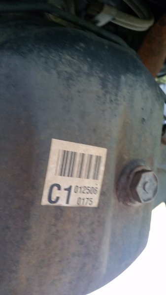

    I was changing out my u-joints and I noticed both rear tires spin in the same direction when you turn one or the other. How can I tell if I have a mechanical LSD? I looked at the original window sticker and I don't see it listed there. There is no LSD oil sticker on the pumpkin. It will get sideways on wet pavement though. This is the only marking I could find on the diff. Any ideas?20170524_173806.jpg

    its possible, but its also possible that the easiest path of rotation was to spin the whole diff rather than the spider gears and tire the opposite direction.
    Whats resistance like when the truck is in park and both rear tires off the ground when spinning one tire to make the other tire go in the opposite direction? (make sure you secure your vehicle when doing so).
    If there is little to no resistance you dont have an LSD, if theres a pretty good resistance (spec is like 100-150 ftlbs of force), then you have one.

    Could well be that they changed it to a LSD. Good for you in that case. If you can, just ask them. Short of pulling the pumpkin do what the other guy above recommended to know for sure. If you do have the TRD Sport you should know it has clutches inside that require LSD additive to the gear oil to operate without chatter. In that case drain your diff to be on the safe side and refill it properly. It's a 10 minute job really no big deal

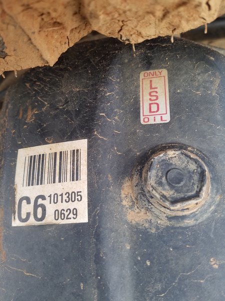

  19. May 25, 2017 at 9:24 AM
    #19
    js312
    js312 Well-Known Member
    Apr 20, 2014
    #128076
    5,657
    Joe
    New England
    23 F150 PowerBoost Lariat 502a
    Husky Weatherbeaters, OEM Mud Guards, Wheel Well Liners, Bullet Spray-In Bed Liner, Gator Soft Tri-Fold Cover, Hankook DynaPro AT2 (Summer), Blizzak DM-V2 (Winter)
    Neither do I. That's the odd thing--seemed to be V6 only. Maybe it was swapped at some point.
    Though it's also odd that you wouldn't have the LSD Oil sticker if it does indeed have one.

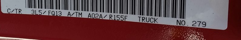

  20. May 25, 2017 at 12:04 PM
    #20
    Caltech90
    Caltech90 [OP] Well-Known Member
    Nov 18, 2016
    #202733
    264
    '19 TRD OR T4R
    Looks like my door code is A02A. If Im looking in the right spot. No LSD, but I'm going to test it like @nd4spdbh said.20170525_144729-1.jpg
