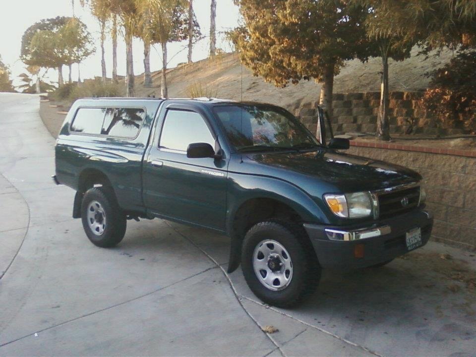

    My old 1st gen regular cab taco didn’t have intermittent wipers either. It also didn’t have a tachometer or a fuel light! I didn’t care, I loved my little taco verde.

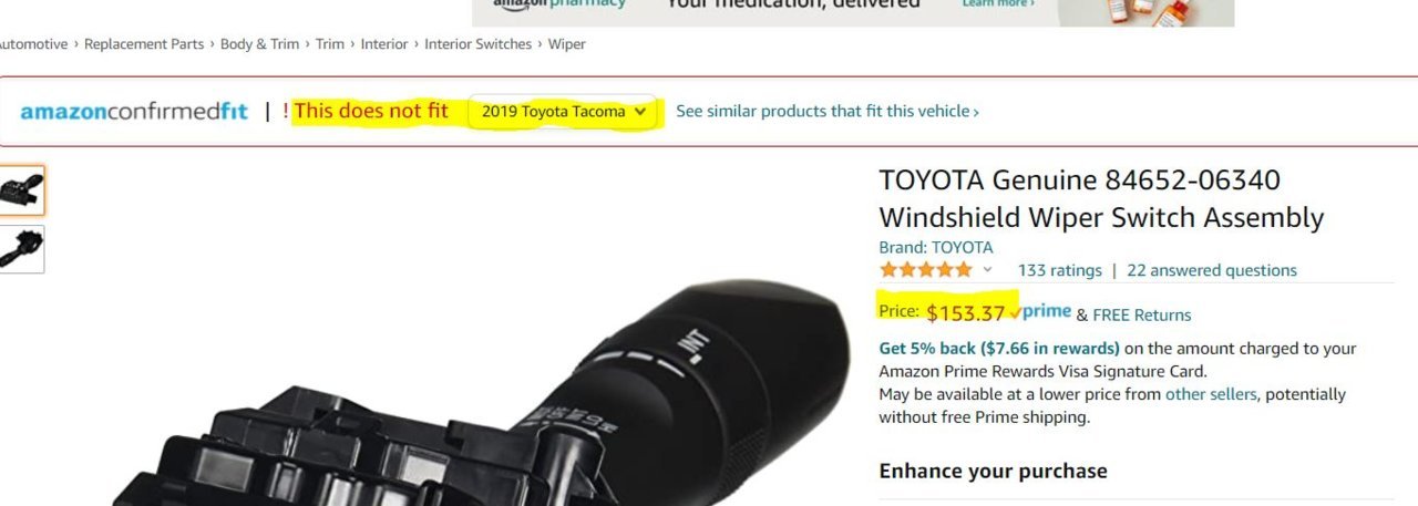

    This is something I definitely want to do, but I have a question...
    I have a 2019. If I click on the part number link, it states that is NOT compatible with my truck. Has anyone done this on a truck that is 2019 or later? I don't want to spend the $150+ to find it doesn't work and be stuck with it.

    I sure wouldn’t pay that much for it. I got mine from McGeorge Toyota Parts online, that is the correct part number for my 2019 SR utility package works fine.

    I ended up going through an online salvage to get mine for about $70.00. I tried to find the links but I must have deleted the emails.
    Use the part number from here
    https://www.tacomaworld.com/threads/2016-2018-3rd-gen-intermittent-wiper-mod.397942/
    I think the one I got came off either a camry or a prius, but it was the same part number

    its used on alot of toyota vehicles. Search ebay for them mine came off a Rav4
    https://www.ebay.com/itm/334077009248

    Wanted to post an update. I took the plunge and bought the suggested part. Fit right in and works as advertised! More bad info from Amazon...

    To be fair, Toyota has told many people that swapping the stalk won't work because a regular wiper vehicle is missing some wiring for the intermittent. So depending on where Amazon got that info from, might not be on their shoulders per se
