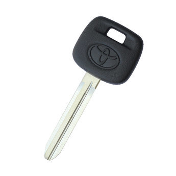

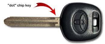

    If you have a 2.7l 4 cylinder truck you almost certainly have no immobilizer and can get any plain key cut for it, if you have the 4.0l V6 you almost certainly do have an immobilizer and will need to get a chipped key cut and programmed to the truck.
    Chipped keys have a slightly larger head and a ● or G (depending on year model) stamped into the blade of the key just below the head of the key, non chipped keys have nothing stamped into the blade and have a smaller more square head.
    Dot key

    Standard (non immobilizer) key
