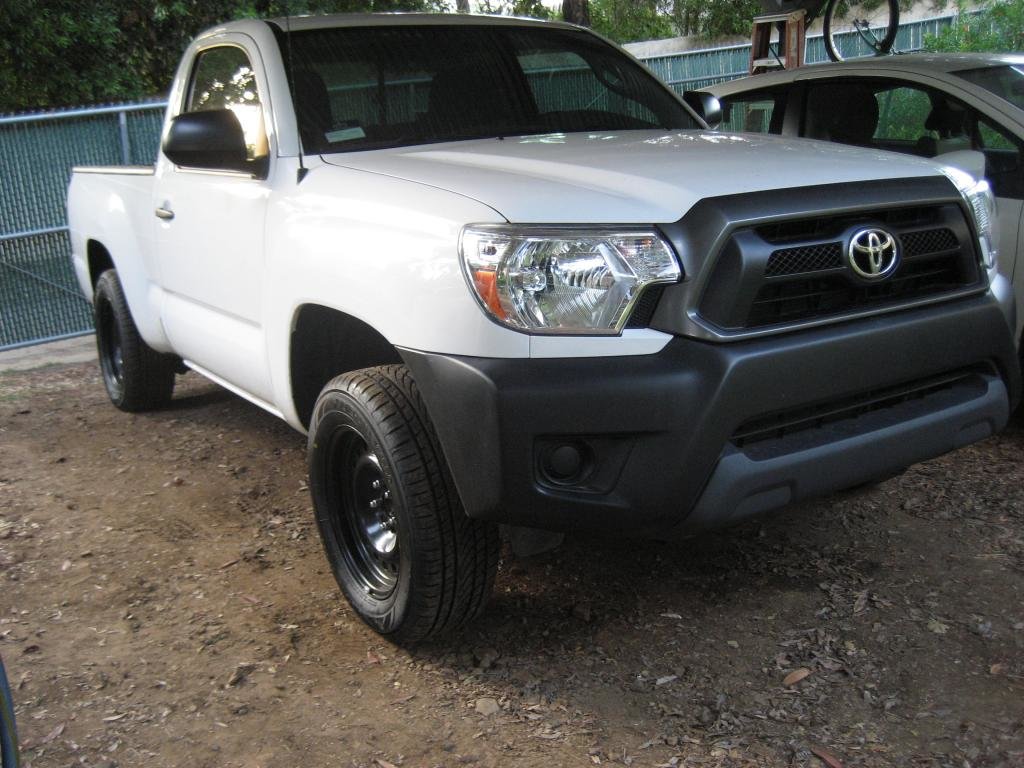

    I can vouch for your good advice. My 2012 5 lug 2.7 came with 16 inch steel Tundra wheels and 245/R75/16 tires. The truck was a total slug with those big heavy offroad truck tires that were 12% larger in diameter than the stock 215/r75/15 wheels. They put the gearing so high that my speedometer would read only 54mph when I was actually going 60mph.
    To correct this condition I had some 235/60/R16 Yokohama high gas mileage passenger car road tires installed today which are just slightly larger than the stock diameter.
    ...and the difference is night and day. :)
