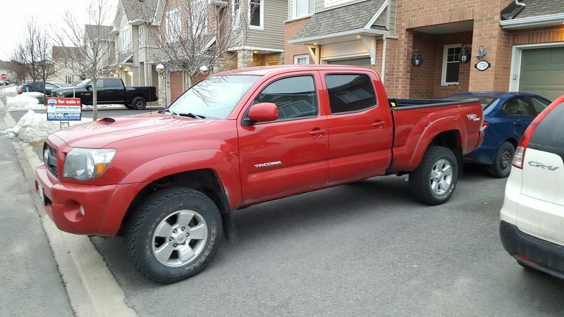

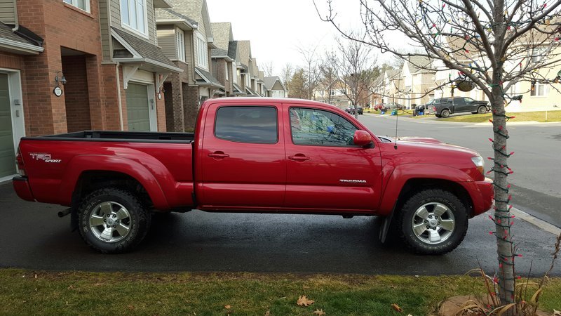

    Hey everyone I finally got my lift on the truck and its awesome. Here a20151210_134243_resized.jpg 20160322_184940_resized.jpg re a few pictures of before and after

    2017 Inferno TRD OR DCSB 4WD
    Is it a level kit? I did the whole 3" in the front 1" in the rear leveling kit it came out looking pretty sweet.
