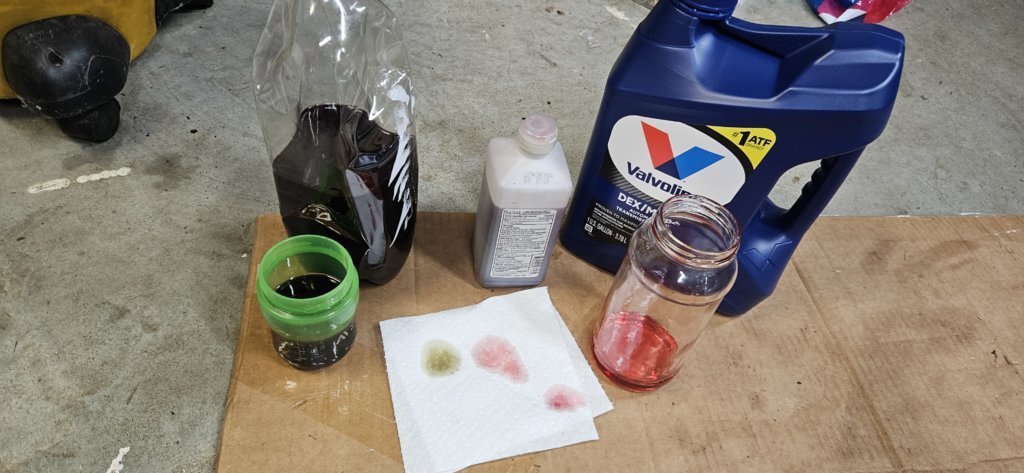

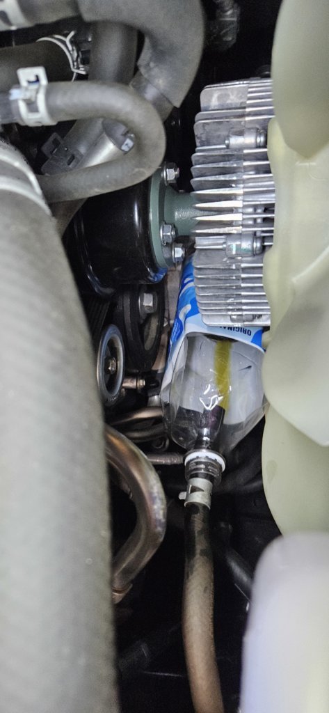

    When I did my ps fluid, I flushed by popping off the return and dumping that into a clear bottle. The suck/refill works too but is slower and works by dilution. If you don't want to run your truck while doing it, just jack up the front so you can turn the wheel. Full lock back to center is almost the entire reservoir just to give you an idea of how often to exchange/refill. I used Valvoline DexMerc (blue bottle).
    If you don't know the history or question the quality and will be doing your own, just replace them all in the next couple months. Depending if things are rusty, diffs are very quick as would the TC be. Transmission and coolant are pretty quick too.
