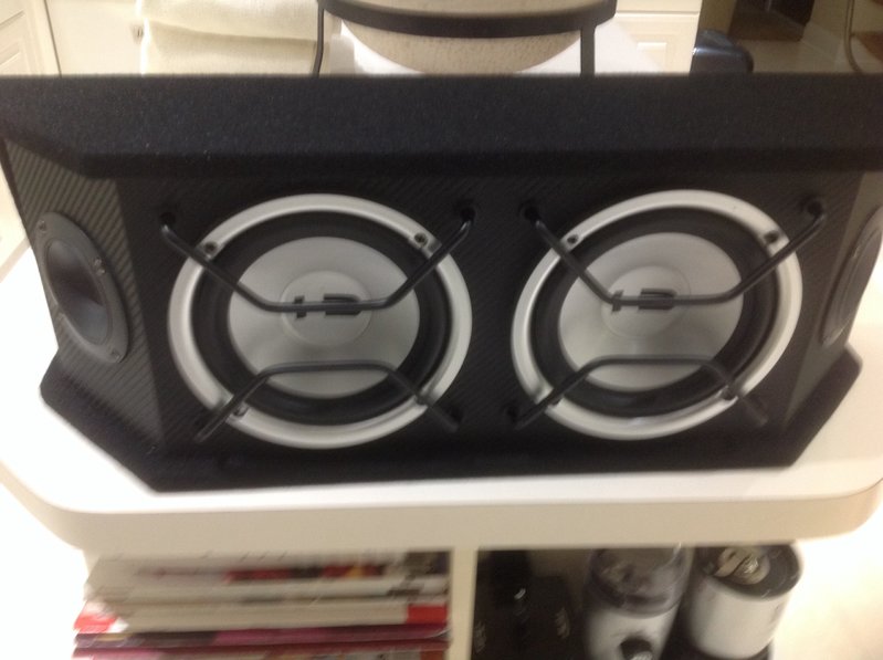

    image.jpg New owner of a 2015 Taco access cab, it's bare bones and I use it for work. The rear has no speakers and I need to know how to install the wires to the stereo,do I need harnesses or what it's basic stuff just really don't want to rip the whole thing out. Any help would be greatly appreciated

    2. If you are on a tight budget, the first thing is to find the electrical wiring diagram receiver and find out if there's a rear speaker output for you. If there is, then you are in luck....most likely it'll be 22W or less RMS of power. From the picture, it seems you have a subwoofer of some kind and some kind of passive radiator in that sub box you have.
    I'm not sure what you are asking for is what you really want? Is it bass you want so you want to make it louder more volume of sound like dance/hip hop/rock or more folk/country where you sounds from the front and back? The reason is that if you want the subwoofer...then really the stock radio isn't going to provide enough power to move the speakers to produce enough bass for you... So if you want a subwoofer, then you will need a high low adapter for the rear channel output of your receiver if it has it...if it has RCA than you can just connect that to the amp. If your subwoofer box has a built in amp...just run the RCA cables to the amp.

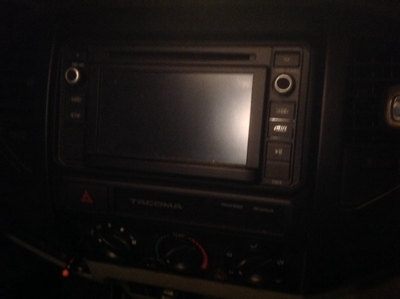

    image.jpg Ok the first pic is of the rear speaker this is the radio,one end of wire goes to the rear speakers,on the radio end is there a harness clip there that I can get to or do I have to remove the stereo, I'm quite capable of reading a schematic just trying to use this service to save some time and energy just an easy install or it's not really worth it to me

    I think I get what your after. I would remove the head unit, not hard. Then tap into the rear overhead speaker wires, run your wires under the door sill and fish em to your speaker as invisible as possible. Hopefully helpful.

    If you are capable of reading a schematic, you wouldn't be asking these extremely basic questions and wanting to be spoon feed information. I'm being blunt, but respectful... just from reading your questions it shows you really do NOT want to learn. Simple search such as radio installation and such can show you want is required:
    https://www.tacomaworld.com/threads/mod-day-4-installing-2014-oem-radio-into-2013-pictures.310362/
    Ramon was kind enough to do a write up. Read the link it'll give you a guideline about the receiver removal.
    Once you get the receiver out you can see what model is your radio and then go online and search for the speaker wire output. If stock receiver has rear speakers or not...if it does, then make a harness or buy one and connect them to your to your $15 speaker. If you want to run them above or below carpet it's up to you...just make sure both speakers match their connection polarity. If the speakers are out of phase...it'll sound like crap.

    i think the harness connector for the rear speakers is behind the LF a pillar
    no need to remove radio, wire colors for '14 were light purples IIRC

    np man. again, i think the connector for the rear speakers is behind the drivers A pillar. should save you some work
