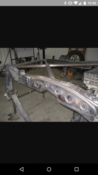

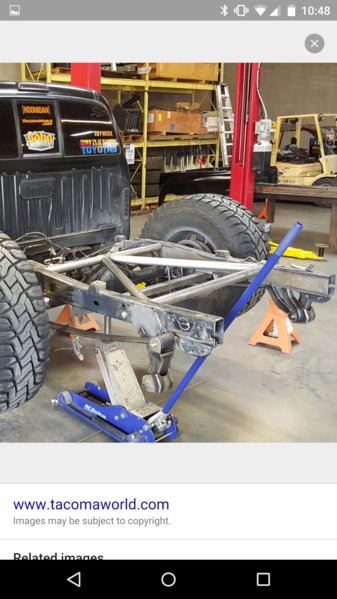

    Same here, 3/16 plate and DOM crossmember is the ideal setup.
    I'll let you know if we can successfully get a CAD file created after a template is made this weekend.
