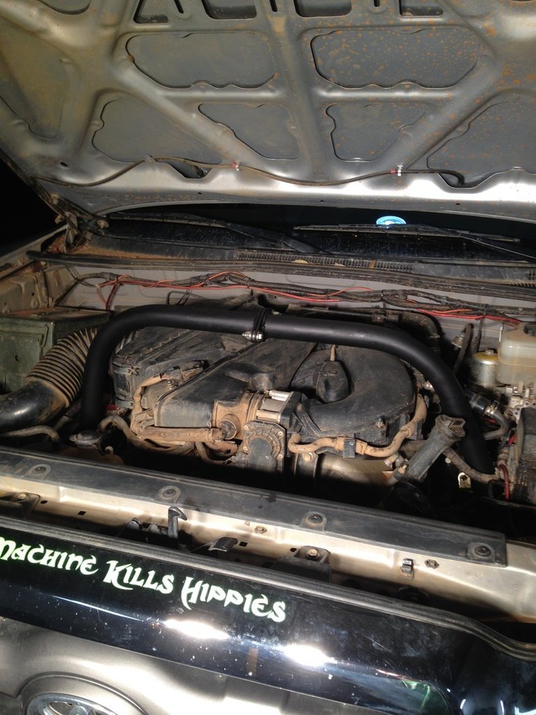

    little update. since im still waitin for parts n springs to show up, ive had some time to revise my crossbrace( the other one flexed and rubbed my airfilter box) soo, I made this one and it is SOLID 1.75 DOM, made the delrin bushings for it too.

    yea helps keep the motor mounts intact, an the shock towers from bending which is a common problem on long travel stuff

    Not sure what you mean by solid DOM.

    That's poor grammar and wording on my part, it's solid, 1.75" DOM ( drawn over mandrel) tubing aka rollcage material

    Super clean setup!
