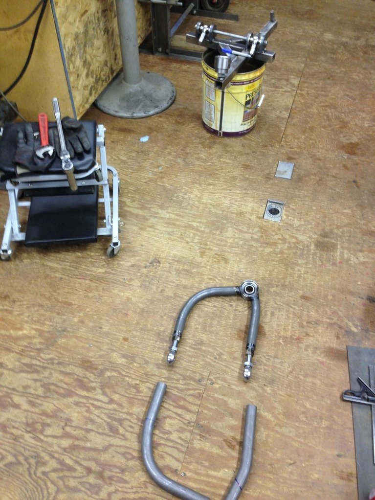

    got off my ass and started making myself hiemed uppers....

    you are building your own UCAs? damn!

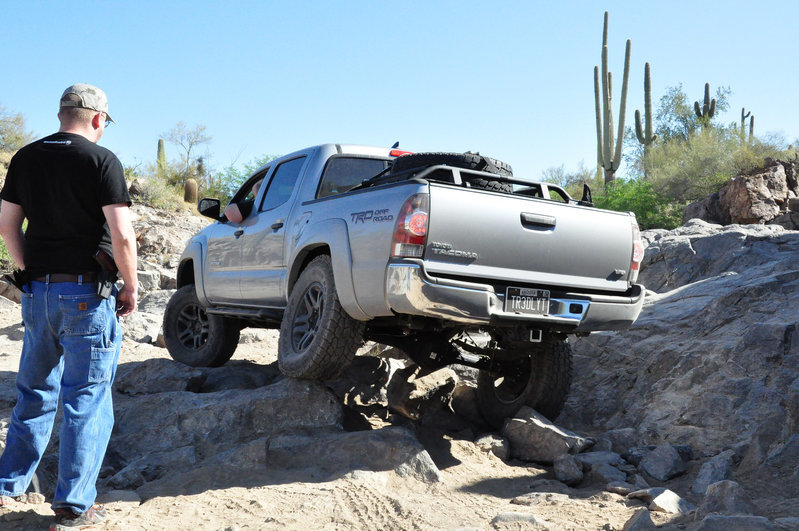

    Trav, how bout some action vids of this new rear setup? Have you even had a break from work to really put the hammer down and run it?
    BTW, Iove your old setup man. The valving I went with is awesome on washboard. The truck perfoms so much better than expected. Even with my 34s I still polish the shock body at full stuff with the tire pressures down. I think im going to either build some shackles or try to use the OEM ones to lower the stinkbug until I get more weight in the back.
    Heres some sexy flexy from last weekend

    Yea I already built the LT lowers, uppers are easy!
