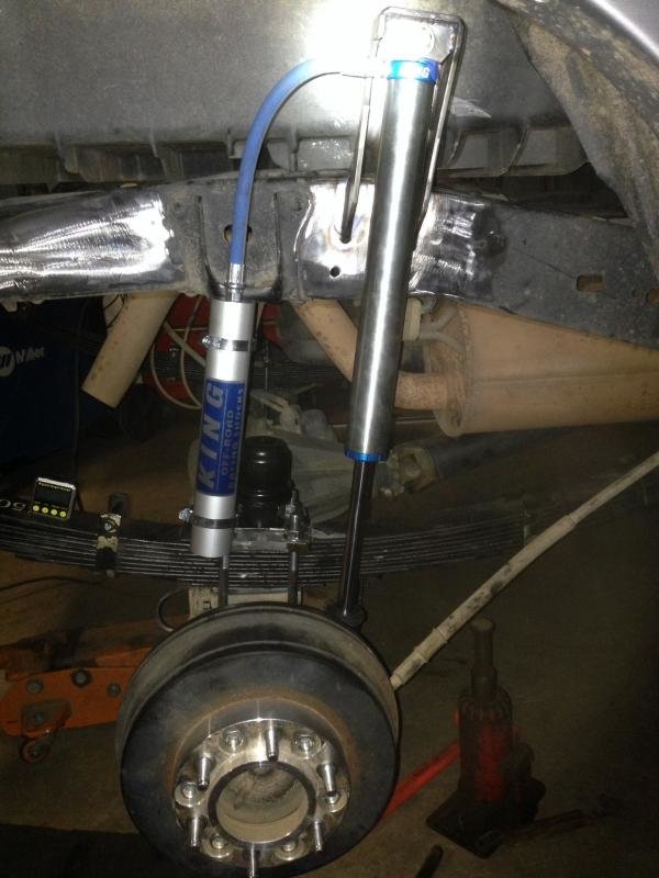

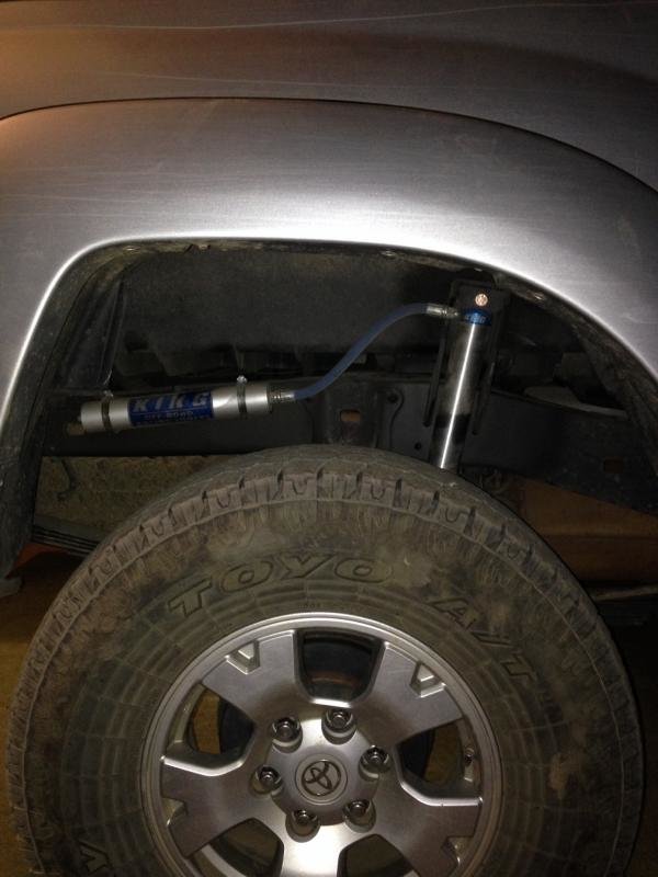

    It's in the first post, but they're all pro standard 3" , made progress with the rear, got the towers all finished welding( tig takes a while to do FYI) and got my bumps welded on the ubolt plates, one side installed, just needs paint, then drivers side and time to test drive it
    I kno the shock looks not parallel with the tower but rest assured it is, 90* to the axle and a 9* forward rake

    Just finished

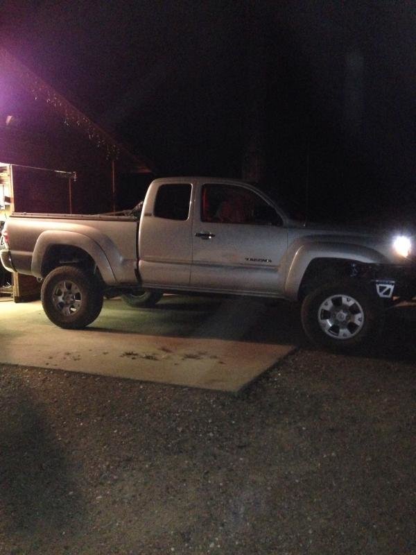

    Cranked up the front sum, rear needs to settle some, tested it out on sum little spot near my house, yup.....butter

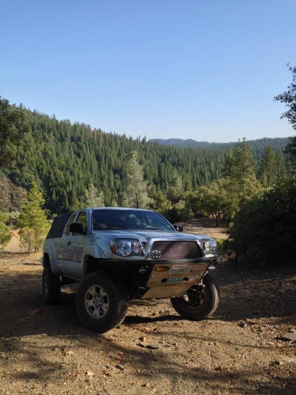

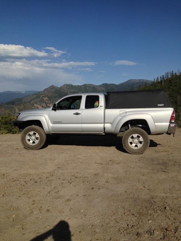

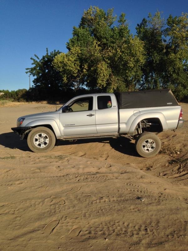

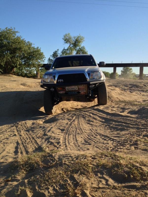

    Pictures updated... Boredom, so I drove around the property and hit a stump
