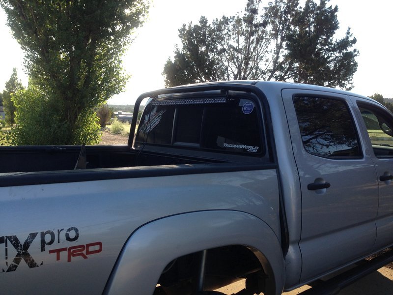

    hey it's better than mine will be. like i posted before I am gonna go with more like the allpro black betty exo cage[​IMG] . I just want to figure out how to add some support along the sides/ doors in the event that the truck ends up going sideways into a tree or something. and I'm a double cab. Hopefully start building it around the new years time. and it won't be ideal, but i can't have my truck down for that long, and it'll keep me and passengers safer in the event of a roll than without it. So far got the rear bar done so I could mount the chase lights my gf got me for my bday. [​IMG]Its a start....lol....

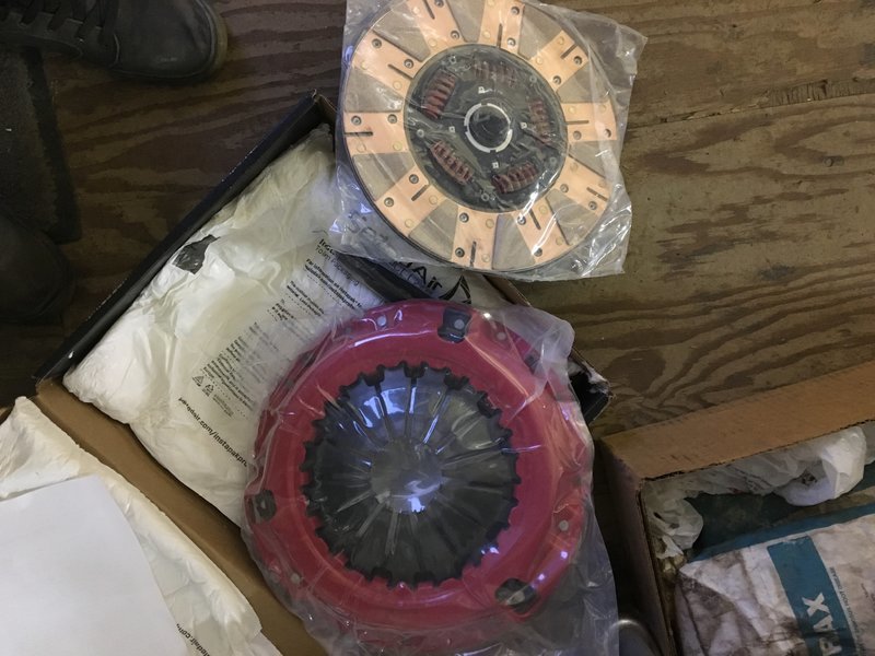

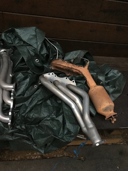

    Sorry dude, been at work.... Got home yesterday, drove my truck maybe 5 miles and the throwout bearing finally decided enough was enough and disintegrated( been squealing for two months now lol), good thing I'm prepared, transmission is out, flywheel gettin resurfaced, urd stage 3 clutch and urd throwout bearing goin in along with some Doug thorley long tube headers :)))

    Why resurface the flywheel and not go with the heavy or light one from URD?

    Well, I can resurface it myself( I just did it) soo it's free lol. And I couldn't make up my mind on which way to go, lighter or heavier, so stock weight is in the middle.... And again FREE lol I'm broke from buying stuff for this gnarly axle build nonsense haha

    Haha yeah free is always good! Just depends if you wanted better acceleration or better offroad lugging I guess. I like the light weigjt flywheel for sure, it definitely feels alot quicker with it, but it stalls pretty easily and takes a bit more finesse offroad, all in all I'd still go with the light weight

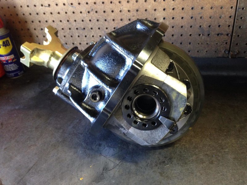

    My buddy just finished my third member for the new axle... Ford 9", 4.88's Yukon grizzly locker, arp ring bolts, solid pinion spacer, polished gear faces, 35 spline axles, billet 1350 yoke.......

    That an automatic locker?

    yep....locks up when u step on the gas!!!!

    yea I almost went with a spool, but since I still street drive the truck, this is it. had a Detroit in my old truck years ago, they work great! they lock up immediately and are pretty dang bulletproof

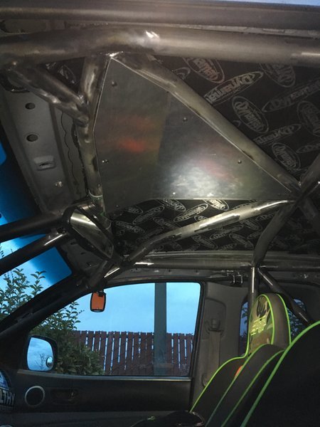

    Started paneling the roof parts so I can put some dome and map lights back in, that compass temp doohicky too
