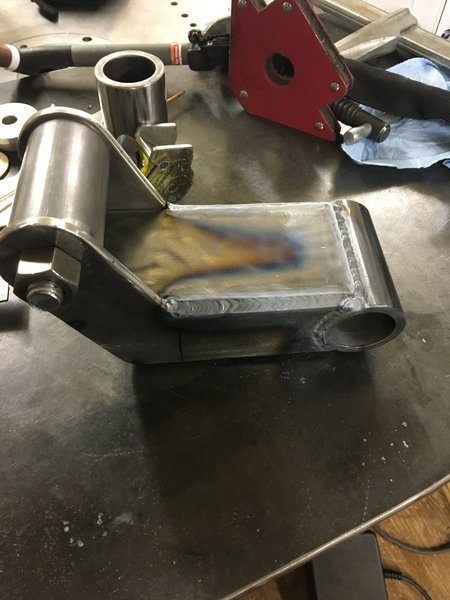

    Building myself some shackles to play with my ride height a lil bit

    Canted forward a bit to arch the spring some more?

    Uhhmmm no.... Think about that for a second.....the shackle pivots how would it add arch?? It's boomeranged to allow for a lil more droop. These are just a little shorter than the DTF ones I have right now

    Oh. It was a question lol, I wasn't talking shit lol. So in this case a shorter shackle will provide lift for SUA?

    Yea if you have a tension shackle type setup(inverted) like the dmz kit for example. DTF kit has pretty long shackles which gives you a bunch of travel and does work freakin awesome, but being that my truck is still 4wd and I use it as such I need a lil more ride height/clearance.

    Agreed. I'm about to call deaver to see if they have an AAL for another inch or two of ride height in the back. Or would I benefit more from a slightly shorter shackle?

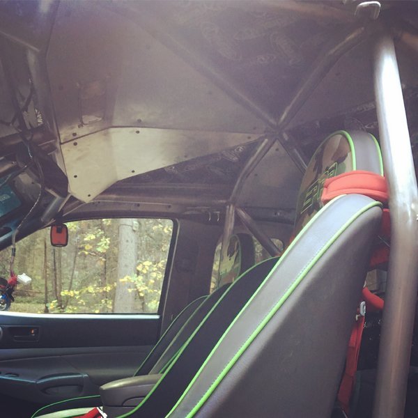

    The headliner struggle progress and rear shelf in the making

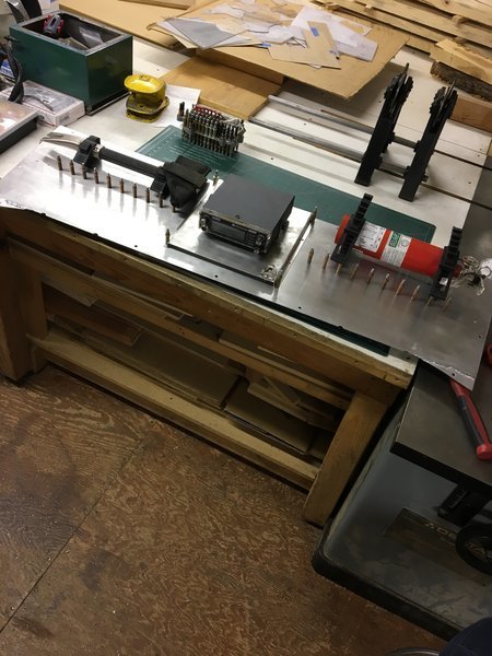

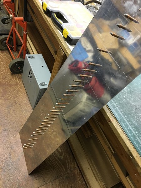

    Made some shelf progress

    I see those little studs all the time, what are they? Are they like markers for the sheet metal or?

    they are called Clecos, they come in a bunch of different sizes and types. they are spring loaded and for putting into a hole in two pieces of sheetmetal when u let them go they draw the two pieces together. we use em in aviation a bunch, where they originated I believe. for every rivet hole you have you put one of these in as a temporary holder to keep your sheet in the right place. take one out blast a rivet go to the next etc etc. in the picture im using em to hold a slmall piece of aluminum channel underneath the shelf as a beam to keep the skin real rigid and not flex, im gunna rivet it in when im done... super handy little tools really

    Ah I see, well that's fancy, I would assume they are reusable? They look a little more complex than just a one time use thing.

    yea theyre reusable....pretty cheap too

    Kewl, maybe I'll get some if I get into some sheet metal work on the truck

    So they hold together two pieces of sheet metal (or other metal) until you weld it?

    Or rivet I believe.
