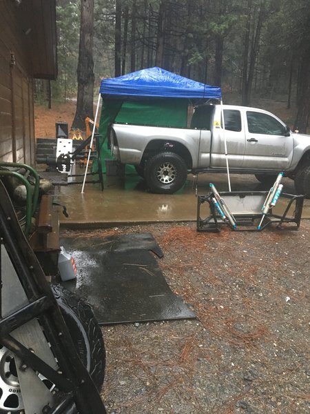

    So this week and next ill be doing the axle swap, abs delete and front diff swap...stay tuned

    One thing I learned from my day job field maintenance on helicopters....I don't give a fuck about the weather when I got shit to do lol.... bed will be off tommorow along with a whole bunch of other stuff

    It's not awesome when it's cold out trying to work on this thing.... I need a garage
