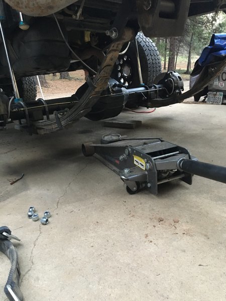

    Got all my tabs and stuff welded on today, even got it painted and almost bolted up for good today, Tommorow I'll have the whole axle assembled and bolted in the truck so I can start on the brake system!

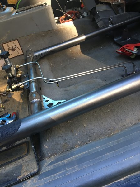

    Brake shit in the cab, line lock and proportioning valve. And down the road s party handle(handbrake)

    What type of 3/16 tubing you use for the brakes and curious what double flare tool you are using. You making this look too easy.

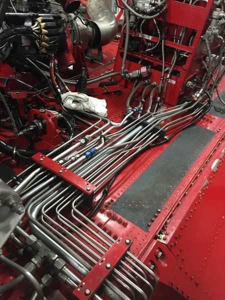

    The key to good flaring is a square cut end and deburred on the inner outer lip, then polished with a blue scotchbrite disc on a lil air diegrinder..... I do it for all our helicopters and some of those lines have 3500 psi thru em and no drippy drippy

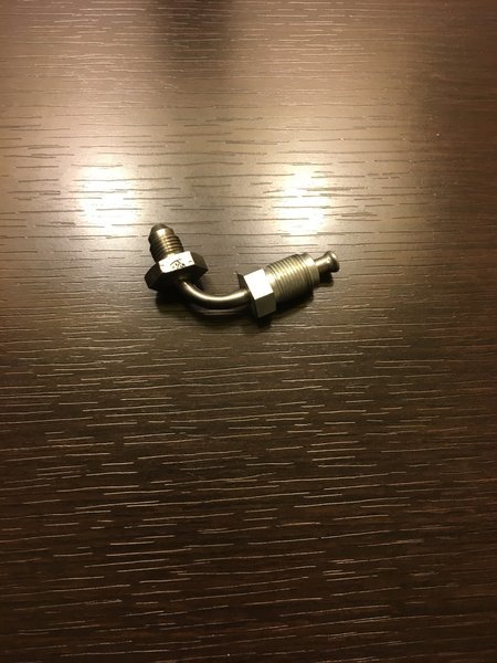

    Well my front calipers still have the factory lines and extended stainless lines I bought long time ago. And since I removed the electric boosted system(trd package shit) and went to the base model vacuum. I did the double flare on one end with the factory nut to adapt to the master then basically cut a AN3 union in half and brazed it on the other tube end lol. I'll take a picture of it for you tommorow

    Thanks I'd like to see a pic of that.

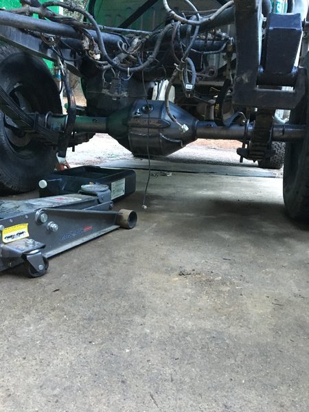

    Probably be breakin in the gears on Christmas lol
