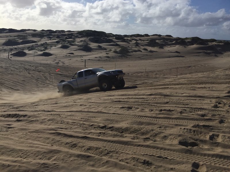

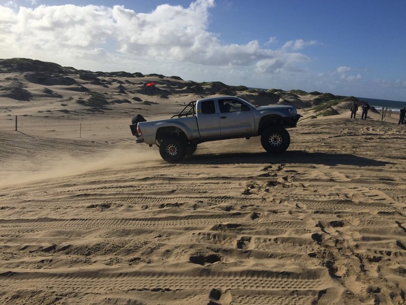

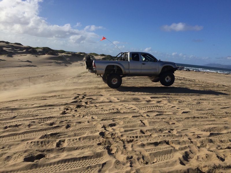

  17. Jan 1, 2017 at 1:28 PM
    #657
    Basikbiker
    Basikbiker [OP] Well-Known Member
    Sep 21, 2013
    #112968
    3,987
    Trav
    09 AccCab 4x4 spaceship
    My doors are the only stock things left besides the headlights
    She hauls the fuckin mail now, didn't try jumping my truck much this time. Just skinny pedalin

    Sick. Congrats man

    35s soon?

    Already got em on bud lol
