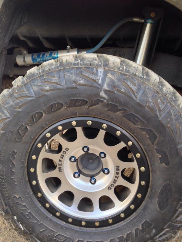

    With stock wheels yes I run 1.25" spacers, at full flex tire is about an inch from touching the shock, so with stocks and spacers it's about a 4"backspace
    With new wheels being 4.5"back space I'm gunna try to get away with no spacers

    got home fro work this afternoon, hauled ass and got my tires on my wheels and balanced then back home, finished chopping the cab mounts back and plating them in, then on these badboys went, hard to tell but the lugs are blue like my shocks:D

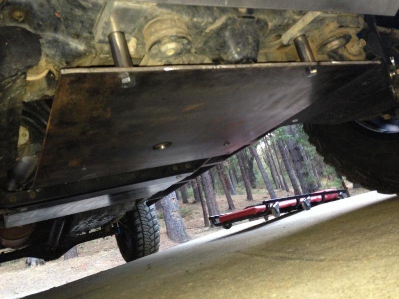

    Front skid in progress, 1"cold roll standoffs, 1/4" plate

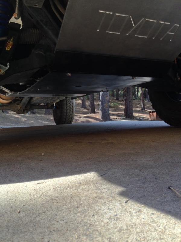

    Got my ifs and transmission skid finished this afternoon
    Stryker420 and THROTTLE231 like this.

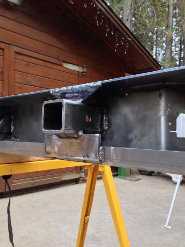

    DIY Relentless bumper showed up at home(still at work down in Lancaster) and sum RuffStuff parts, got sum welding to do when I get home next week. and I gotta fab a spare tire holder( bolts to frame rail, mounted vertical) not a fan of the swingout thing truck is long as it is

    Almost done welding this up.....there's a lot of welding to do, makes for good practice, MIG welded on the inside and TIG welded on the outside

    Hey dude can you take a picture of the back side of your bumper? I'm putting together my DIY relentless too and want to see how you welded the back cross bar to the hitch
  18. Sep 5, 2014 at 6:46 PM
    #78
    Basikbiker
    Basikbiker [OP] Well-Known Member
    Sep 21, 2013
    #112968
    3,987
    Trav
    09 AccCab 4x4 spaceship
    My doors are the only stock things left besides the headlights
    yea sure thing, but ill let ya know mine didn't come with the hitch receiver parts, I added it in, it just had the hole cutout.
