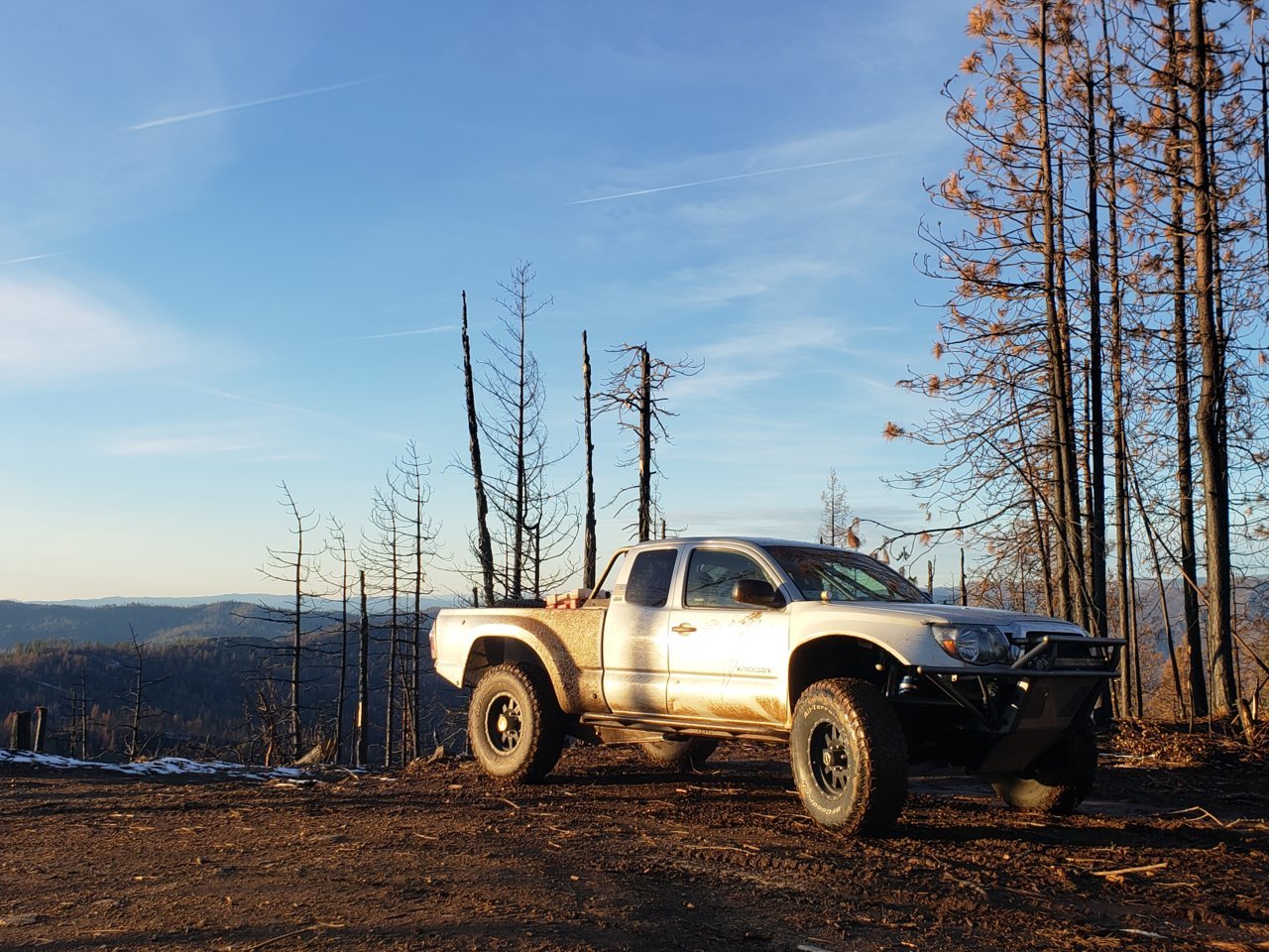

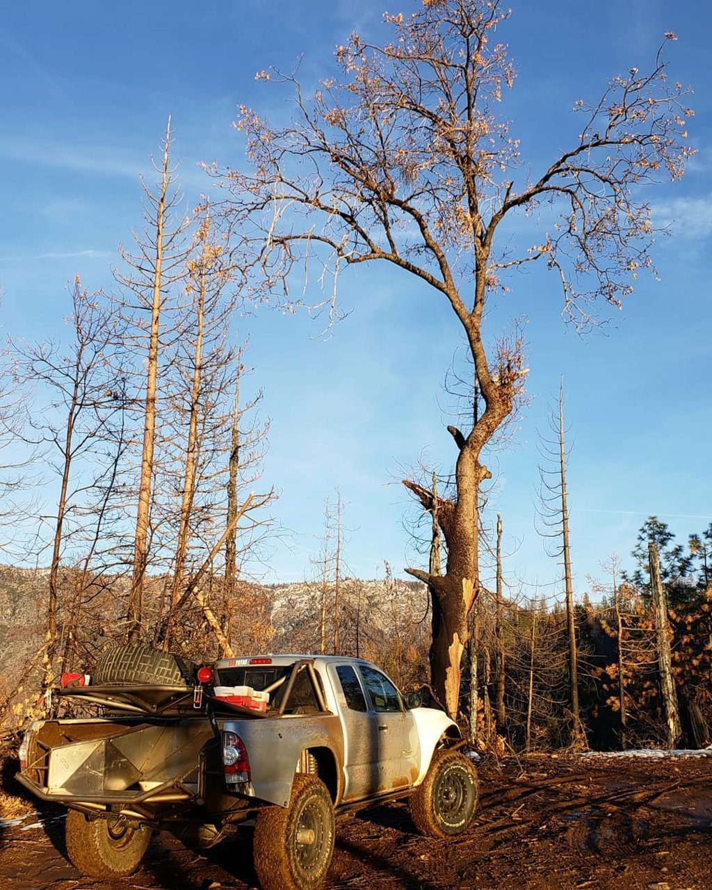

  4. Jan 26, 2019 at 7:45 PM
    #884
    Basikbiker
    Basikbiker [OP] Well-Known Member
    Sep 21, 2013
    #112968
    3,987
    Trav
    09 AccCab 4x4 spaceship
    My doors are the only stock things left besides the headlights
    Got it a lil dirty the other day

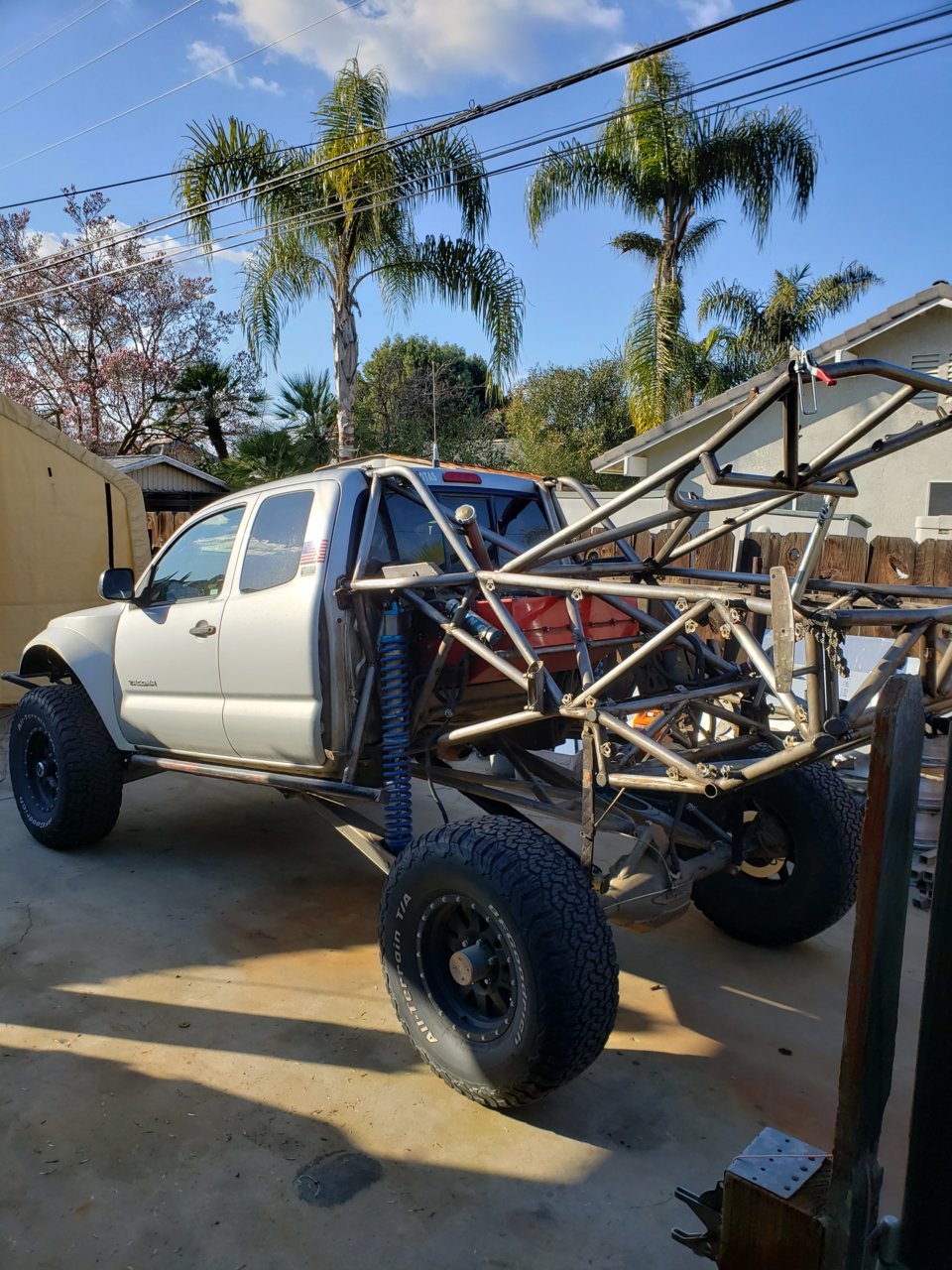

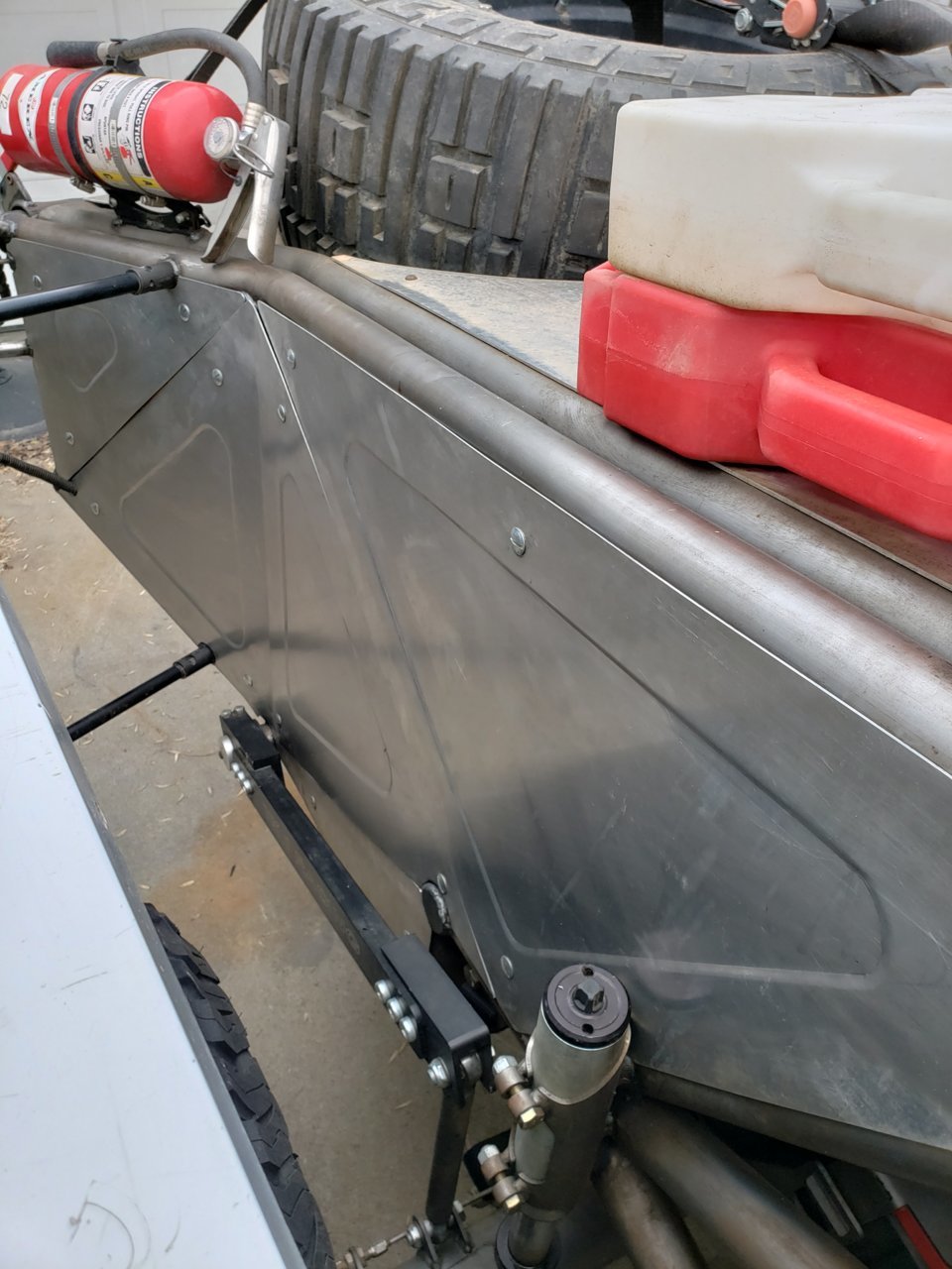

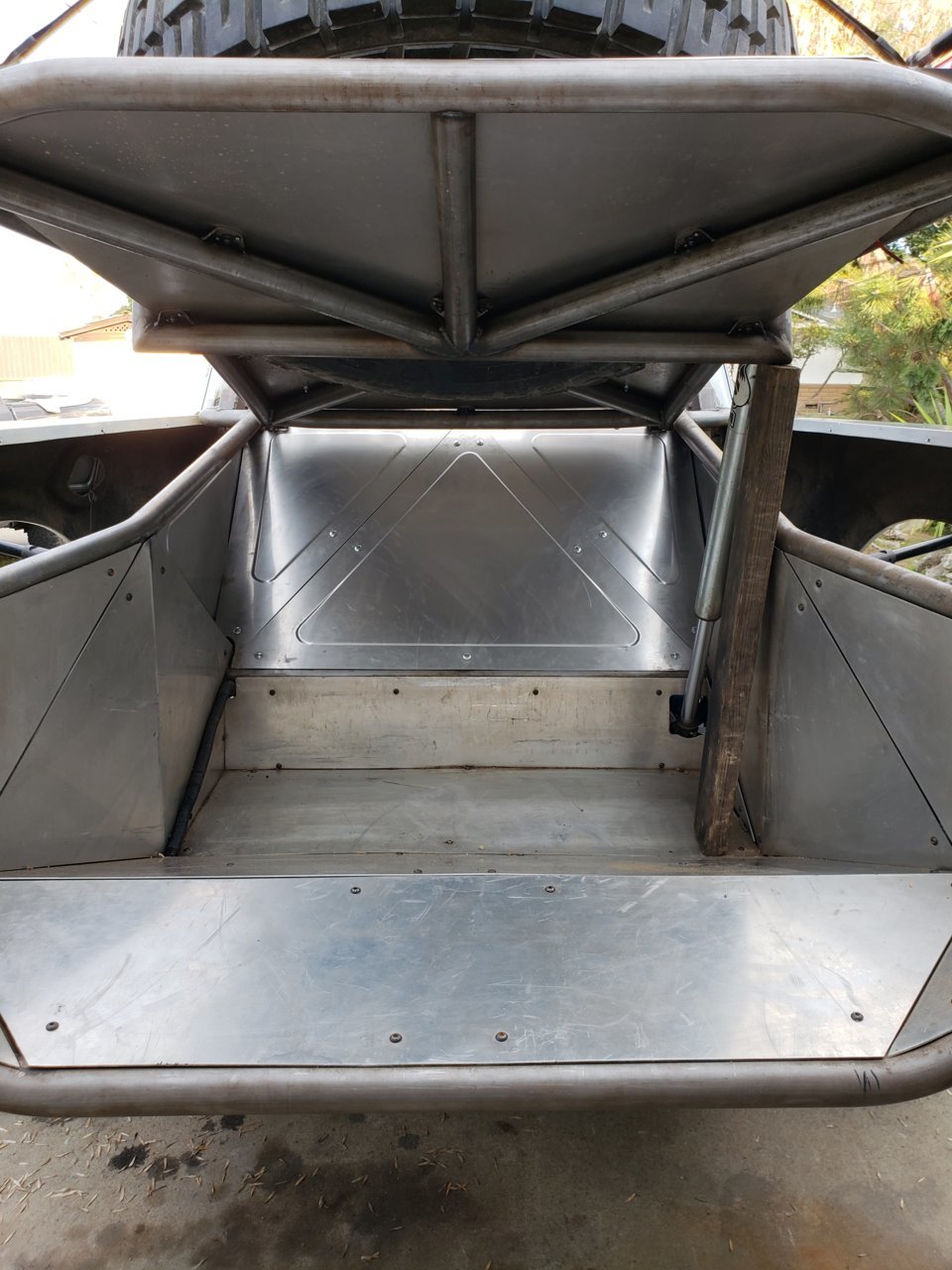

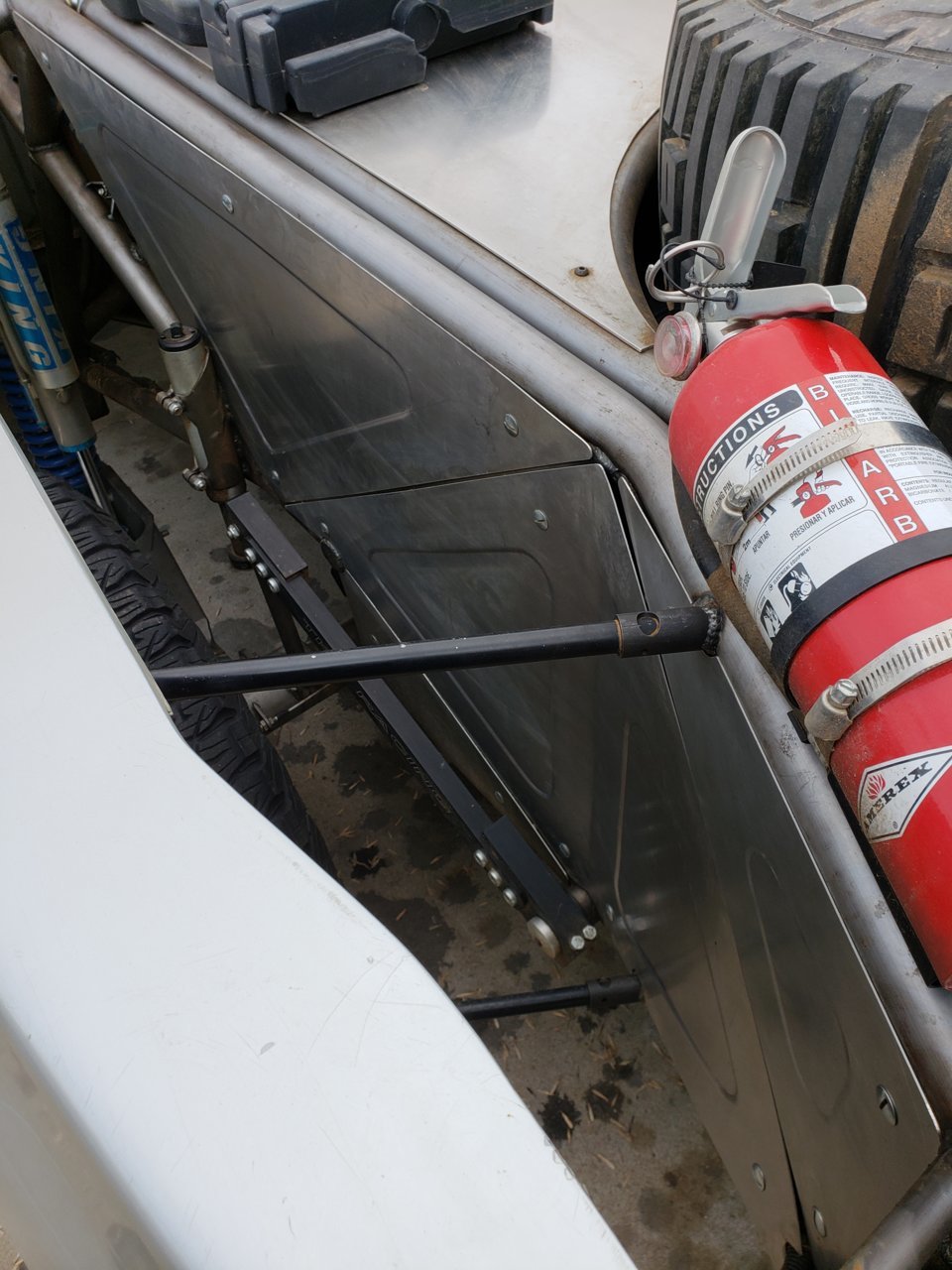

  11. Feb 7, 2019 at 7:10 PM
    #891
    Basikbiker
    Sep 21, 2013
    #112968
    3,987
    Trav
    Beadrolled all my outer skin panels and the inner access panels for the battery and rear diff...cant bead roll the other inner panels cause they're way too thick...I'm just gunna bedliner those or rubber undercoat em to help keep the stuff in the trunk from sloshing around soo much...lil bits of progress

  14. Feb 19, 2019 at 6:02 PM
    #894
    Basikbiker
    Sep 21, 2013
    #112968
    3,987
    Trav
    Stripping her down to paint the backhalf... using Steel-it. Having 25 panels and about 100 tabs it takes forever to take it apart lol
