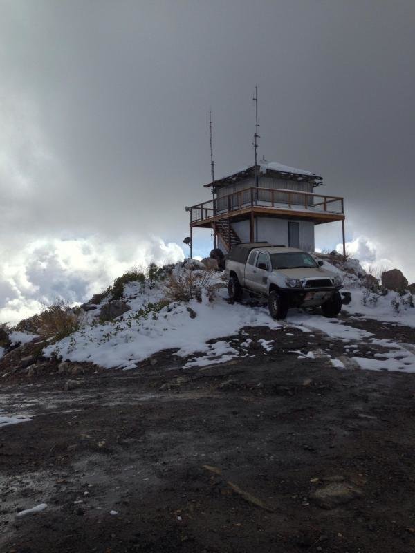

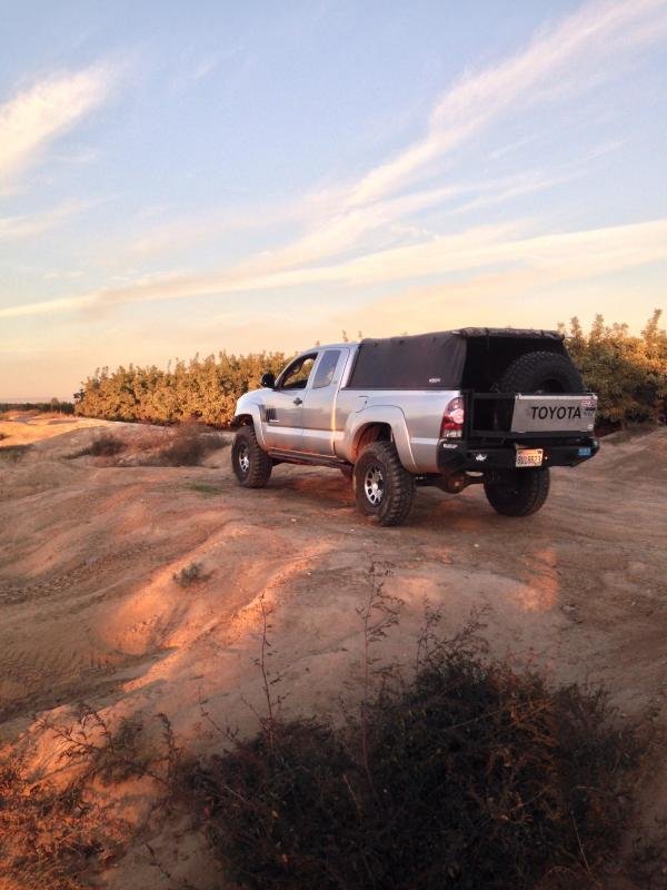

    Wow where was this pic taken man? Looks awesome..!!

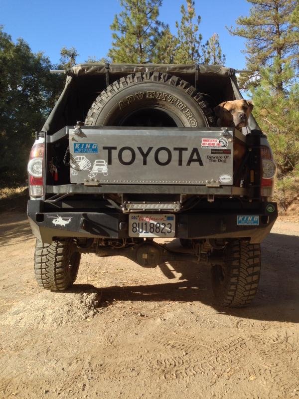

    Basikbiker
    Basikbiker [OP] Well-Known Member
    Sep 21, 2013
    #112968
    3,985
    Trav
    09 AccCab 4x4 spaceship
    My doors are the only stock things left besides the headlights
    that was taken up on shuteye peak, near Oakhurst, CA

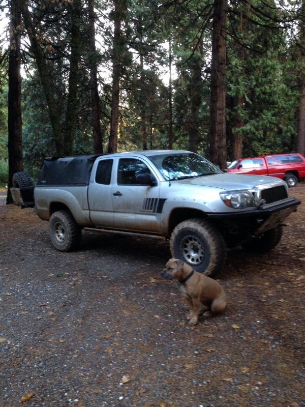

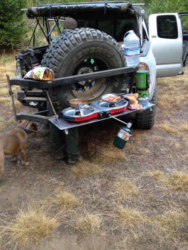

    Camp table in action today
    And new light and sticker lol, of course the dog Roscoe

    Awesome truck! That camp table is nice!

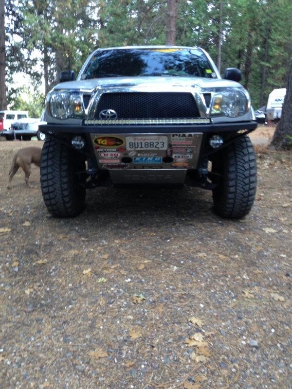

    Got another lightbar, for the front this time, 37" single row AVEC, it's bright in the daytime

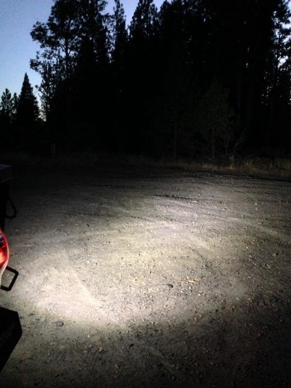

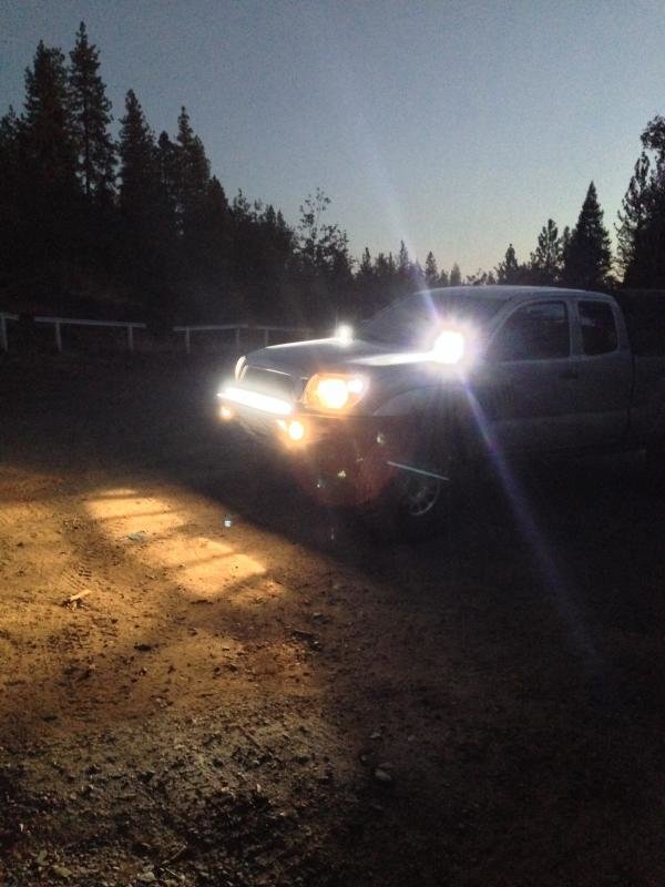

    Basikbiker
    Sep 21, 2013
    #112968
    3,985
    Trav
    Almost nighttime shots
    First the blind factor
    Then front spread
    Rear blinder
    Rear spread(without reverse lights on)

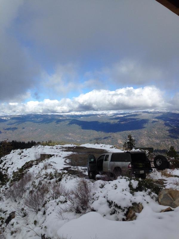

    Basikbiker
    Sep 21, 2013
    #112968
    3,985
    Trav

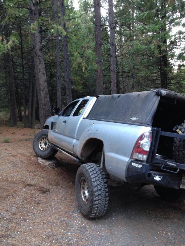

    helped close up the fire lookout for the season, weatherized sum plumbing. excuse to drive in sum sloppy mud/snow, oh and I know you cant tell but no more fender flares either(tired of em rubbing and floppin around,ripped one off on a tree anyway).

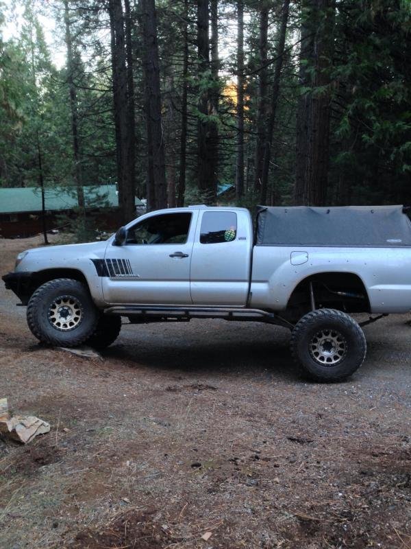

    Basikbiker
    Sep 21, 2013
    #112968
    3,985
    Trav
    no moar fender issues.......till the tires get bigger........

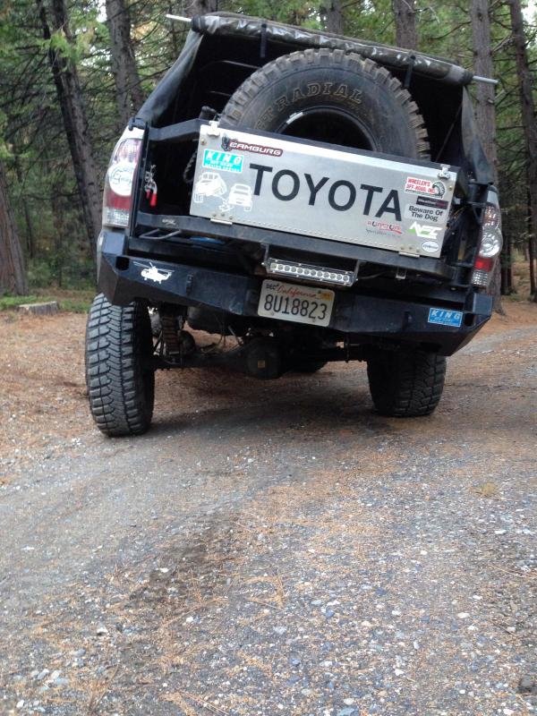

    Basikbiker
    Sep 21, 2013
    #112968
    3,985
    Trav

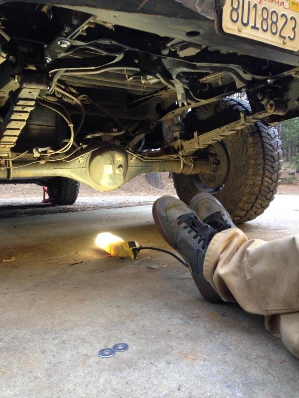

    got my SOS shackle flip hangers in the mail the other day. bit the bullet and conned a friend in helping me and got em installed today, those rivets are a pain in the butt to get out. after the flip the rear is noticeably more supple, and definitely has more droop. next project is putting in the TC cam tab gussets for the front, and air bumps for the rear.
    in the pictures, droop has about 10.75" shaft showing, and can flex probably another inch to be at full droop and bump. so this flip pretty much takes 12" stroke shocks to their full potential
