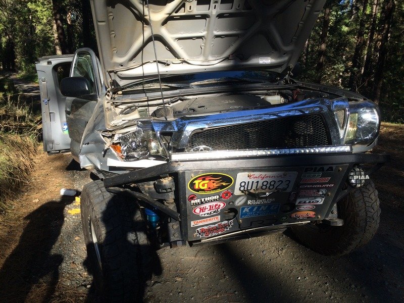

    Was this

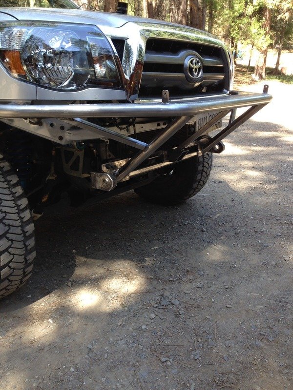

    Bumper teaser

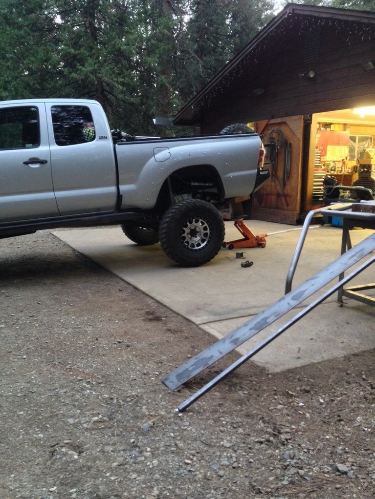

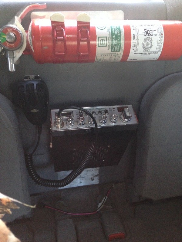

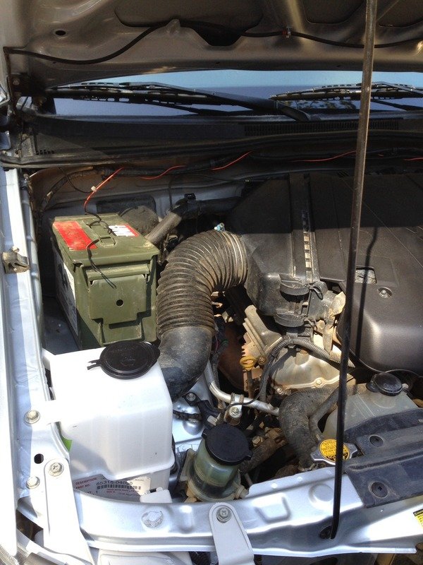

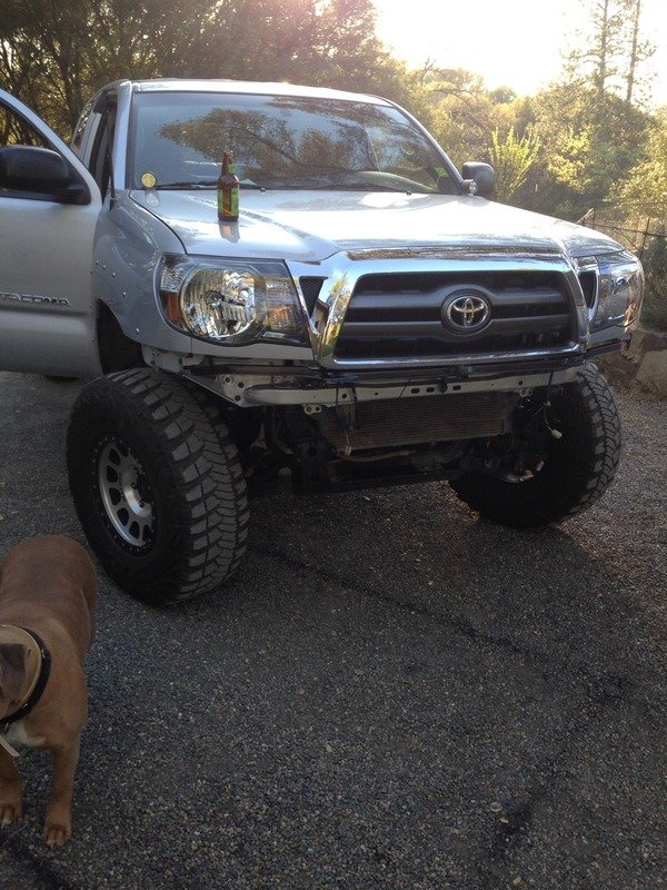

    Since I'm doin the bumper, I'm sneaking in a few other things on the list
    CB radio, and PA

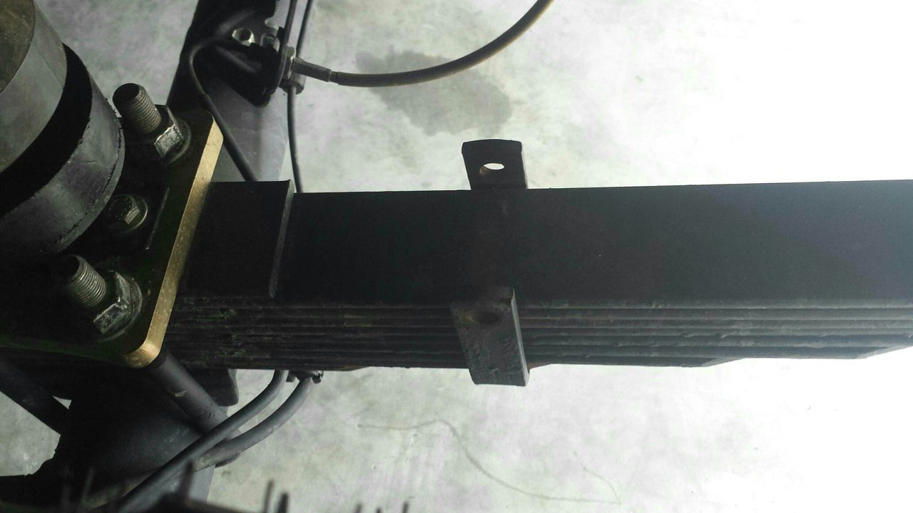

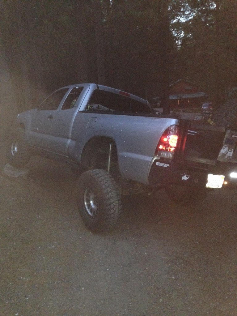

    Put in sum longer shackles
    Little driveway dippin

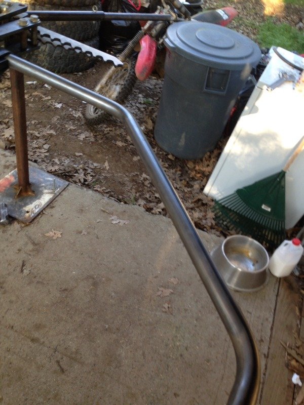

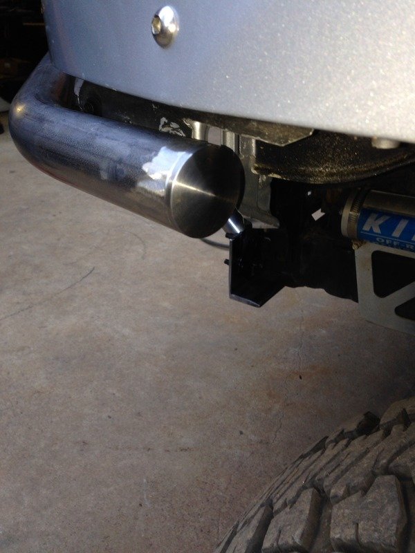

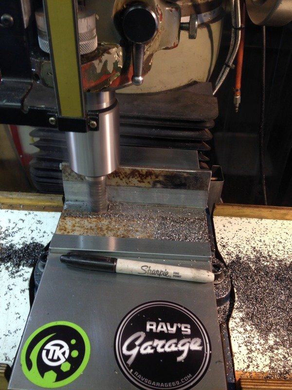

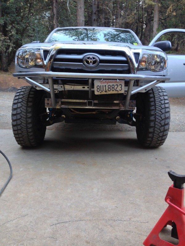

    Had to machine sum material off for the frame mounts
    Progress
    Turned sum tubing caps for the ends
    Plated the top
    Recovered the old recovery points I made off my smashed bumper(thank god for big ass grinders)
    Hopefully I'll be finishing er up tomorrow and squirting sum paint on it

    Shit yeah man. Looking good. Which shackles you end up going with? How much longer are they from stock? I think we have the same rear setup so I'm wondering if you still have some travel left in the shocks so they are not the limiting factor. Thanks.

    They're rubicon express XJ shackles, I think they're and inch longer? I'll check in the morning, loco has the same ones, I think they're 5", leafs still are the limiting part but it's real close when u have the truck twisted, droop is good.

    I have the same ones as well, they are 5" eye to eye

    Sweet. Thanks guys. I know I'm real close to the end of the 12" shocks. Will have to unbolt them or measure to see how much is left and if I can put those on without hitting full extension.

    I fixed that already...note the missing bolt...now everything should be maxed out. I'll go hit the spot later today after I'm done with some diff guard welding.

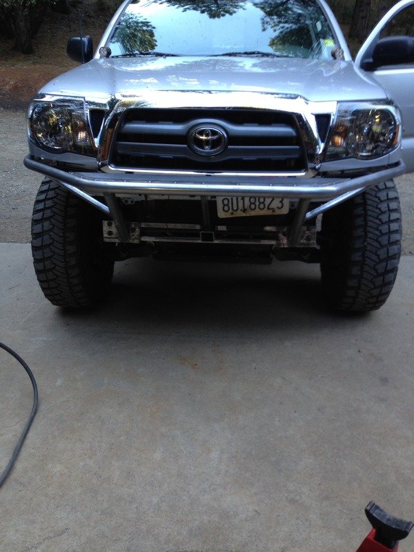

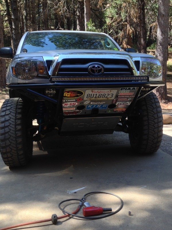

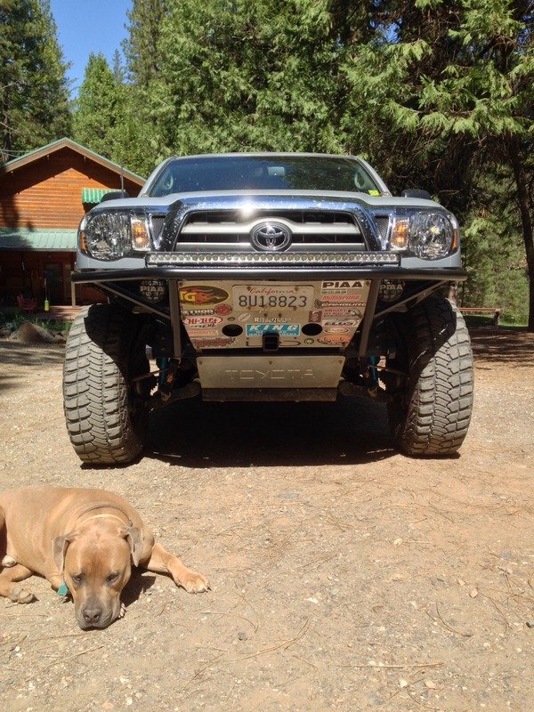

    Pretty much done, have a few things I could do but eh it's ON!
