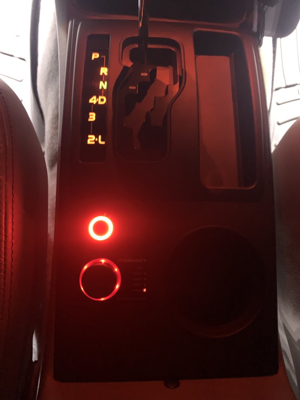

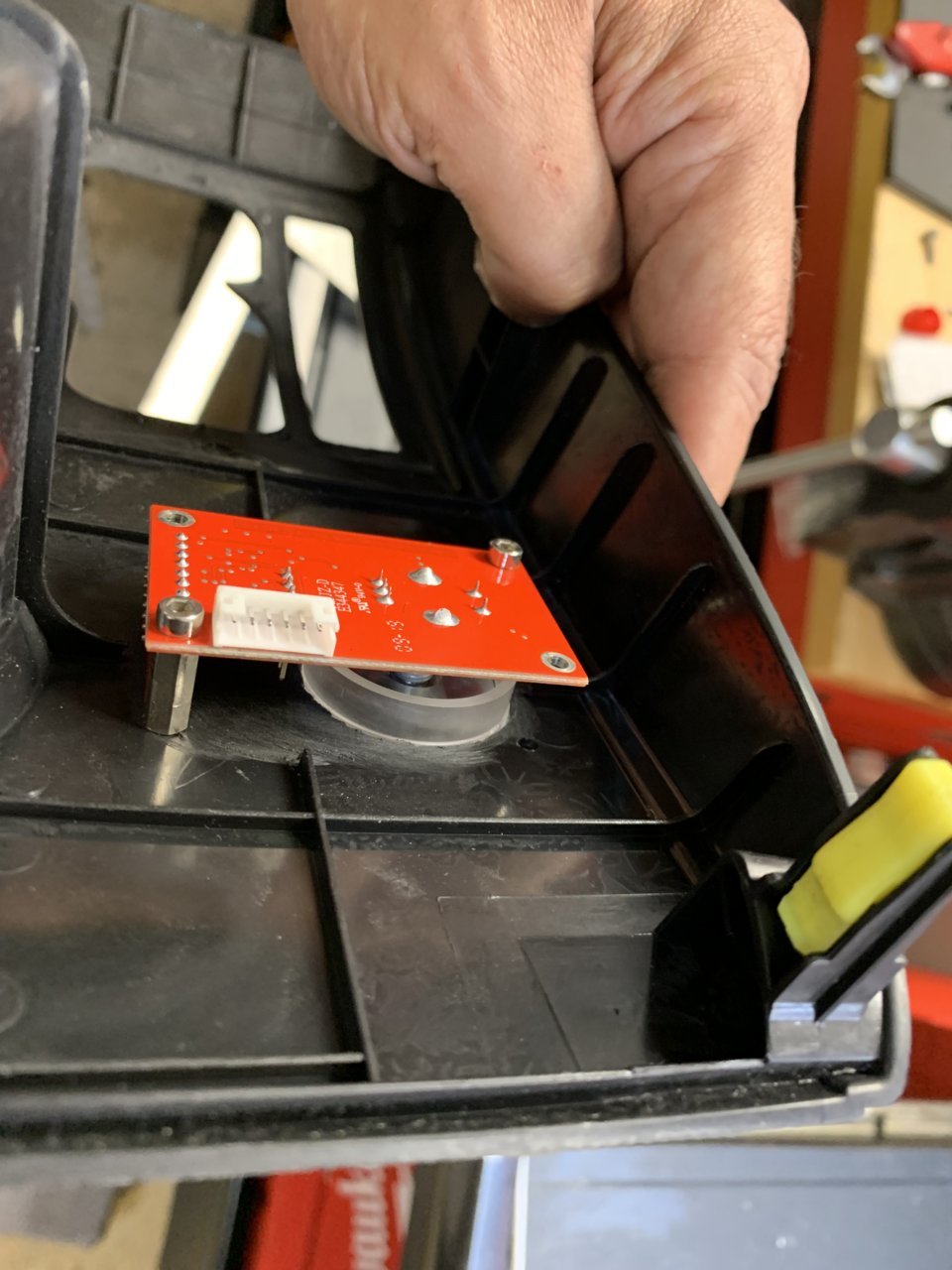

    Exactly and i finally got to tinkering and pulled apart the the pioneer bass knob and it fits behind the blank perfectly. Just drilled a small hole and glued it to the back of the blan .

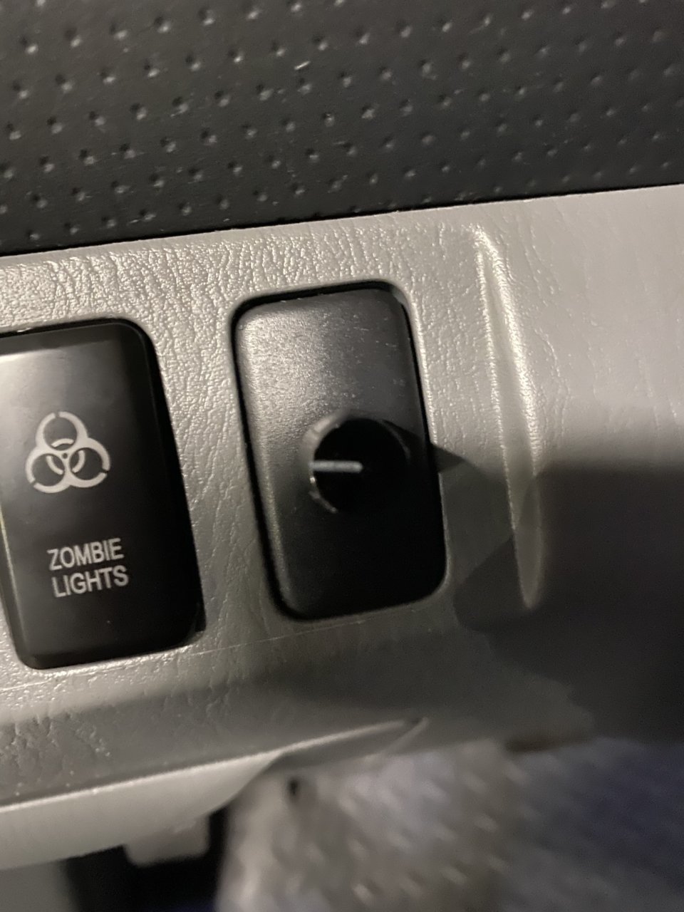

    prone2xl
    prone2xl Well-Known Member
    Jun 23, 2009
    #18803
    681
    Mississippi
    2008 Silver TRD Sport DC
    Hey guys- what do you all use to mark the bass knob level (assuming it doesn't come with a stock painted white line?) mine just had a groove in the bass knob and I got a very fine white paint pen and marked it but then started thinking about possibly a glow in the dark paint line to see at night bc i can't see it (have it to the left of steering wheel in a blank)

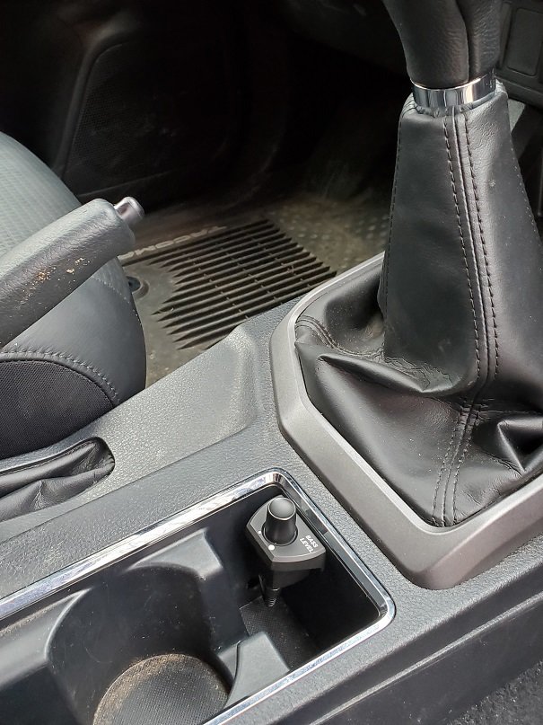

    Kaptain_02
    Kaptain_02 2019 OR
    Oct 4, 2019
    #307062
    137

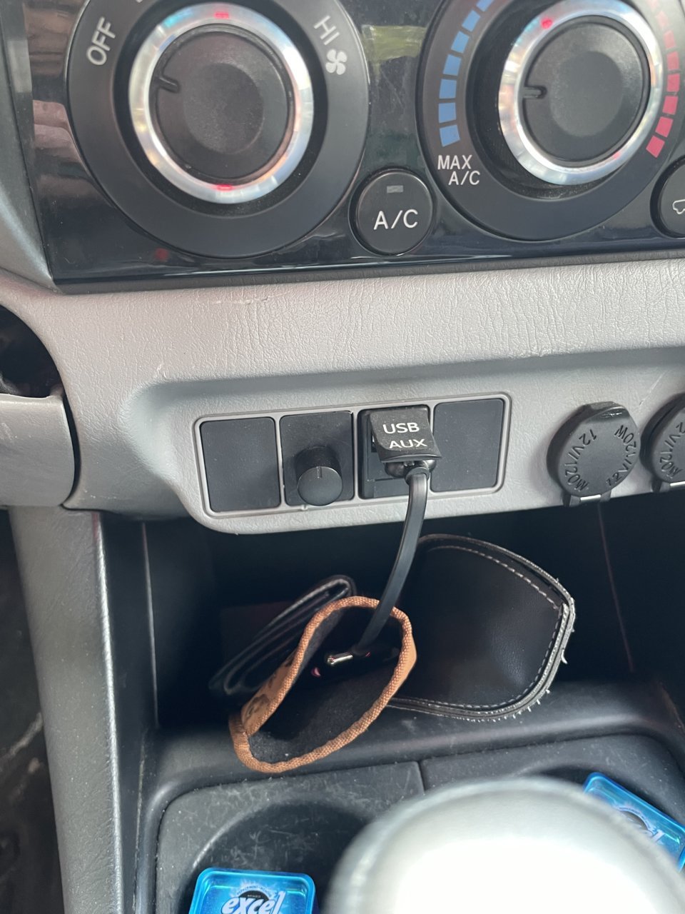

    My preferred spot was under the main switches but couldn't justify ripping apart the dash to do a clean install.
    Definitely happy with this spot though, and my phone still fits in that little cubby

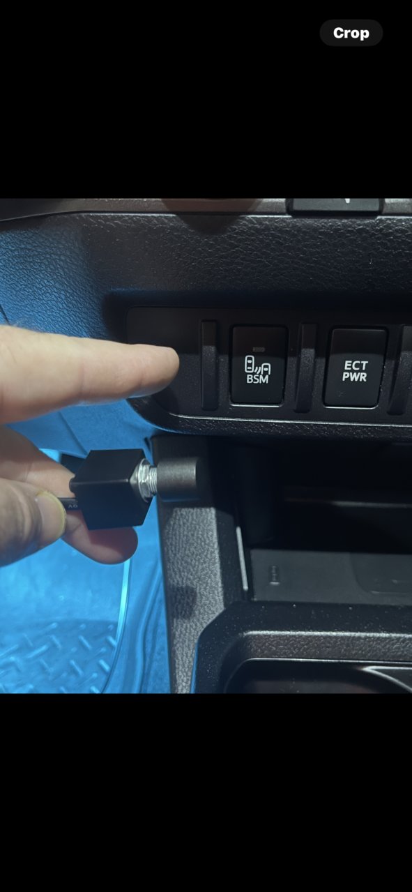

    Does anyone know if this JL audio bass knob in my hand will fit right in this corner where my finger is pointing, didn’t know if anyone had a picture of what it looks like behind this…

    i believe the panel is attached via a plastic clip in that location.

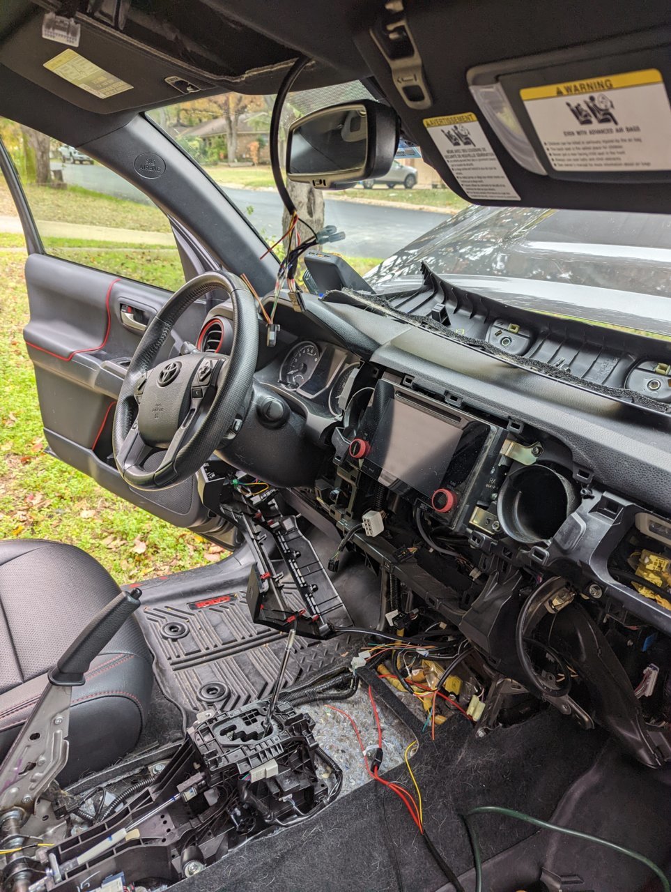

    The switch plate? It's fused to the lower dash with plastic welds. Mesos website has a tutorial on how to pull the lower dash. It's... involved. :cookiemonster:
    Basically all of this has to come out.

    Pretty sure this is a JL knob. Everything else is & it fit.

    that's a gen 2, gen 3 the blanks are slightly narrower. i'm not so sure the jl knob will fit.
    ok, i've got one of the RLC knobs from my old carpc install-- it will just barely clear the dash obstructions of the blank plate, but the blank itself needs to be substantially altered on the back with a dremel. the knob also needs to be taken out of the plastic enclosure.

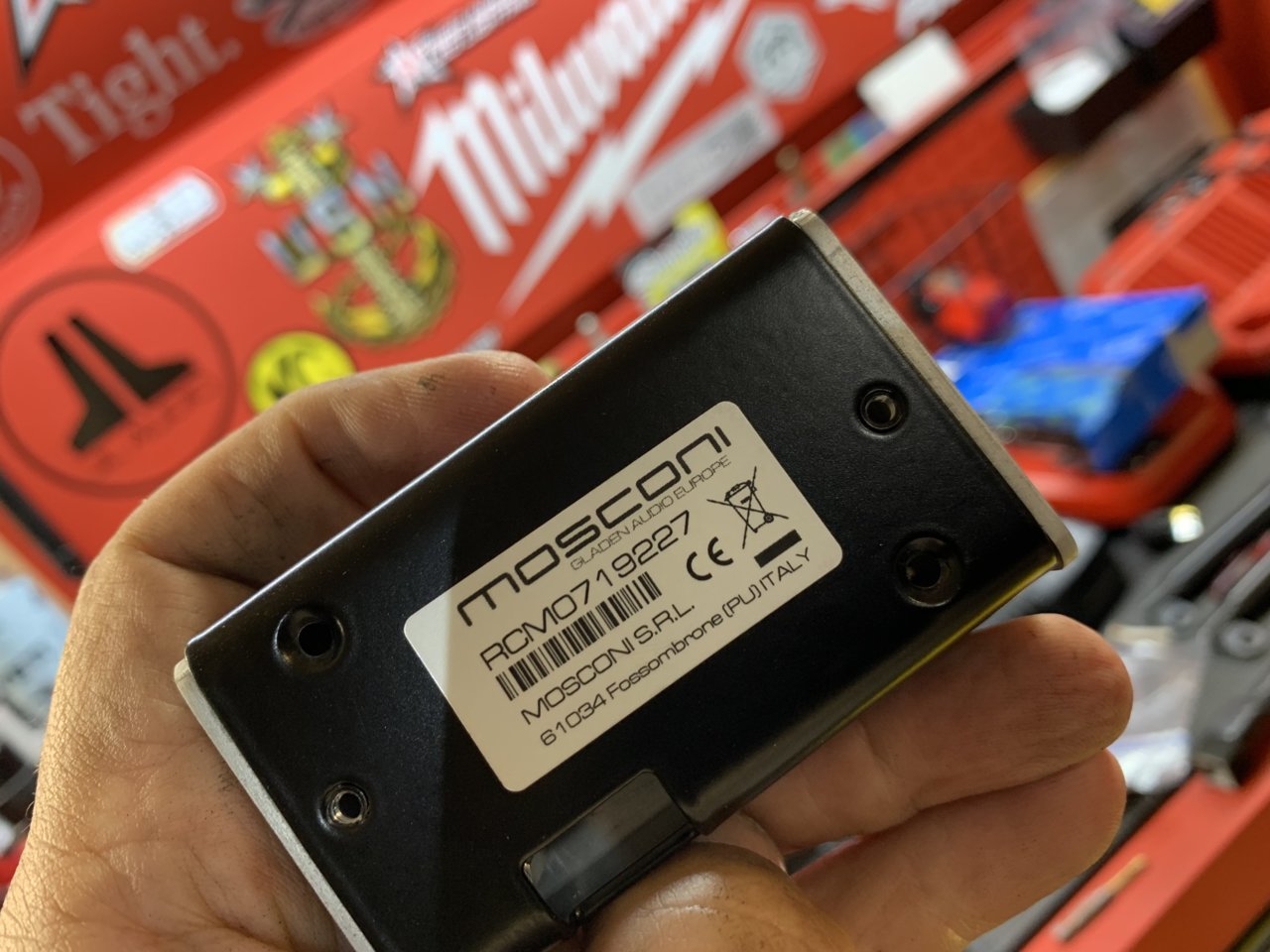

    Your installation looks very clean! Can you tell us which knob you used and explain how you installed it? I'm about to put in a sub and would like to do the same thing. Thanks in advance.

    JL bass knobs can be taken apart (knob pulls off the “rod” for custom installs… you pull the knob off and you can access the nuts that lock up against a flat surface. Very simple , the only hard part for me was running the wire

    so far, all bass knobs i've come across will come apart to do the same thing.
    but if one is set on using the jl audio models, the jl audio cl-rlc remote preamp/line driver uses the same knob as their amps, and can be integrated into any aftermarket audio setup.
