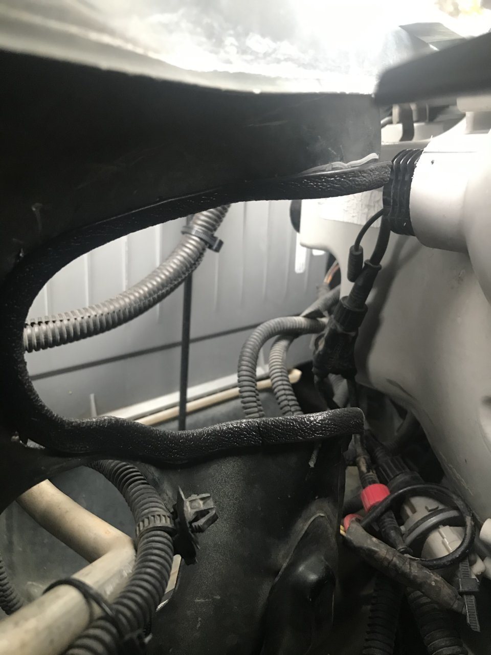

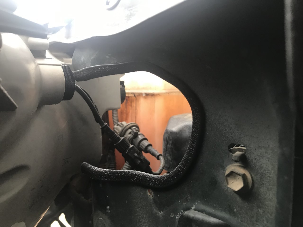

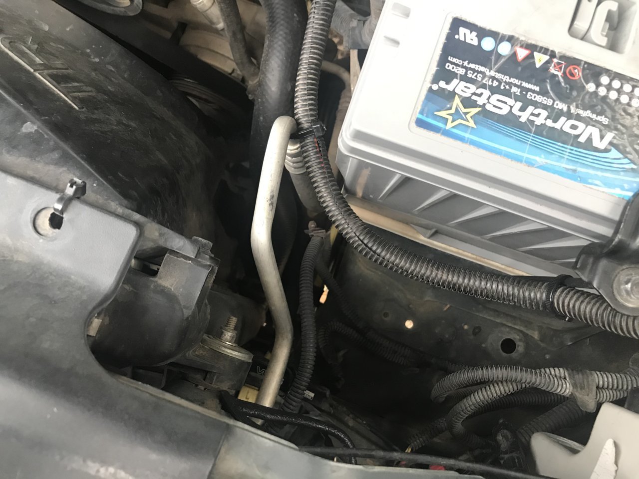

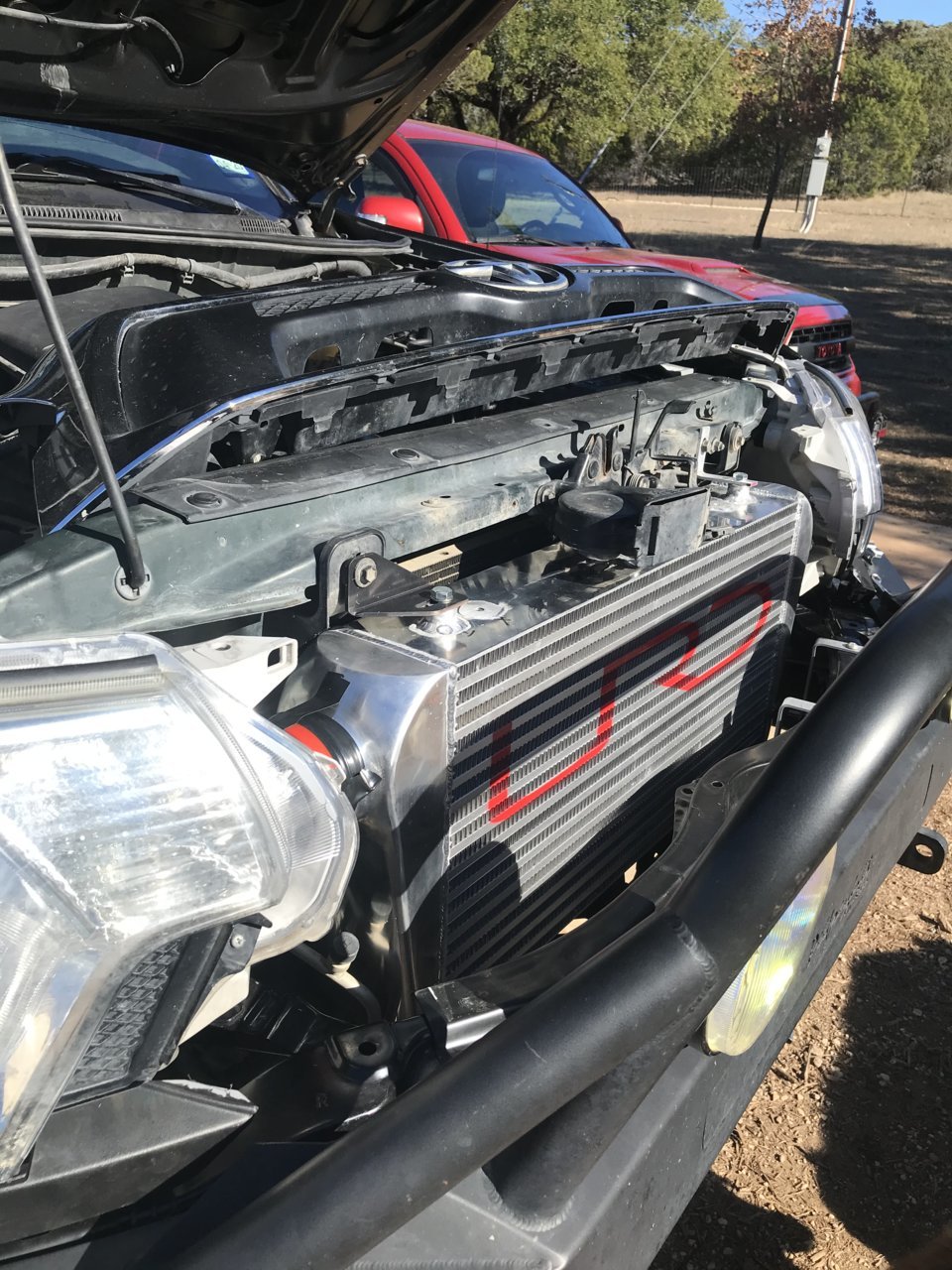

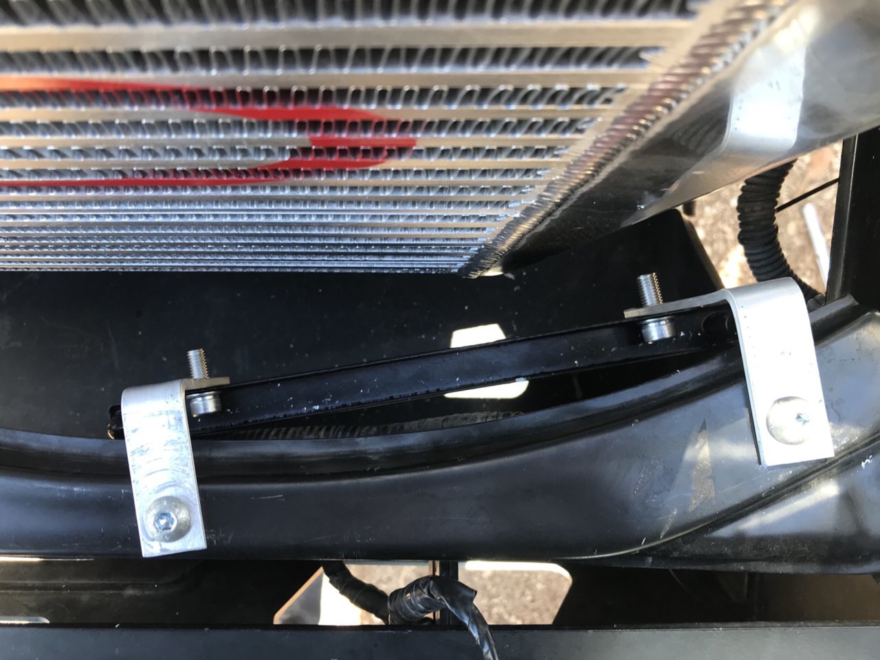

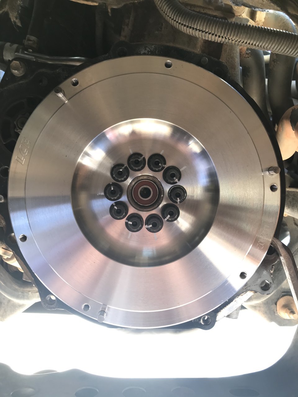

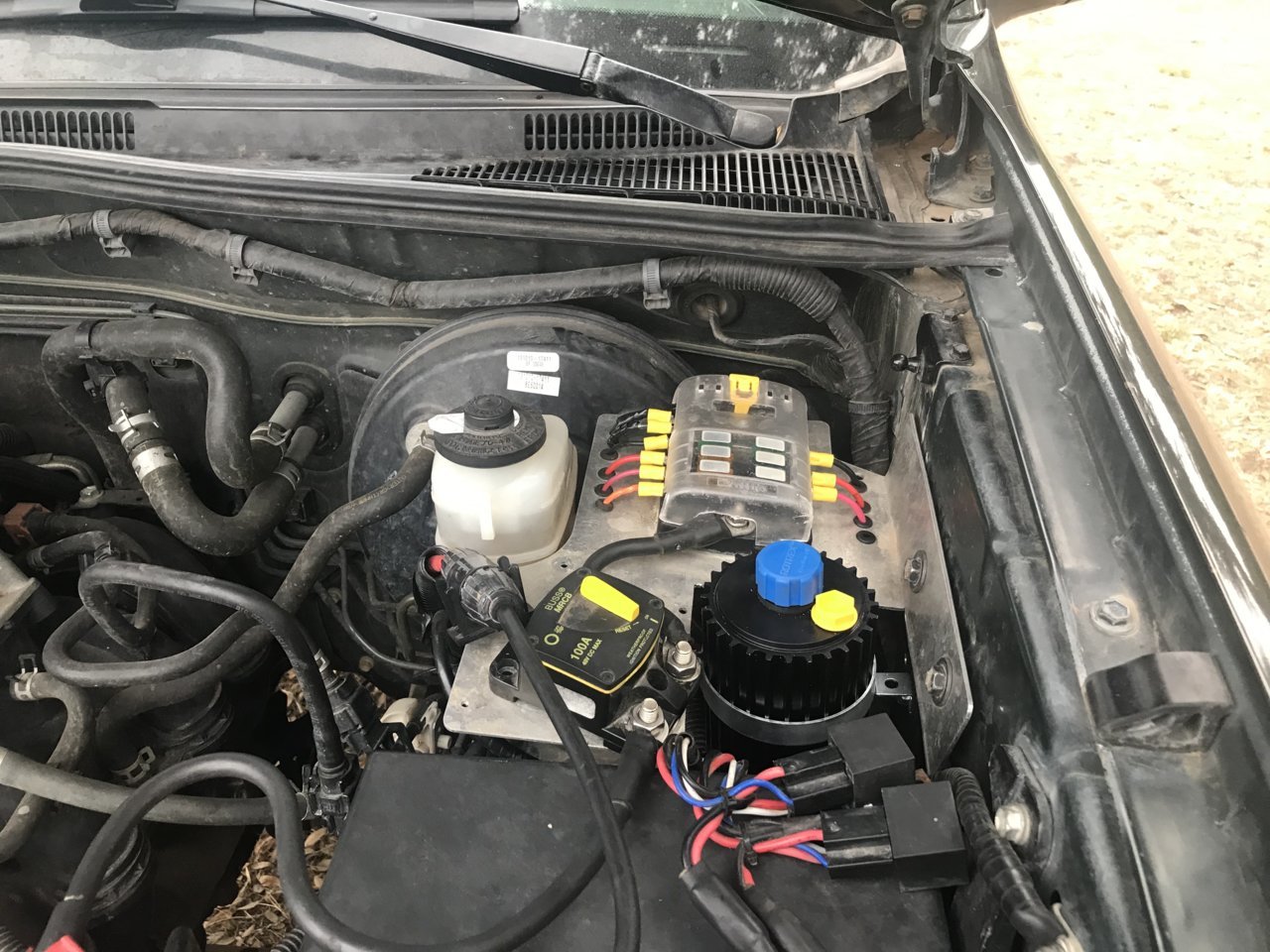

    Good evening everyone! Hope you all had a Merry Christmas and spent some good quality time with your families:hattip:

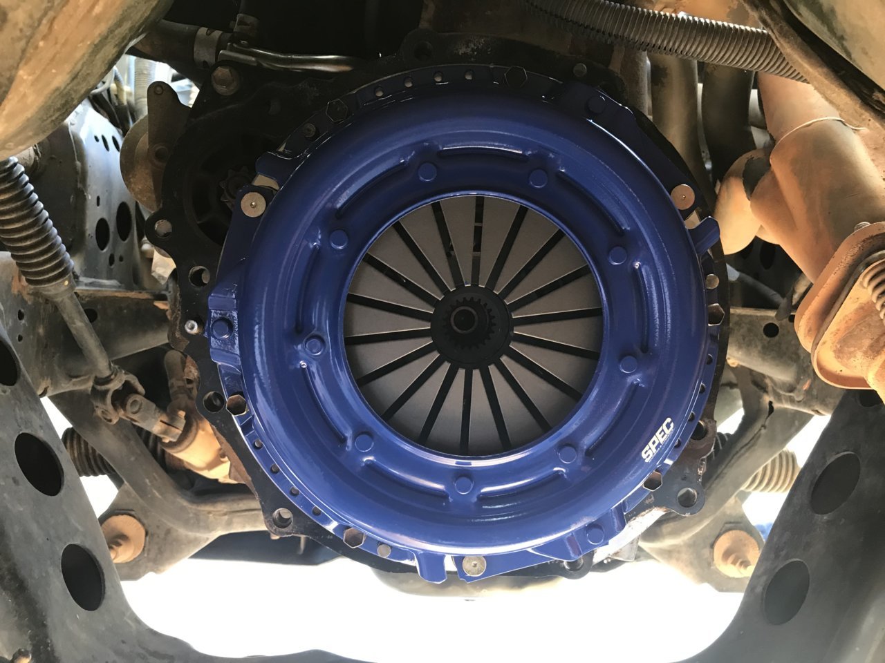

    been doing some work on the truck lately on my time off! Installed a hypertech to correct my speedo, a 170* thermostat, modified my fuse block plate to mount an oil cooler reservoir, cut the core support for charge piping, intercooler mounted behind the grille, horns relocated, made some brackets to mount the SC oil cooler, installed a stage 2+ SPEC clutch and LCE lightweight flywheel. Also made a jumper wire harness for my MAPECU3 so i didnt have to cut my factory harness. Switch back to a 27F battery from my 31M was necessary for charge piping clearance. AEM 340LPH fuel pump and two step colder spark plugs are getting installed tomorrow. Hopefully if i have extra time i can throw everything else on too.. getting so close now
    Oil cooler resi squeezed in there. Was gonna try to relocate it but this seemed like the easier way to go
    Core support weight savings:sawzall:
    clearance w/ 27F on driver side
    had to retap the upper mounts for this, couldnt locate M7 x 1.25 bolts and URD send M8 x 1.25. Little more work and i got it stuffed in there:D
    Brackets to relocate oil cooler, the one that came with the urd kit interfered with the pelfrey bumper. Gonna run the oil lines tomorrow.

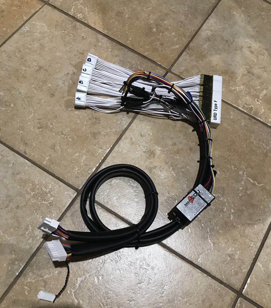

    Used a Type F URD jumper harness to create a plug and play solution for my MAPECU3. Doing this myself made me a little nervous but i am happy with how it turned out. Fingers crossed the truck runs right when i plug all in:fingerscrossed:
