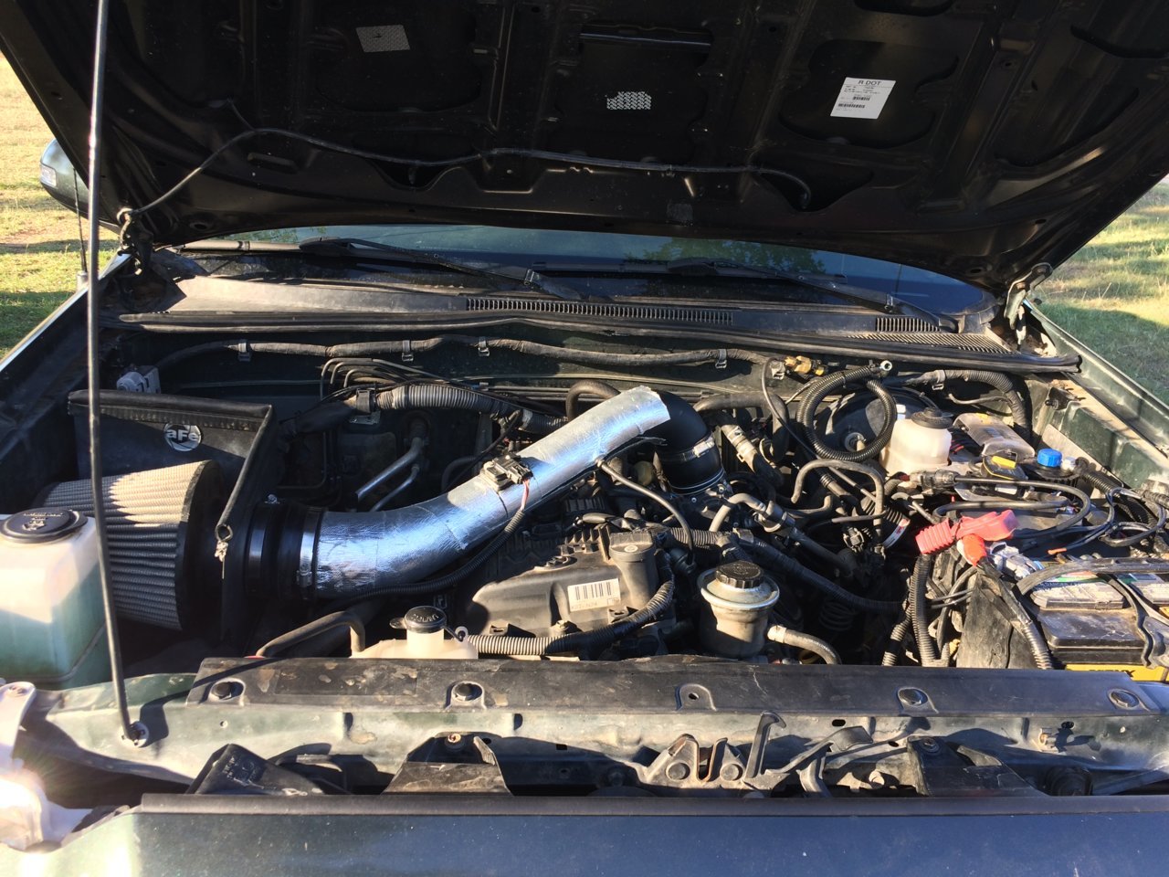

    Good evening y'all, been super busy at work lately. Tax day is Wednesday, so hopefully it slows down a little after that
    I decided to put the old motor back in the truck this weekend and just run it n/a for a while. Took me about 8 hrs to drop it in, put everything back together and start it up. Had a misfire at first but it wasn't throwing any codes. I could feel it vibrating and shaking though, so I went back over the wire harness. Found that I left injector #4 unplugged and after reconnecting it, everything went back to normal, so that was a plus.
    While i had everything apart, I replaced the front main seal, pilot bearing, and threw in a used Luk clutch that had about 5k on it. Also went back to a midpipe with cats and my old aFe hot air intake. The old pilot bearing was coming out of the back of the crankshaft and it also had a gritty feel to it when turning it, so I'm guessing many of the old clutch vibes were from this.
    Truck is running pretty good so far, besides feeling completely gutless lol. But alas I am happy to have it back in working order for now.
