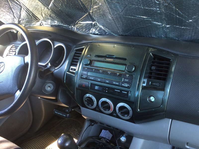

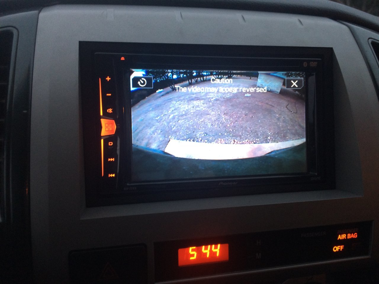

    Upgraded my stock radio with a Pioneer AVH-221EX and wired up the factory backup camera to it. I used a PAC RP4.2 TY11 wiring interface and I had to run three wires from near the mirror to down behind the head unit to the controller. Also had to run a 12v reverse wire over to the driver side kick panel for the reverse input signal to the head unit. I also added a relay to bypass the parking brake signal and allow passengers to watch DVDs while driving. I used a Scosche dash kit and it fit pretty good once i figured out how to get it properly put together. Still need to hit it with a coat of paint and then add a usb/aux plug that i'm waiting on still but other than that this project is mostly wrapped up. Also bought some RIPP coil packs to replace the originals since they were on sale for black friday

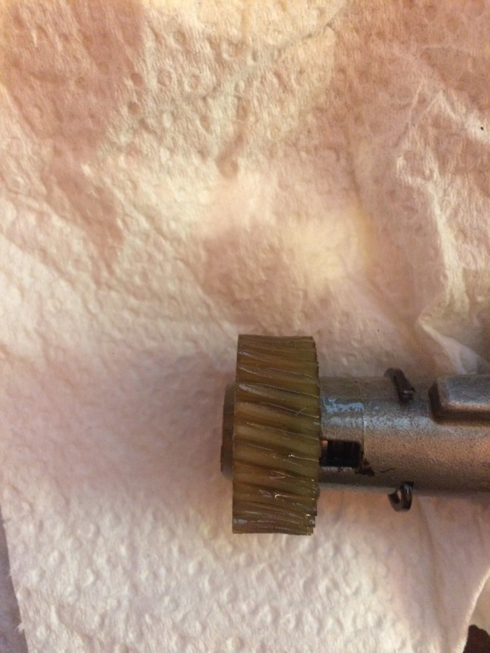

    Had something strange happen the other day while driving. The speedo suddenly started going up and down above the speed i was traveling at and reading erratically. Then it totally quit and i got a P0500 trouble code - "vehicle speed sensor malfunction" . The problem ended up being a worn out nylon gear that is the speedo output on the back passenger side of the trans. I pulled the one from my spare R155 and popped it in there and it was back to working so it was a pretty easy/cheap fix. I had to recalibrate my speedo with the hypertech too bc i unplugged the cluster to troubleshoot but got that dialed back in pretty easily. Below is the original speedo sensor that finally wore down on the inner edge after 273k miles.
