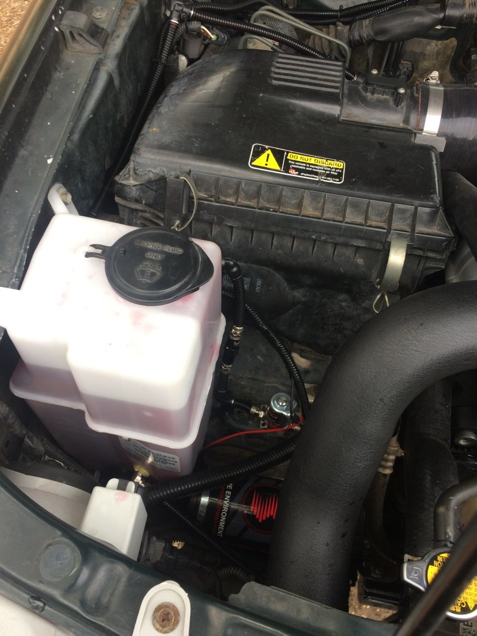

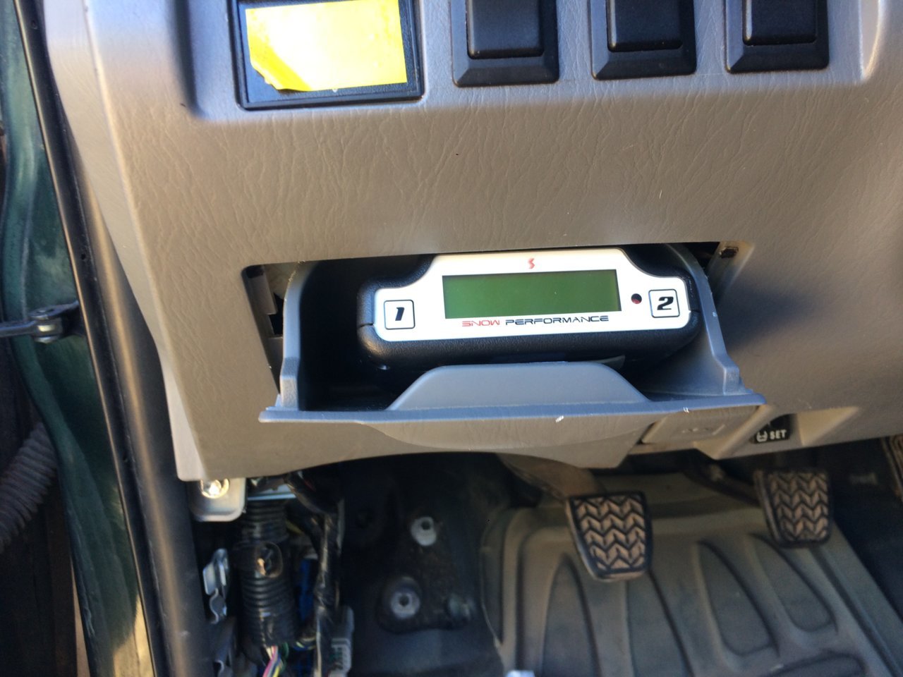

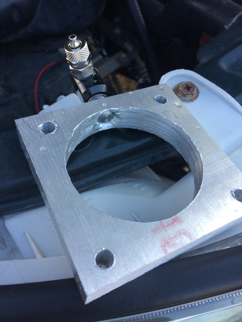

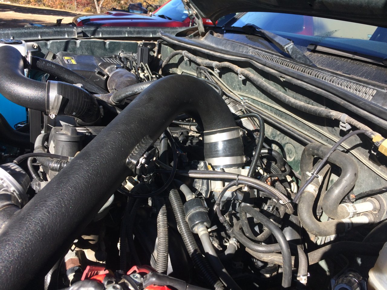

    Added a stage 3 snow performance water/methanol injection system this weekend. Made a throttle body spacer out of aluminum and tapped it for a 1/8 npt methanol nozzle. It’s not the prettiest, but it does the job. I put the pump in front of the air box on the passenger side and then routed the wiring and injection lines behind the air box. I originally wanted to put the controller on the steering column, but it made it where there was no adjustment so instead I drilled a hole in the coin tray and stuffed it in there.

    Poolville Texas
    Nice. What’s this gonna do for you?

    Thanks Maner! This is mainly for safety, it bumps octane up around 25 points, adds some more fuel, and cools the intake charge so it’s pretty good for knock protection.
