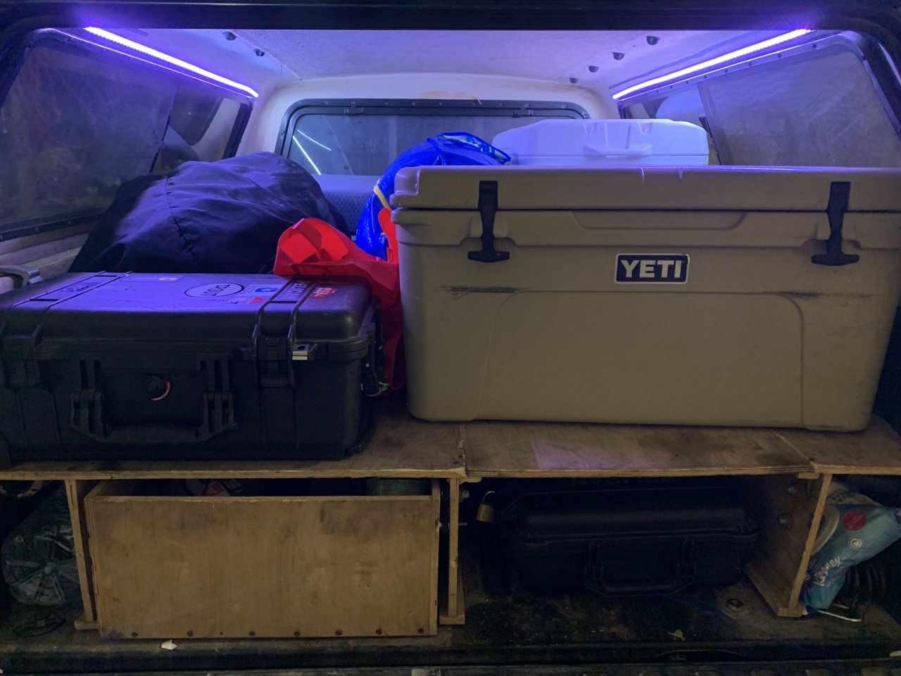

    Yeah I made a platform almost two years ago. 00C263D9-9130-4E14-8449-98ABBCA3F019.jpg

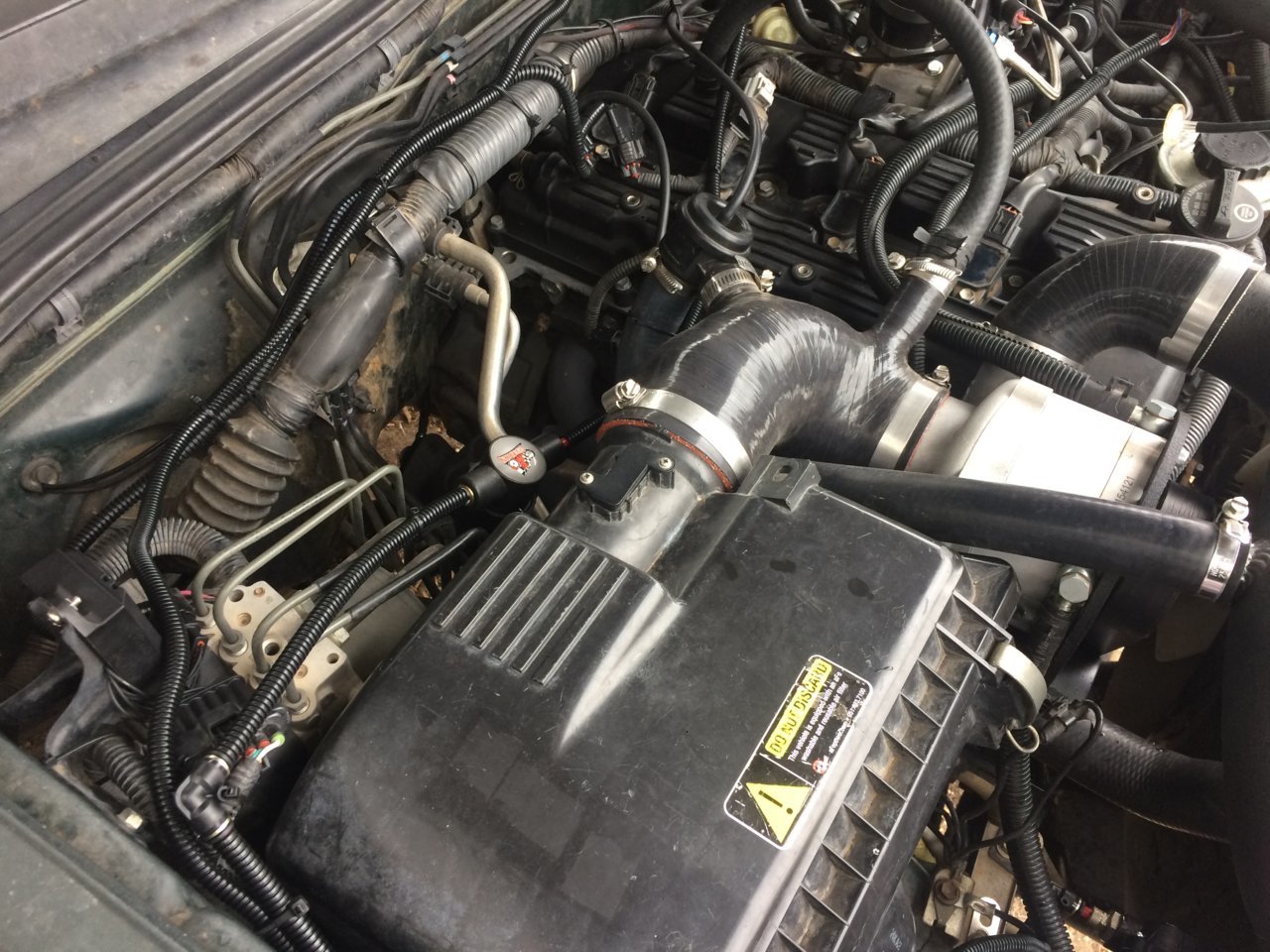

    Good evening yall!
    I added a water/methanol 40 micron filter today. zip tied it behind the air box to the ABS pump. Also swapped grilles out for the thin lip satoshi one I made a while back. Today I was looking at all of the vacuum hoses and it’s a real mess, so I ordered a billet aluminum vibrant vacuum block to use to clean up all the t-fittings.
    I have a t-fitting in the vac lines for the boost gauge, snow controller, MAPECU3, bypass valve, and blow off valve. Hopefully having them all routed to one place won’t cause any issues

    Can't wait to see the cleanest up lines with that block. Post pics when it's in! :thumbsup:

    You bet! I am still trying to figure out in my head where I can put it

    It may hide all your hard work cleaning it up, but under the air box?

    I had thought about drilling and bolting it to the bottom section of the air box, but I now have my eyes on that part of the firewall behind the abs pump.
