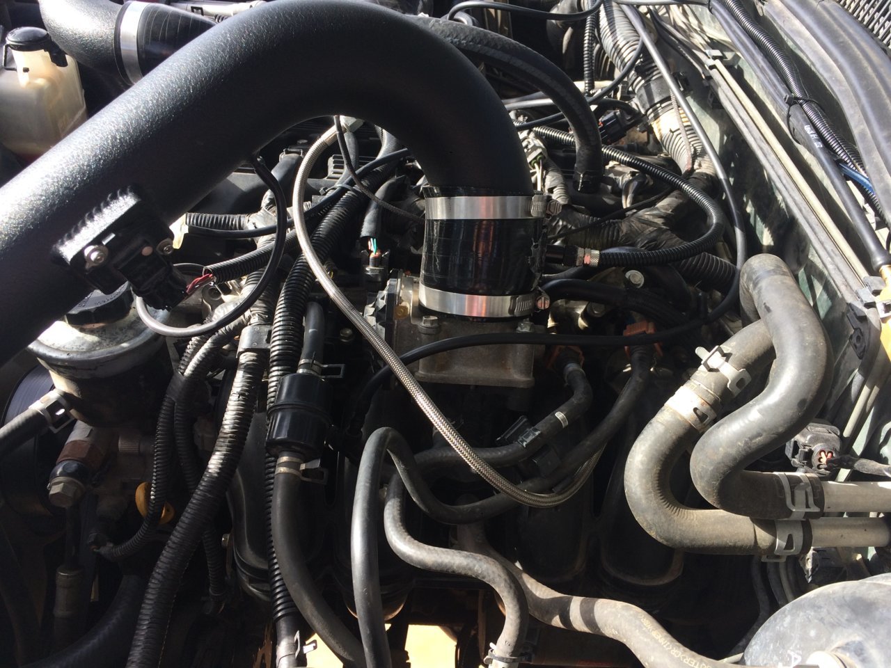

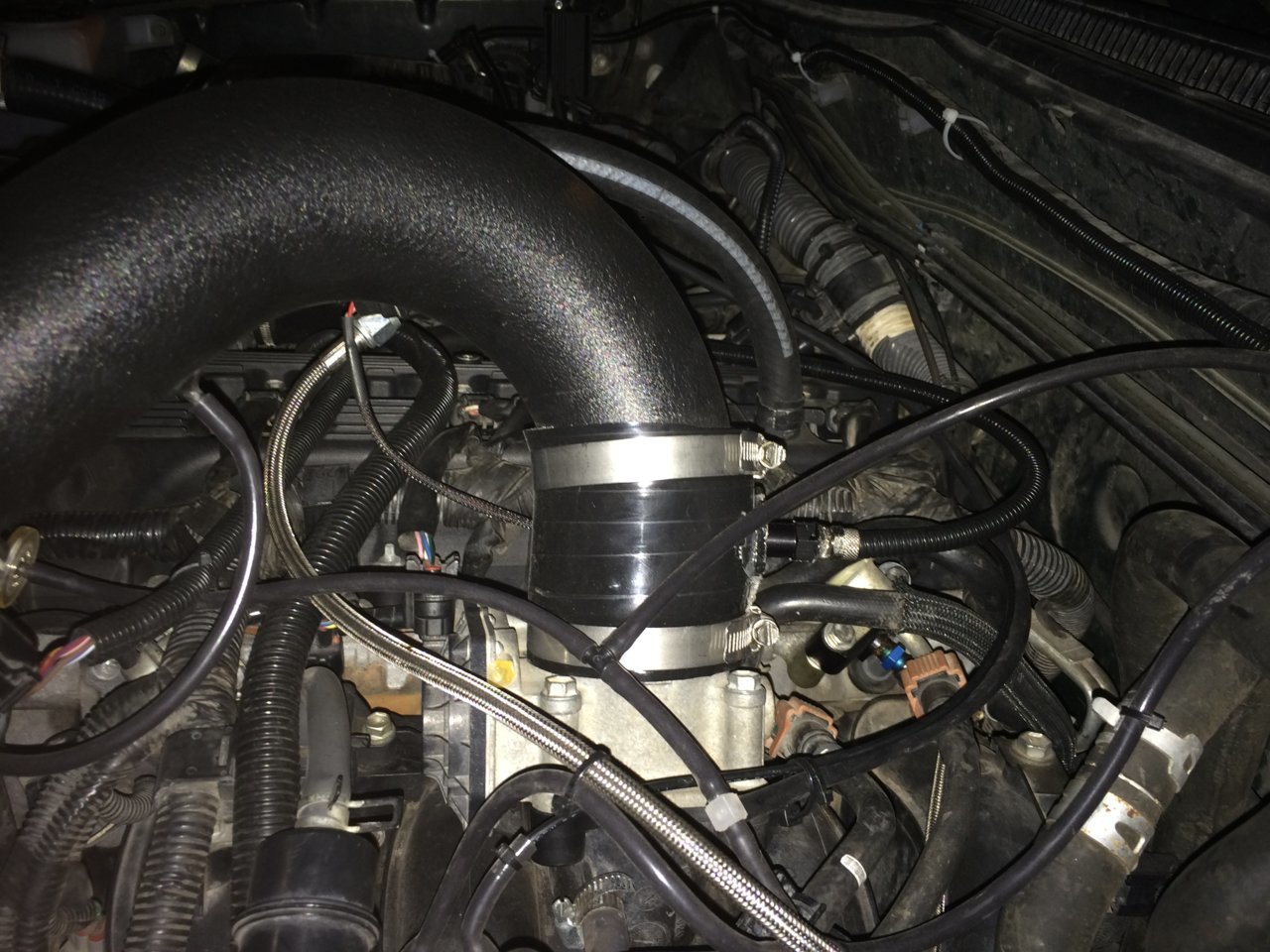

    Got the Vibrant vacuum manifold installed and hooked up today. It really cleaned up things nicely! Had to drill a couple holes in the firewall and make two 90 degree brackets out of aluminum to push the bottom of the manifold out but other than that it went together pretty smoothly. Still need one more piece of bigger vac tubing but I’ll have to get that another day. Merry Christmas yall:cheers:
    Driver side
    Before
    After
