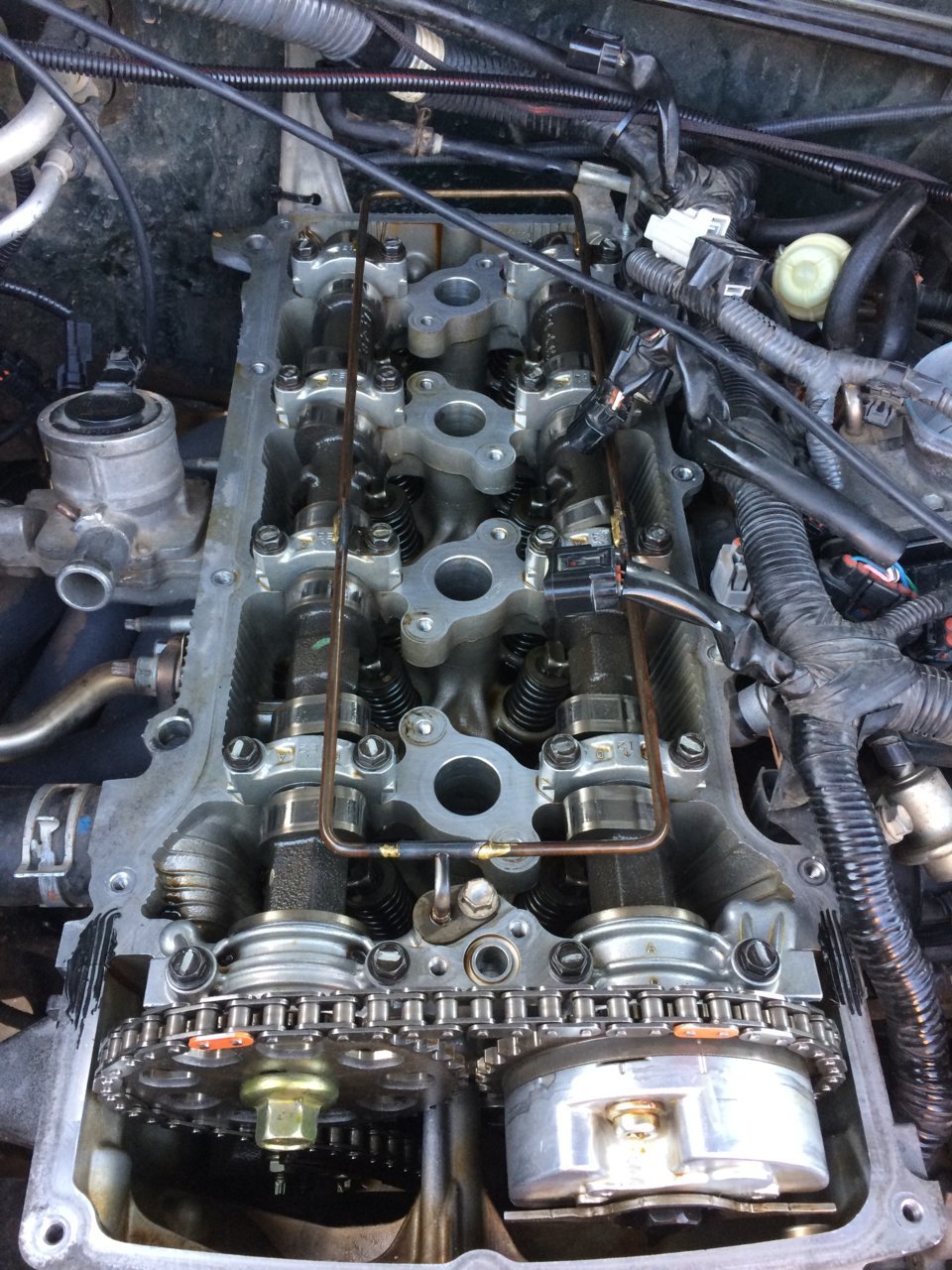

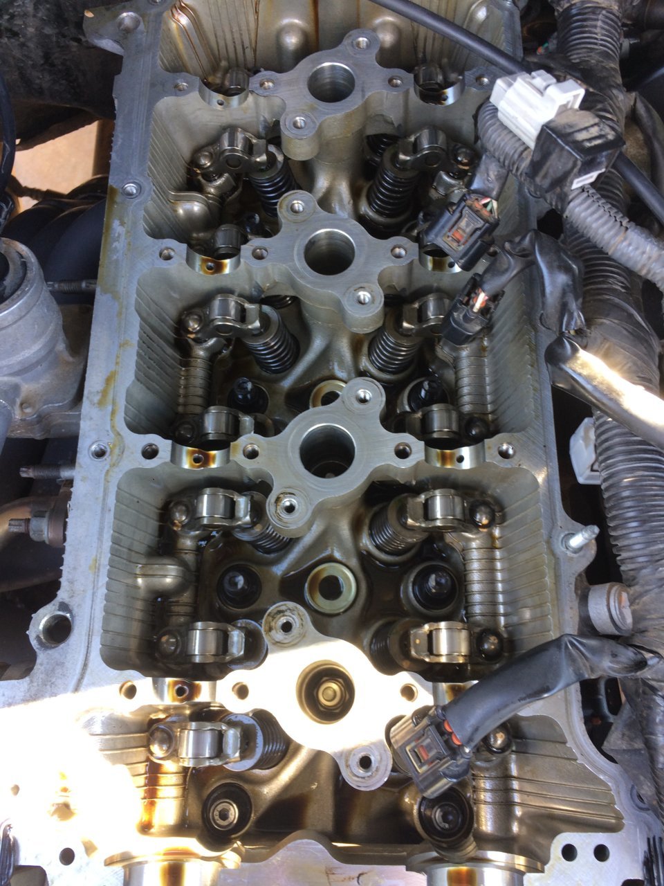

    Installed some ARP head studs today as a last ditch effort to try to get the head gasket to stop leaking. I will know more this week when i drive it more but it runs like normal still so i did something right haha. Took a few pics but i was wrenching pretty steady from 10am till 7pm today.
    Timing lined up for tear down
    Exhaust cam removed
    ARP studs in and torqued down to 80 ft lbs
    Cams back in and torqued down.

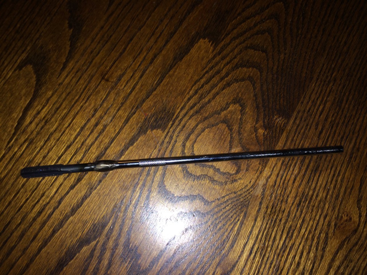

    Here’s the tool i used to chase the threads. ARP m11x1.25 chaser welded to a harbor freight 1/4” drive 8” extension. Had to grind on the thicker area to have enough clearance for it to get down in the bolt hole, but worked okay overall. I chased each thread 2-3 times and I used lucas red n tacky on the chaser on the first pass. I was a little worried about using too much grease and hydraulicing/cracking the block when torqueing down the new head bolts so i ran the tap without any additional grease on it the 2nd and 3rd passes to clean out as much as i could. i cleaned it off the chaser between passes each time.

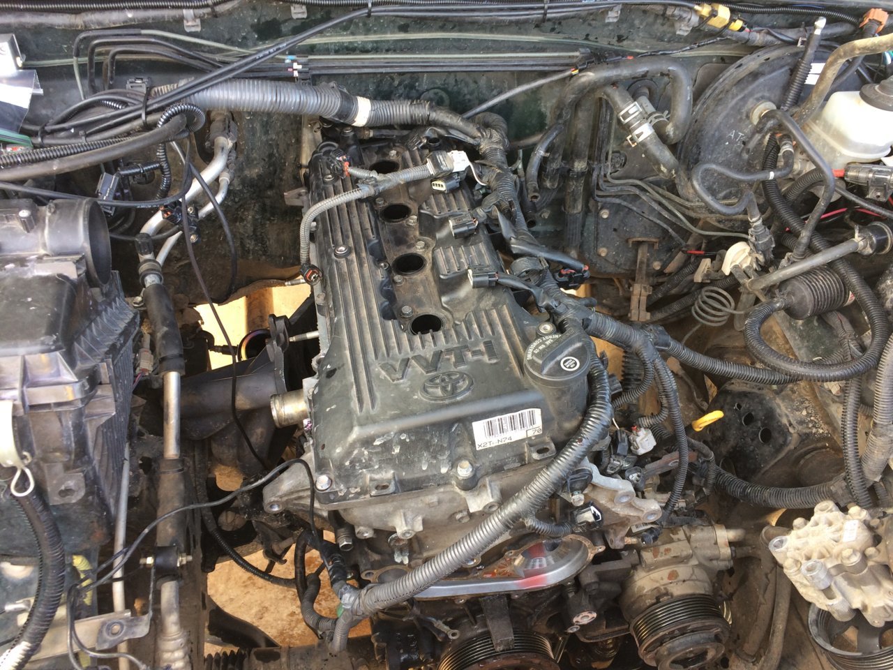

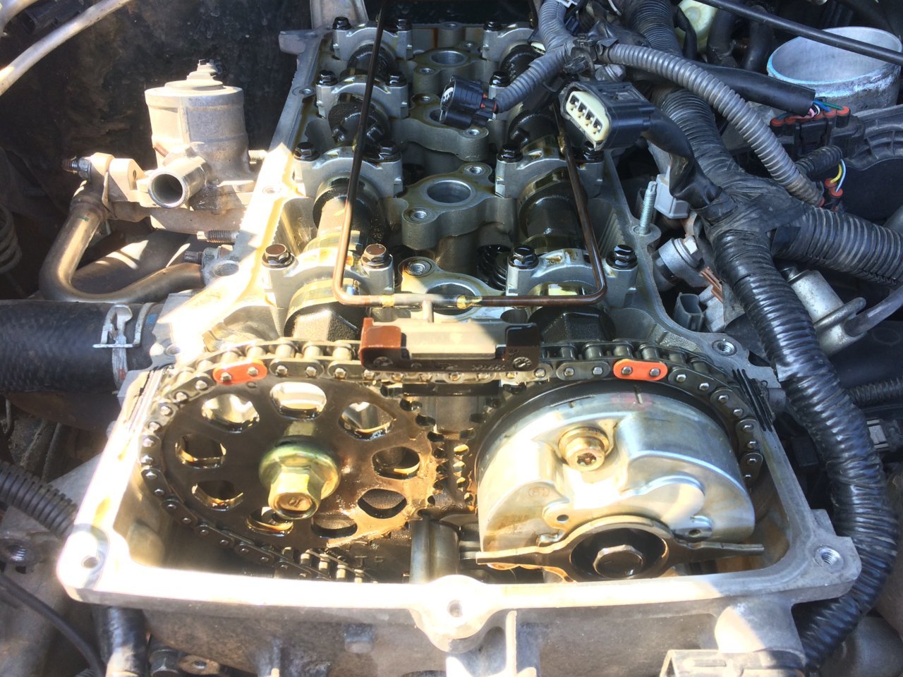

    Progress so far. Getting ready to pull the valve cover, set the timing, then out comes the cams and timing cover, followed by the head. Hoping to have it finished being torn down in a couple of hours
