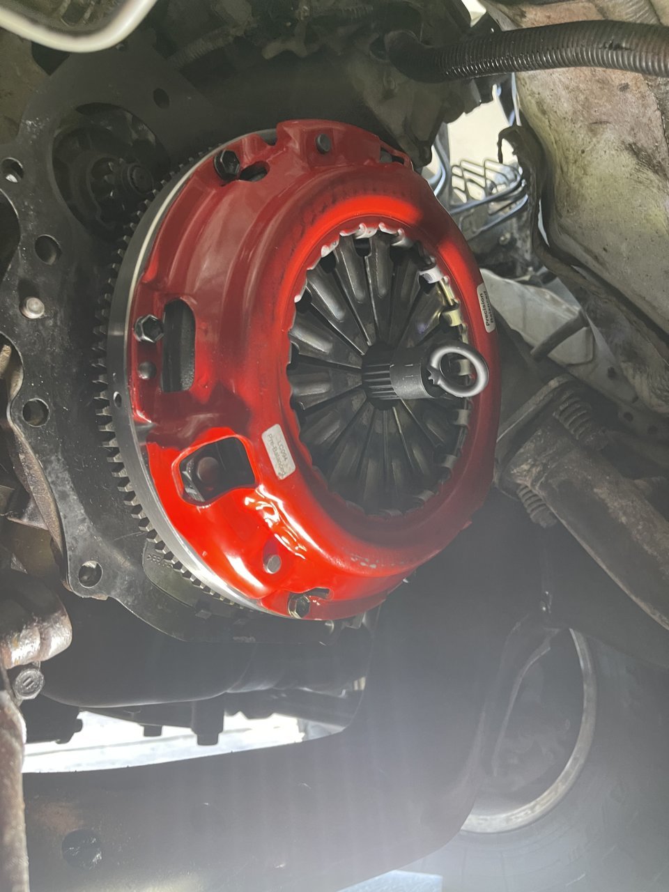

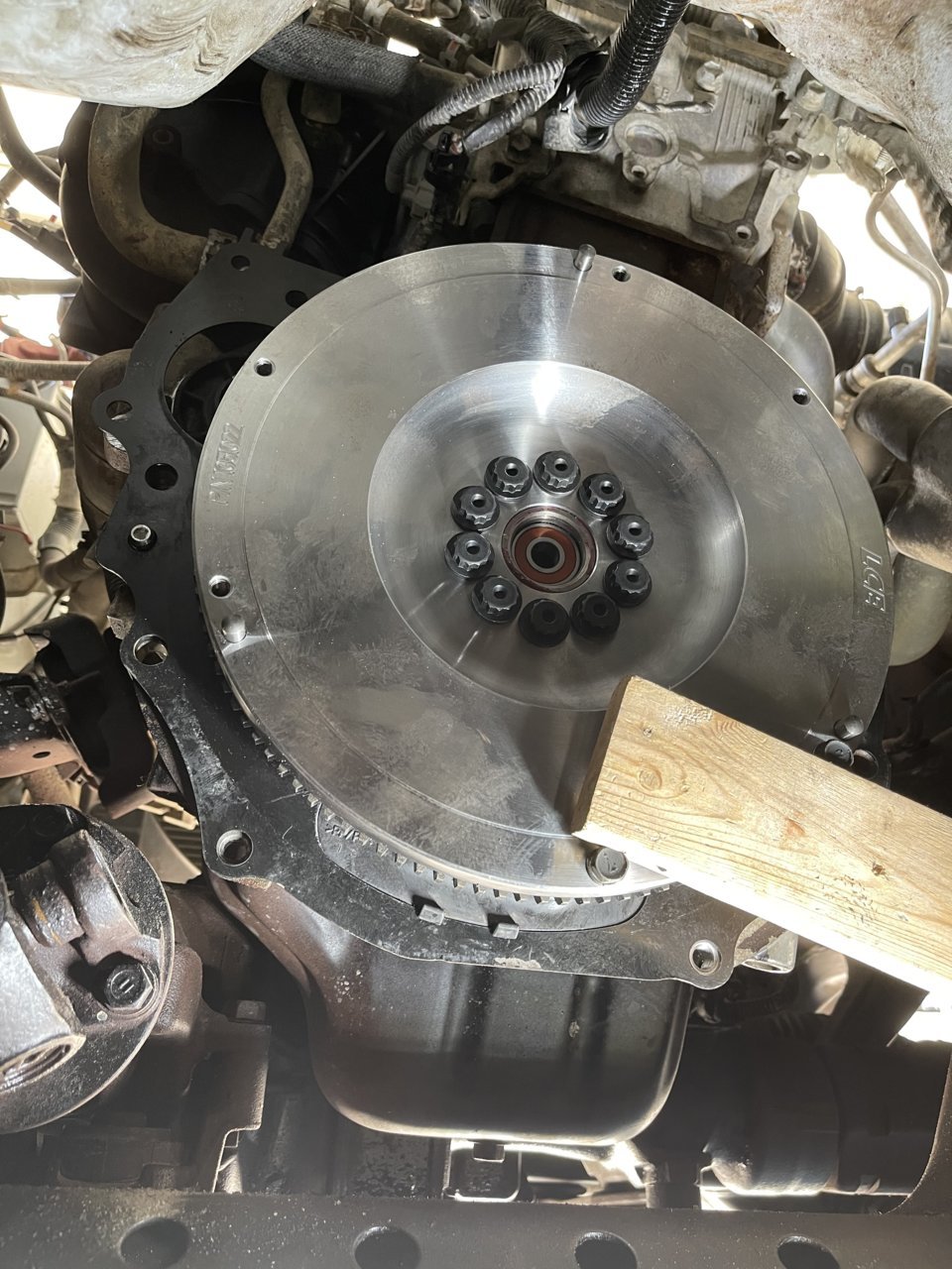

    I went with the LCE Pro clutch and a their heavy flywheel. So far I’m very happy with that setup. I towed my boat today and for once my truck really pulled well. I also lightened up my tires going with Toyo AT3 235/85 R16 tires, I think that helped a lot.

    Awesome, looks like a nice setup! I am running their lightweight flywheel and i really like it. Does the heavy version help a lot when taking off while towing? that's my only complaint with the lightweight one. Takes a little more throttle input to get going without stalling it out. I bet the lighter tires did help some. I went with a lighter but taller tire this time around, and i was expecting it to be more sluggish, but it feels about the same

    Towing, I barely have to give gas to get into 1st gear. Just as long as I don’t dump the clutch. I do use the e brake when pulling my boat out the launch so I do feather the gas as I let up the ebrake.

    That sounds like a great combo for a heavy truck or if you tow some. Is the clutch pretty grabby or is it pretty easy to slip? I had the LCE dual comp clutch and that bad boy was like an on off switch lol

    I swapped in one of the LCE clutches, on a friend's truck. A puck one, but went with the lightweight flywheel, as it already had the heavy flywheel. Pleasing response. The clutch that was on there was nearly worn out.

    It’s a bit grabby if I let up really fast, but not a on off switch if I’m letting up moderately.
    I think 300 ft lbs
