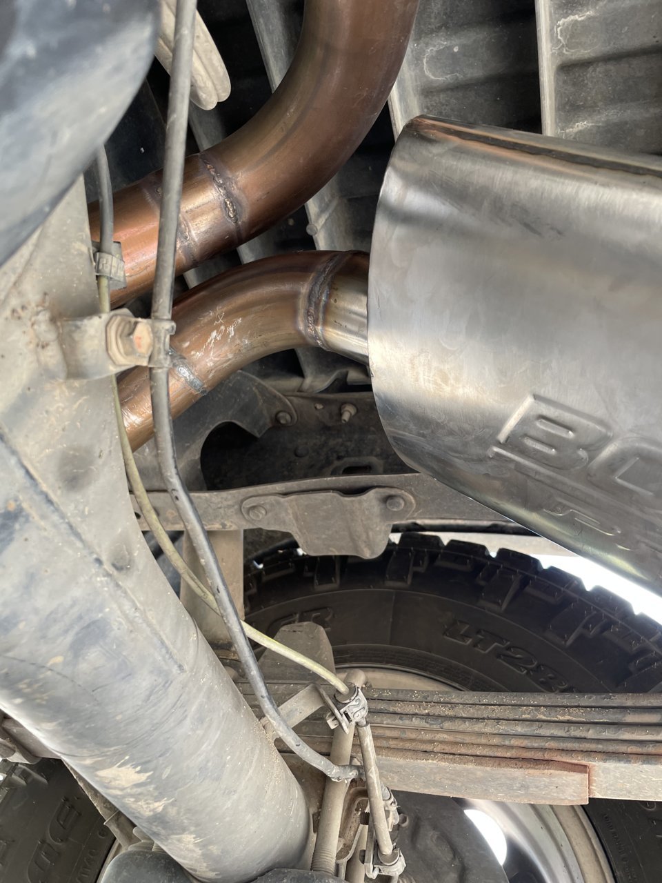

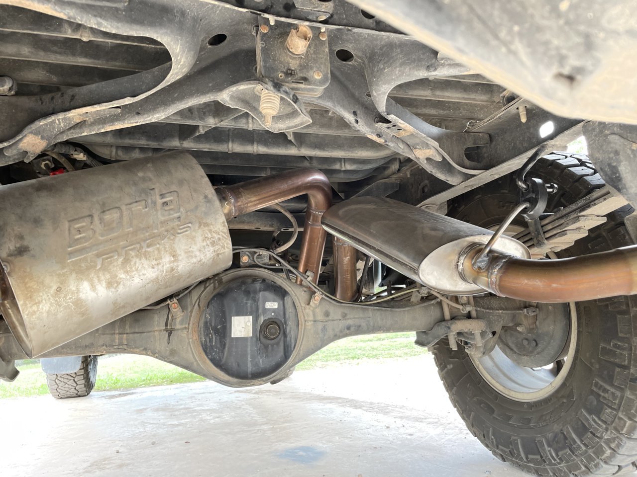

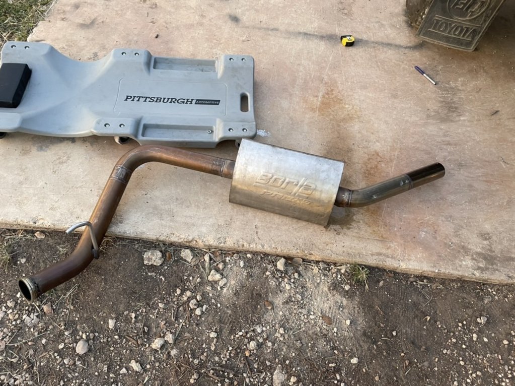

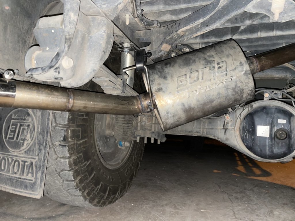

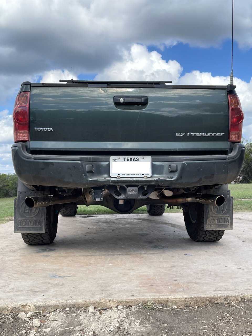

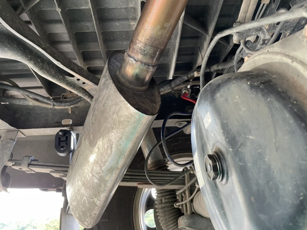

    Got finished up with the passenger side tail pipe today and it sounds way better now. Had to cut and rotate the top section and then fit a muffler on that while keeping clearance around everything. Finally I found the sweet spot that would work with the bends I have to make the exit work too. I also built an exhaust hanger and welded a ~2” extension on to make the tail pipes roughly the same length. Pretty happy with how it turned out! I think it sounds better than my old 2.5” exhaust
    ABB854D2-9B90-44BF-B93D-FD38E656EB7D.jpg 798062E3-10F7-4C7B-AC1F-04FB9C05A131.jpg 548DCF08-7538-4456-A453-F22BE4169322.jpg
    Before w/ vibrant resonator & 3" borla muffler:
    https://youtu.be/6gRhRhWudbs
    After w/ vibrant resonator, 3" borla, & two 2.5" borlas (one in each tail pipe):
    https://m.youtube.com/watch?v=ufiBHPeRW4g&feature=youtu.be

    Thanks buddy, I’m really pleased with it. Yeah it sounds way better at idle and cruise now too. Just getting the volume under control cleaned up a lot of the raspiness throughout a lot of the rev range.

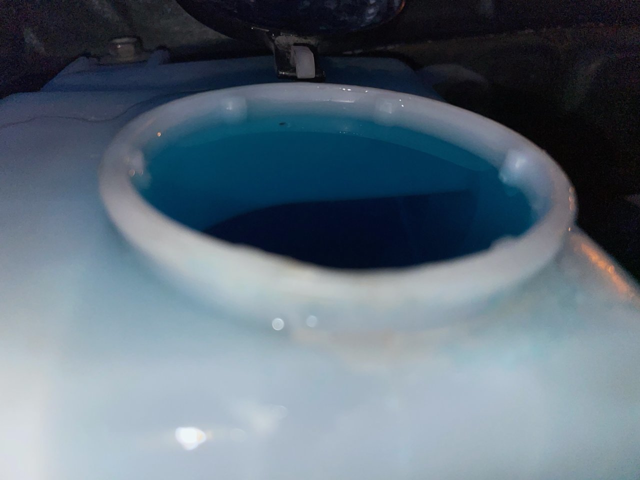

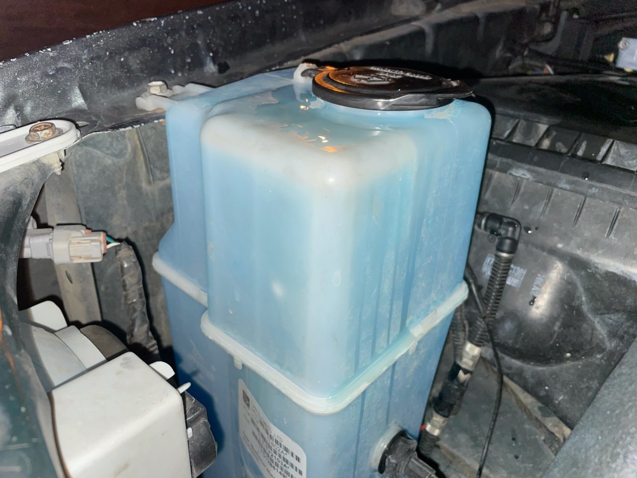

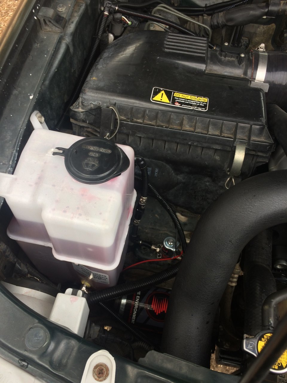

    Did some reading yesterday and saw where someone with a 3rd gen drilled a hole in their washer reservoir to get a little more capacity. Well i thought that was a great idea since i use mine for water/methanol, so i did the same yesterday. Takes a little bit more now to fill it up. Great little free mod. Will have to do it to the v6 this weekend as well.
    Full before
    and after
    And the area where i drilled the hole. A little difficult to see, but its right near the top below the lip for the cap

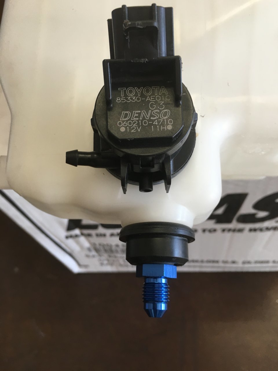

    Ok fess up I’m guessing it’s the little hole we see next to the hing for the cap? With size 1/16” or ?…
    I mounted my drain as low as I could get it then used a 12x1.25 to 4AN fitting at the bottom of the washer fluid tank.
