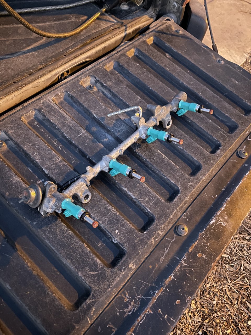

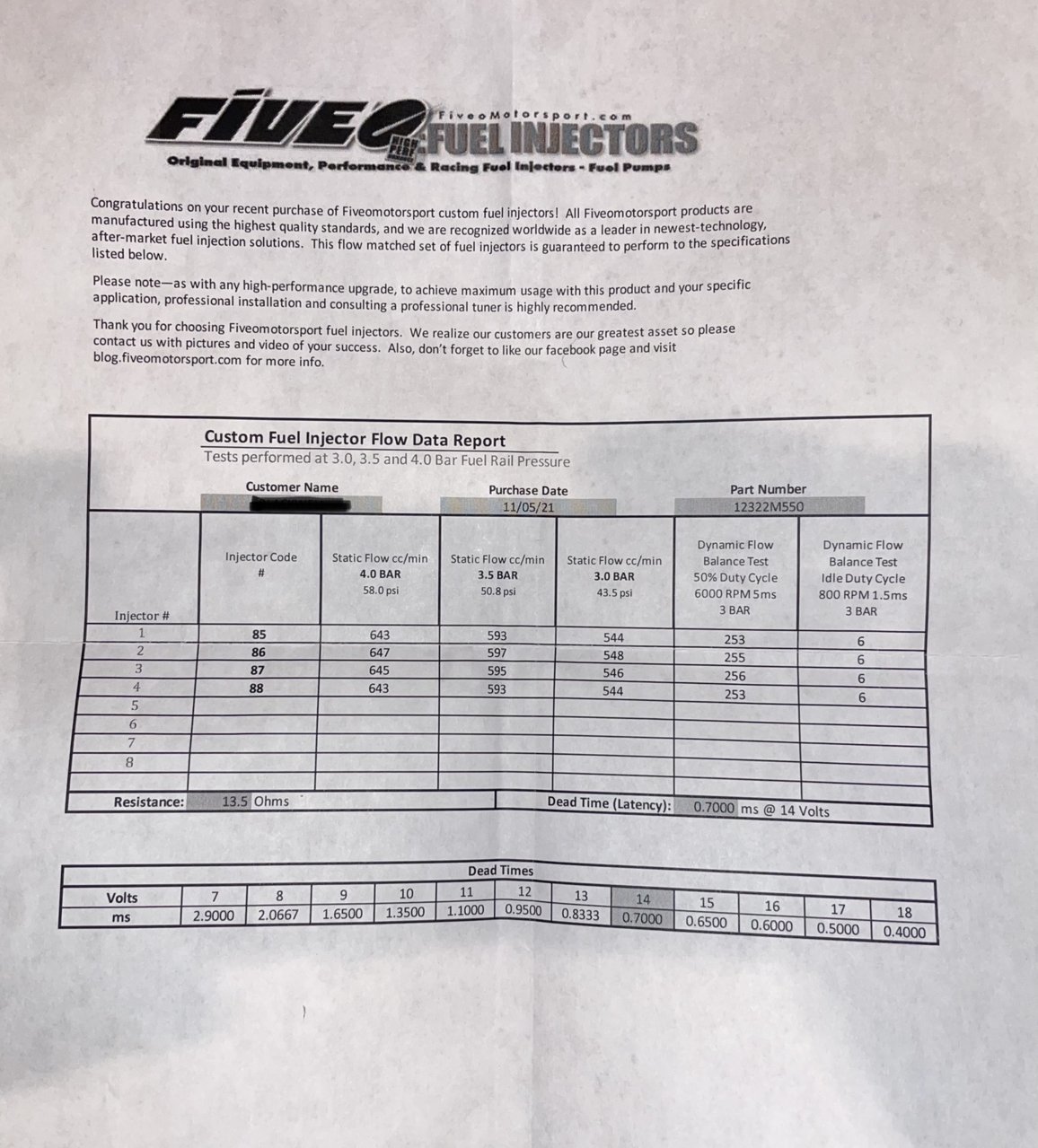

    Swapped fuel rails and injectors tonight. These are plug and play 550cc flow matched injectors from FiveOMotorsports. The truck is idling grossly rich even at idle, so thats where im going to start with the tuning and then go from there and rework most of the fueling tables. These combined with the 840cc 5th injector should be more than enough fuel for what im going to do, and the truck is one step closer to being ready for the 7163:D

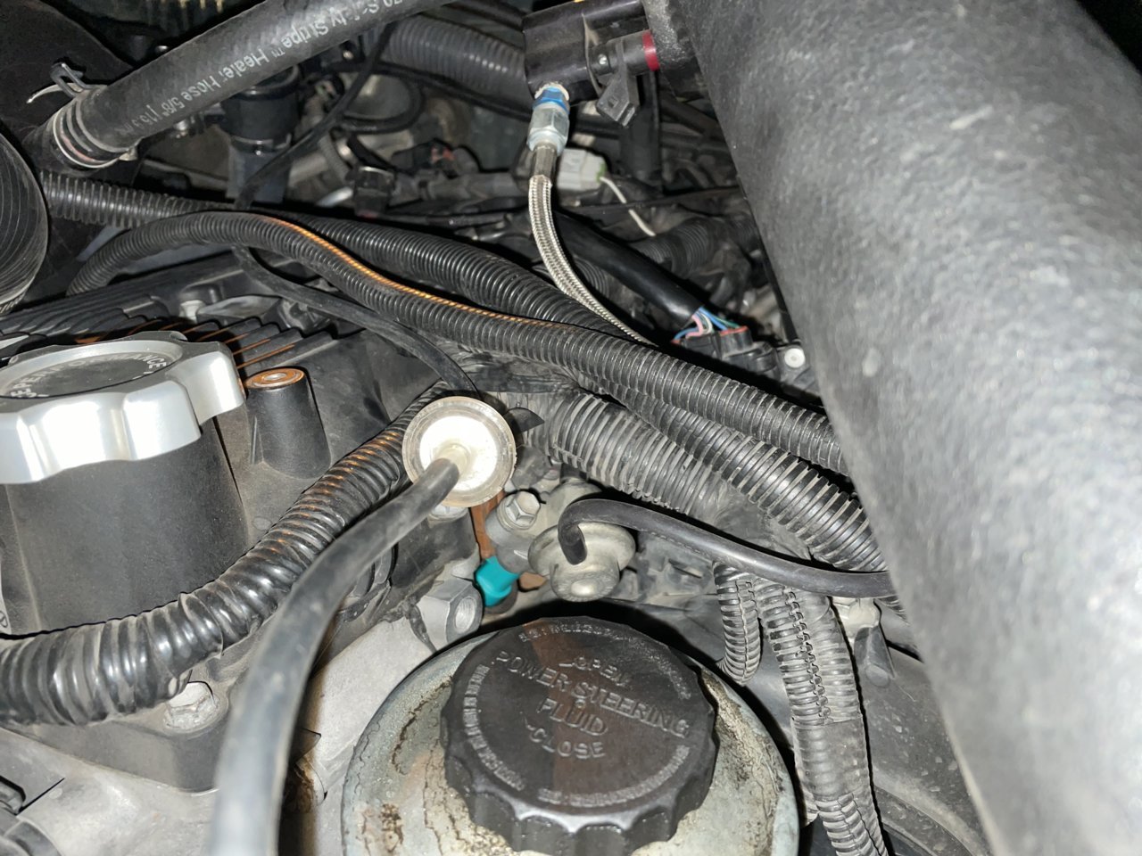

    I should be able to get my fuel table up for you today. Mine requires that your fuel pressure regulator line be plugged into your manifold.
    BassAckwards[OP] and Torspd like this.

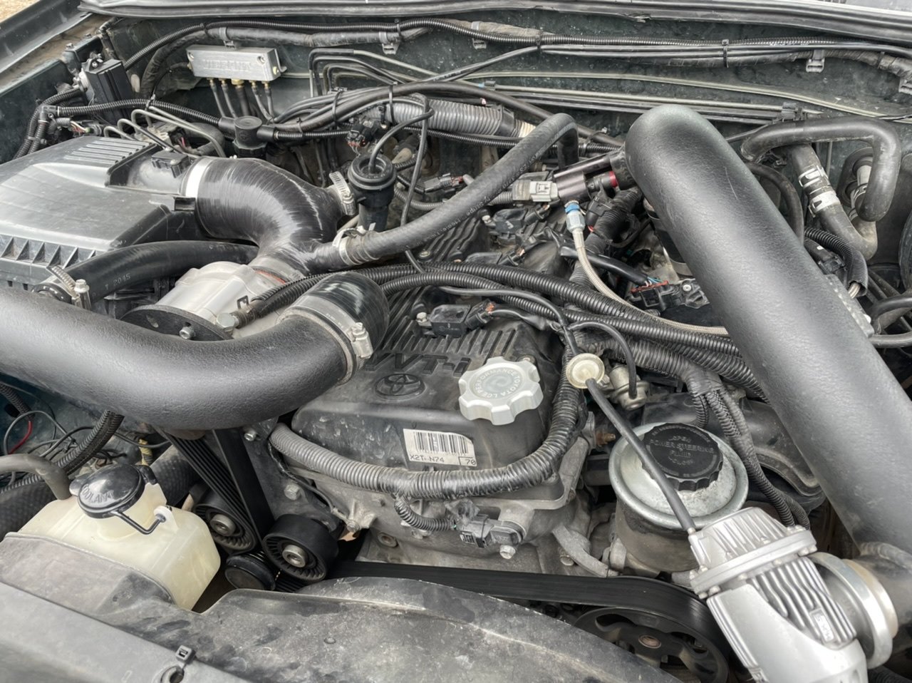

    Looking at the picture above, his looks like it is routed from the charge pipe.
    Which makes me realize that I need to reroute the line on my friend's truck.

    Would this essentially mean it's boost referenced? If so, we're good there
    MadTaco461[QUOTED] likes this.
  10. Jan 22, 2022 at 8:17 AM
    #3230
    BassAckwards
    BassAckwards [OP] Well-Known Member
    May 3, 2016
    #186002
    27,954
    2009 Tacoma AWD Turbo 2TR-FE
    Full-time AWD & BorgWarner EFR 6258
    This is correct it's on the driver side charge pipe

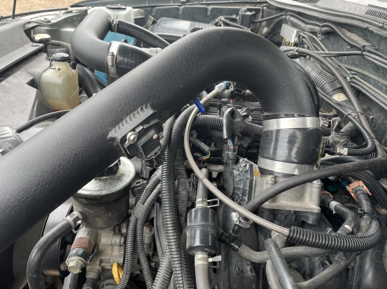

    So it sounds like i could just cap the driver charge pipe and run a new line from the regulator over to my vacuum block and i'd be in good shape since that's hooked directly to the manifold. And then that would help lower the fuel pressure and help it not run so rich in vacuum/low loads?
    Is the reason the charge pipe not seeing vacuum because it's before the throttle body? I am trying to wrap my head around this and i think the light bulb came on lol. When i hooked up my water methanol you have to put the nozzle before the throttle body because it will siphon it out if it sees vacuum (ie post-TB).

    Tee’d into the bov since thats right by the fpr and i didnt have the 1/8npt fitting needed to add a port to my vacuum block.

    Alright so i went back to my base tune and pulled 35% fuel from the primary and secondary fuel tables. The new injectors are 58% larger roughly and dropping the fuel pressure by about 22% is how i came to the 35% figure to start. I also went back and adjusted the afr adjust table a little bit to make the ecu a little happier. It seems to be running better already, so hopefully things will improve from here with a few more revisions and once i can compare. Short term fuel trims are already way way better
