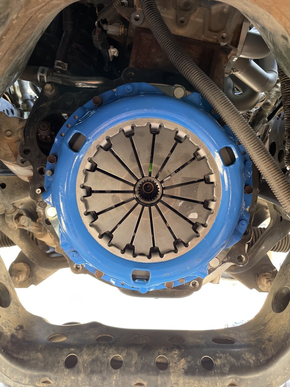

    Haha well the stock rated LUK clutch fought the good fight, but started slipping badly this morning. Mainly when the boost spikes to like 10lbs on throttle tip in. So that was a total of 50 miles since the turbo went on. Today I installed an M-Pact brand clutch off of rock auto. The pressure plate on this has 2200lbs clamping force, but still uses an organic disk, so we’ll see how that goes. It’s supposed to be rated for 100-150% increase in tq capacity.28B3198A-C8FE-49D1-B721-874084FD3E4D.jpg

    10 lbs⁉️ WTF :confused: I thought you said you were going to take it easy like 7 lbs max or something to that effect?
    IDK now but when LCE had the Haltech installed and turned they turned it where I’ve only seen just a tad over 7 lbs now. When I saw over 10 lbs before and honestly that made me a bit nervous. :notsure:

    Yeah i didn’t really want 10 lbs but it literally spools so fast that the wastegate can’t keep up with it haha. If I get on the gas quick it will hit 10-11lbs and then once the waste gate catches up and opens it holds at 7-8 lbs. i have the 5lb spring in it. I may check and see if turbosmart offers a 3lb spring so maybe I can lower it down a little
    Is it possible they put a larger sc pulley on?
