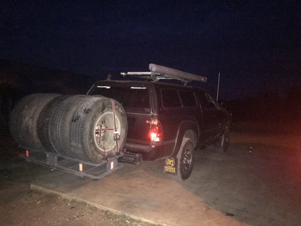

    Heres a pic recently when i had the truck loaded down to go get tires installed. I had five wheels and tires on a 50lb cargo basket, four more tires in my camper shell (about 265lbs worth of new tires), and then all the normal weight i have on the truck, which is about 500lbs out back with the camper shell, tools, and other gear. I aired those bad boys up and i was on my way lol. The truck was struggling, but i was sitting level

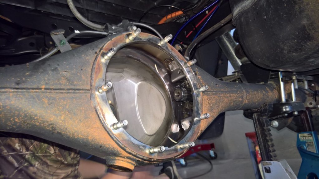

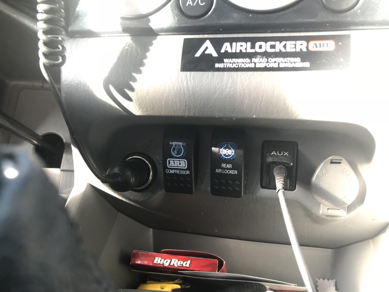

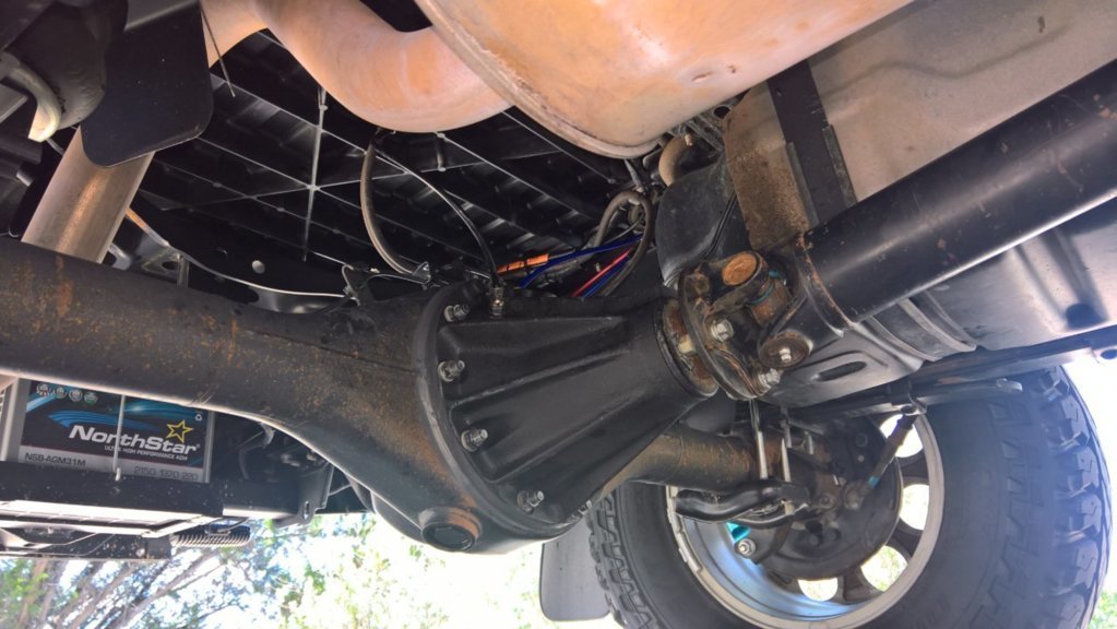

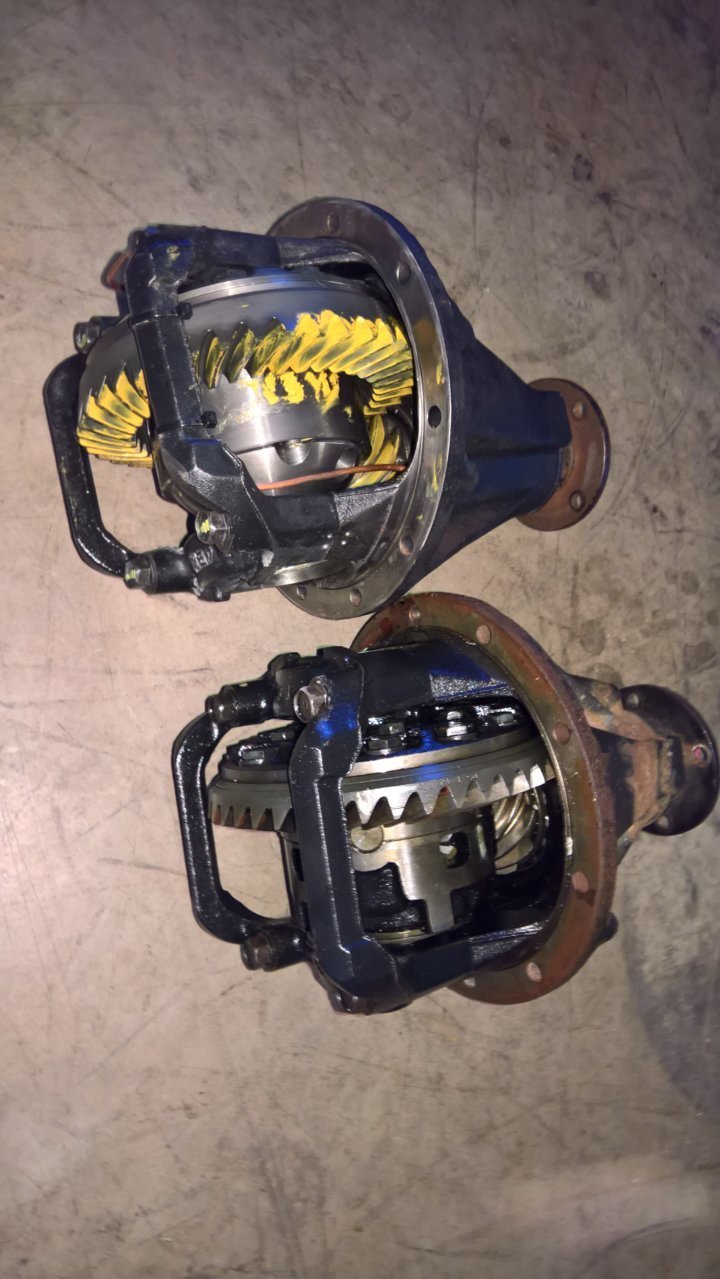

    A few updates finally. VLEDs is going to warranty my blinkers, so im going to have those in the mail to install tomorrow!:D
    Last week, wired up and plumbed my ARB twin compressor, manifold, and ran the switches into the cab.
    This weekend, regeared with 4.88s and added an ARB RD129 locker. Did some fitment for the switches underneath the radio today and finally got them in place.
    While trying to track down metal-on-metal clanking/clattering noises this weekend, i ended up tightening all my ubolts which were loose after i got my recall springs installed, and pulled the driveshaft and replaced the ujoint near the carrier bearing which was bad. That should solve the driveline vibes ive been having at 45-50mph.
    Ive got about 280 miles on the new gears so far and couldnt be happier. Truck has plenty of power now, and i can finally use fifth gear again.
