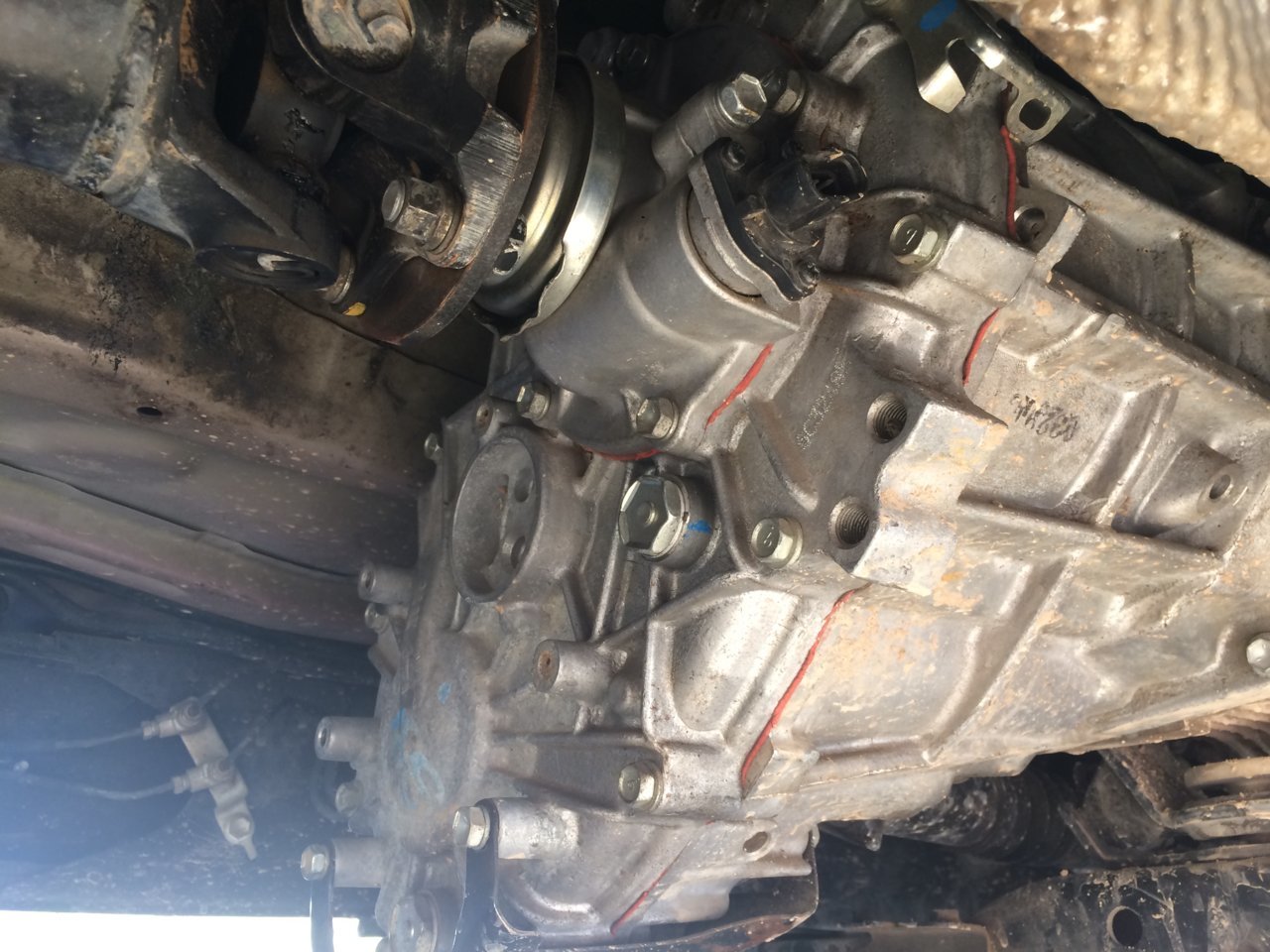

    Looks like t case for the 6 speed

    Interesting, it must be some sort of gear driven thing or it uses that worm gear. It's not like my 5spd that had a nylon gear for the speedo which had me a little confused

    @BassAckwards that sensor on the back of the t-case is for the vehicle speed. some used that sensor others use the wheel speed from the abs unit. if you look you can find a plug that will bolt right in there. one of the t-cases i have came with it.

    Thanks for the info, i think i know which plug you're talking about. my auto case had a blank metal piece where this one has the speed sensor

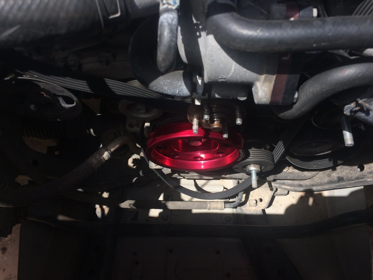

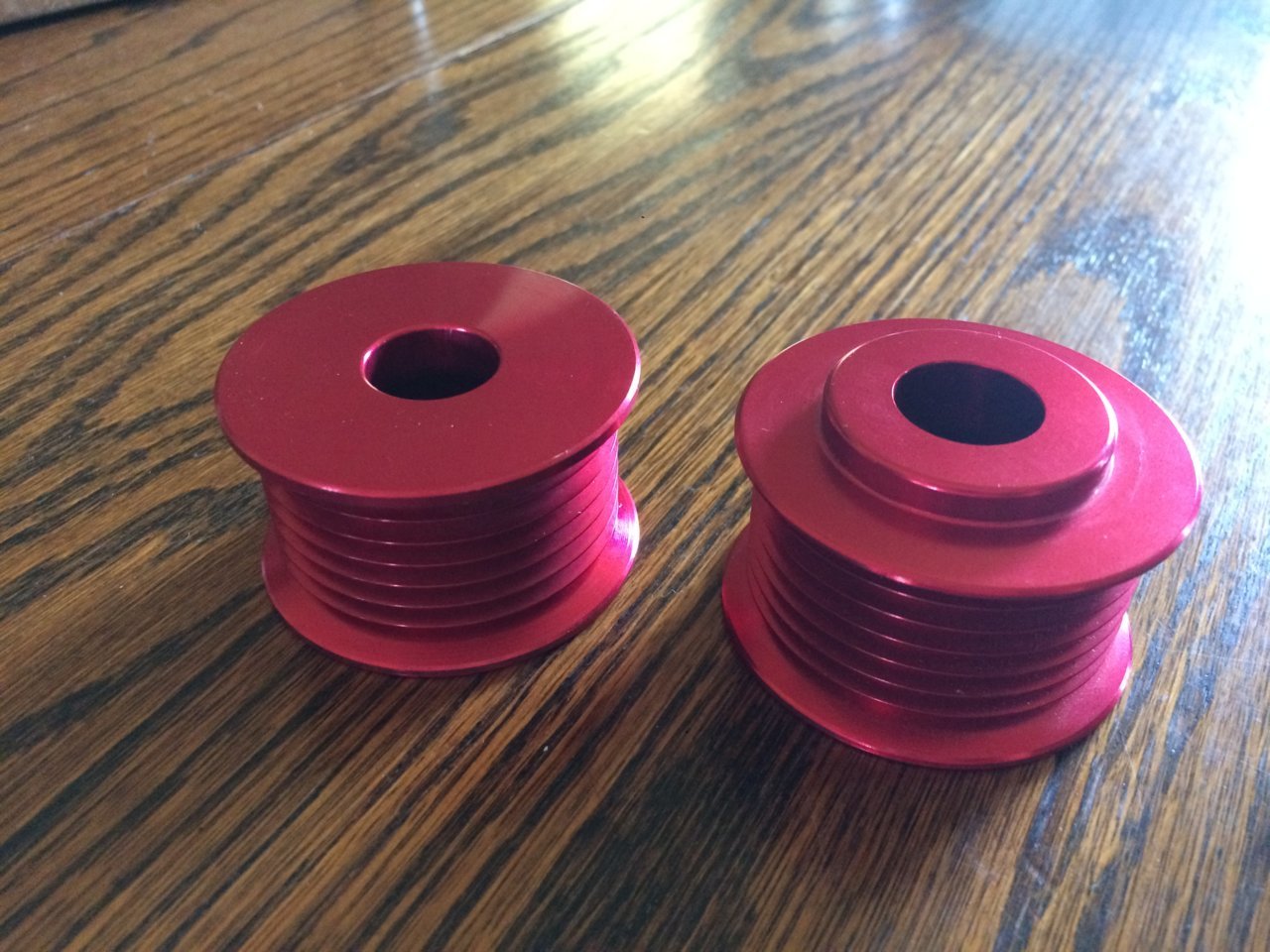

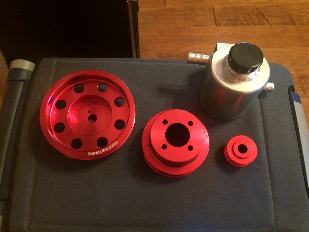

    Got the NST SC and water pump pullies installed yesterday. I tried to get the stock alternator pulley off the truck but its seized on there, so that was a flop. I have a stepped NST alternator pulley but im not sure which one i need, so i bought a flat one from mightytacoman yesterday so i can get the old one off and know ill have the right one to replace it. Also installed the gen 2 mightytacoman coolant reservoir, leaving it bare for now.

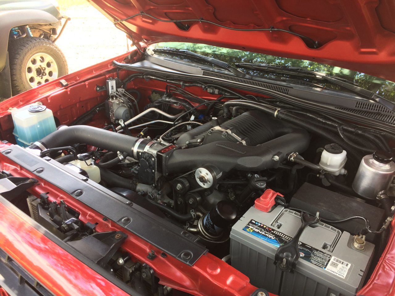

    Washed the truck today and cleaned up the engine bay some too. Also, got the extra NST alternator pulley in the mail that i found used, so i am planning to go to war with the stock one next weekend. Planning on relocating the snow controller to the little cubby on the driver side to clean that mess up.

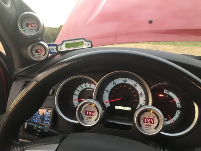

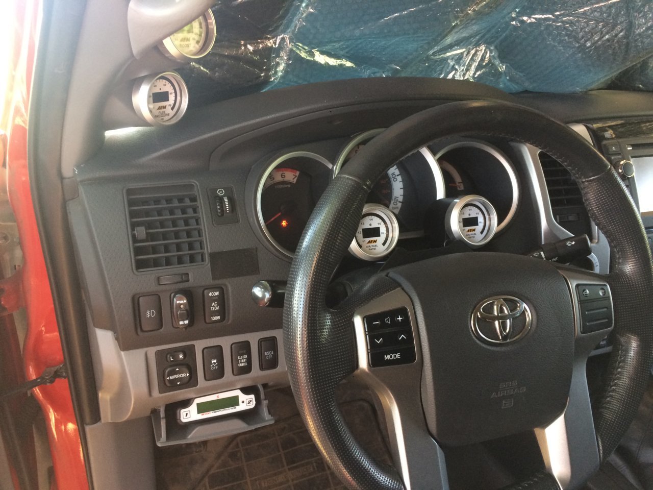

    Relocated my water meth controller to the coin tray today. Pretty happy with how it turned out, it looked out of place on top of the dash and with that wire running out in the open

    Looks way cleaner! That controller does have an odd shape and size to deal with. What kind of parameters does it show?
