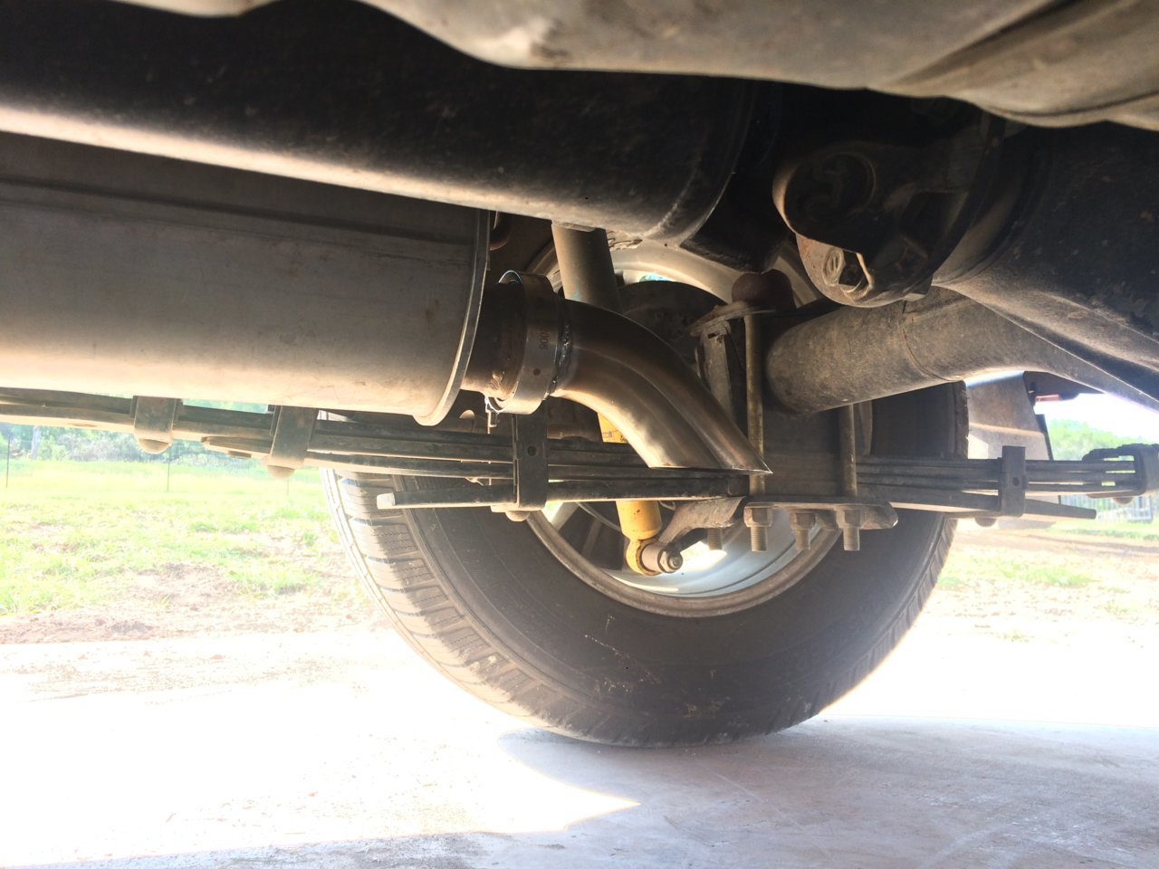

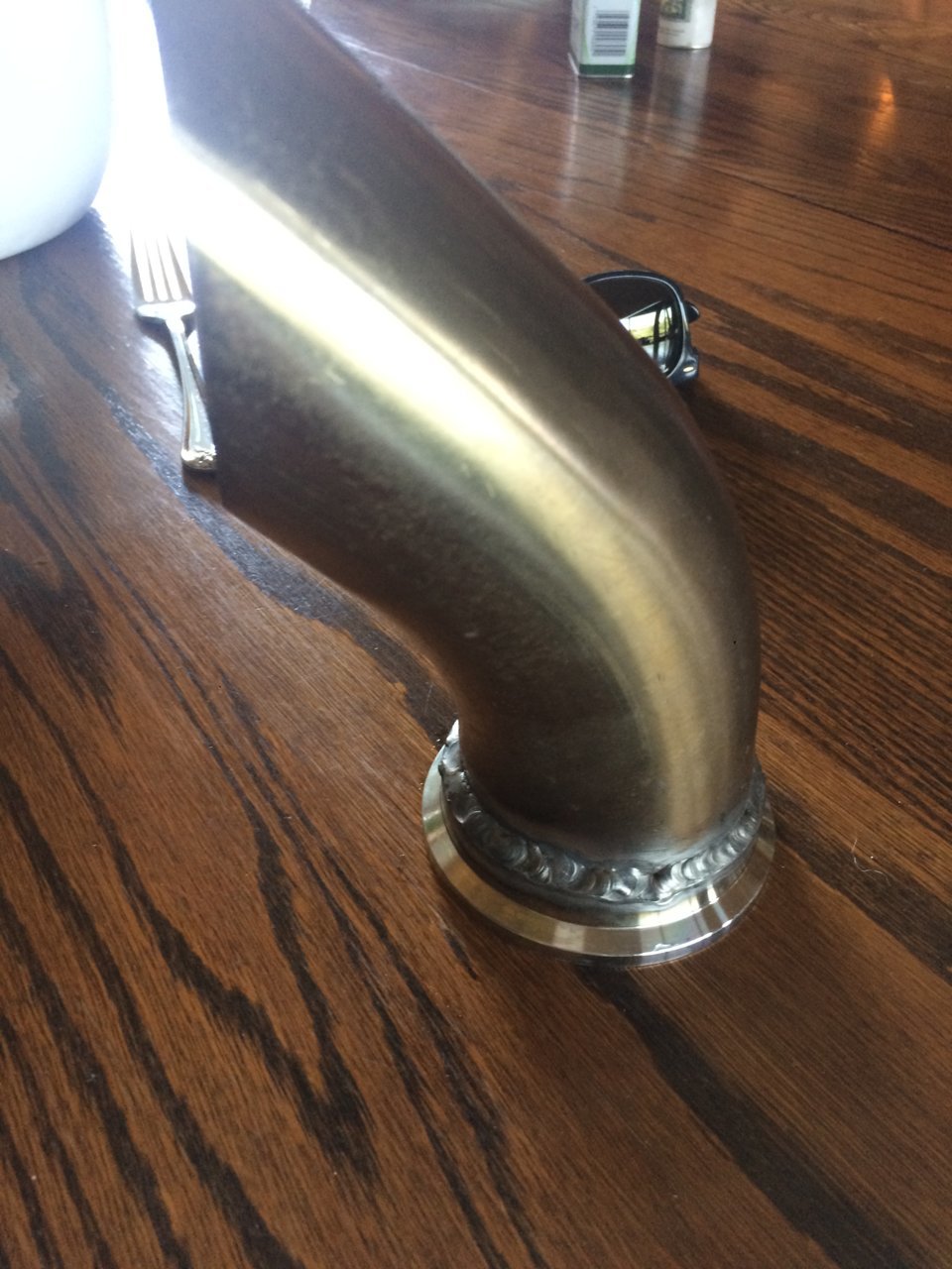

    Added a v-band to a turn down tip this morning and made it where i can run the TRD catback with my x-runner rear sway bar.

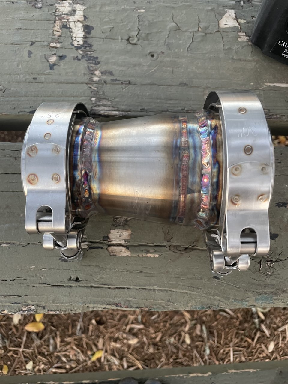

    Built this for the exhaust last weekend. I originally had another one but used it when I built my 2.7L exhaust a few months back so I needed another for this truck. Basically it’s a 3” to 2.5” transition to adapt the y-pipe 3” collector to the 2.5” TRD catback. The one i originally had on the truck was a little longer than the transition that i bought, so I cut a piece of tubing and extended it about 3/4” on the 3” side. Then I added some v-band flanges so it would mate up to the y-pipe and exhaust.
