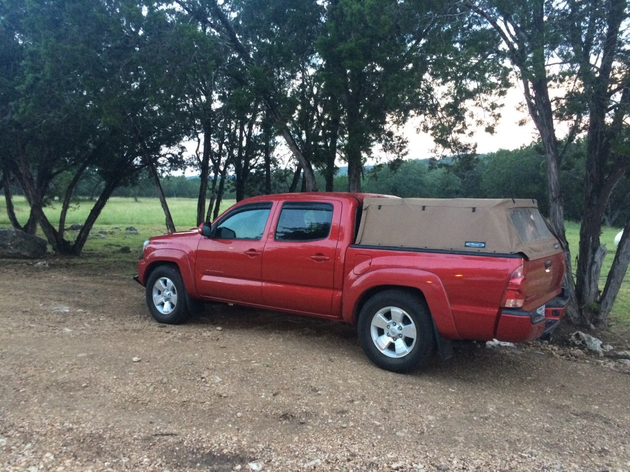

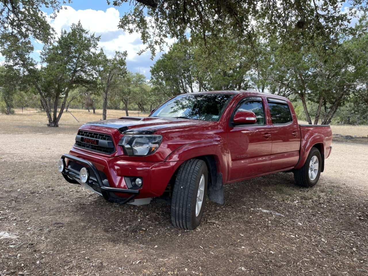

    Thanks man, here are a couple from a while back. Imo the lowered trucks really look better with a nice set of wheels. I’m still saving my pennies for those though lol

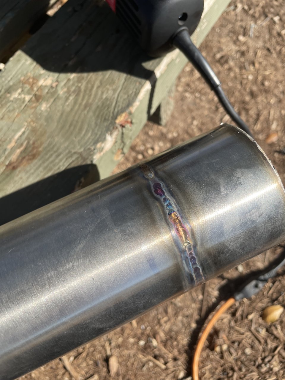

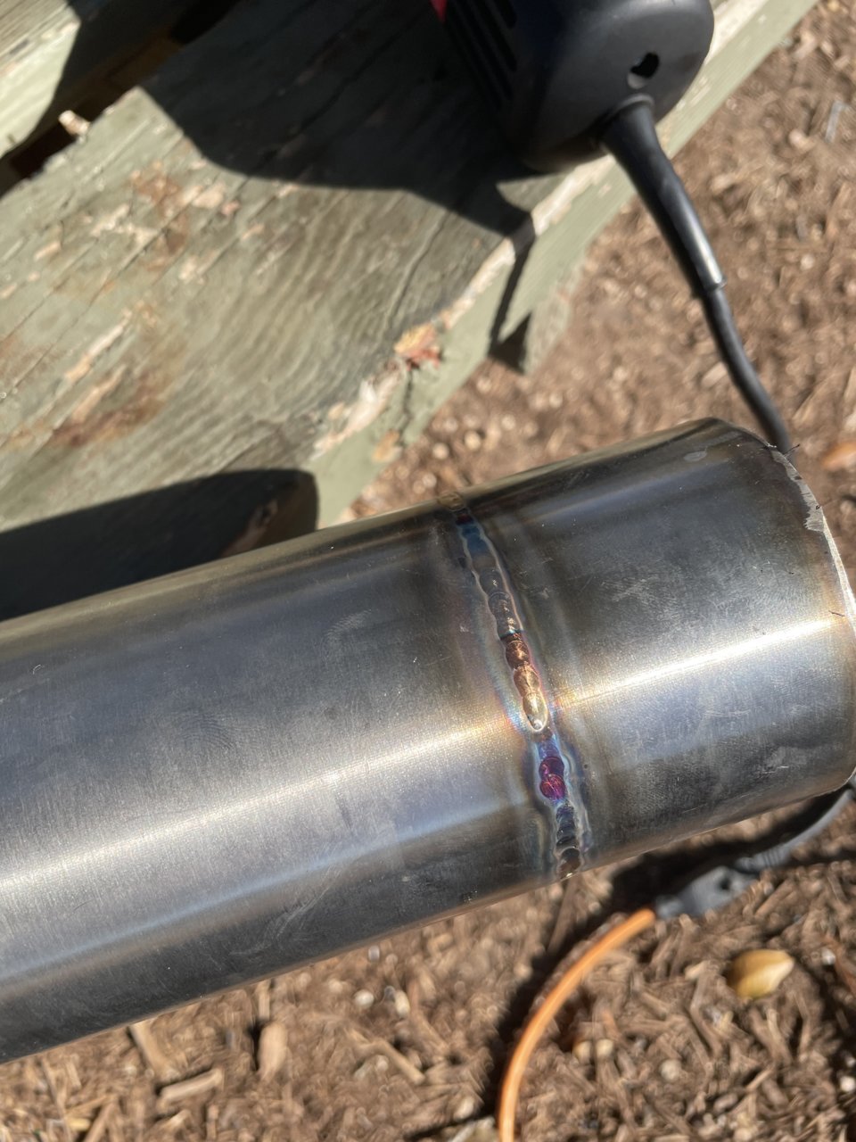

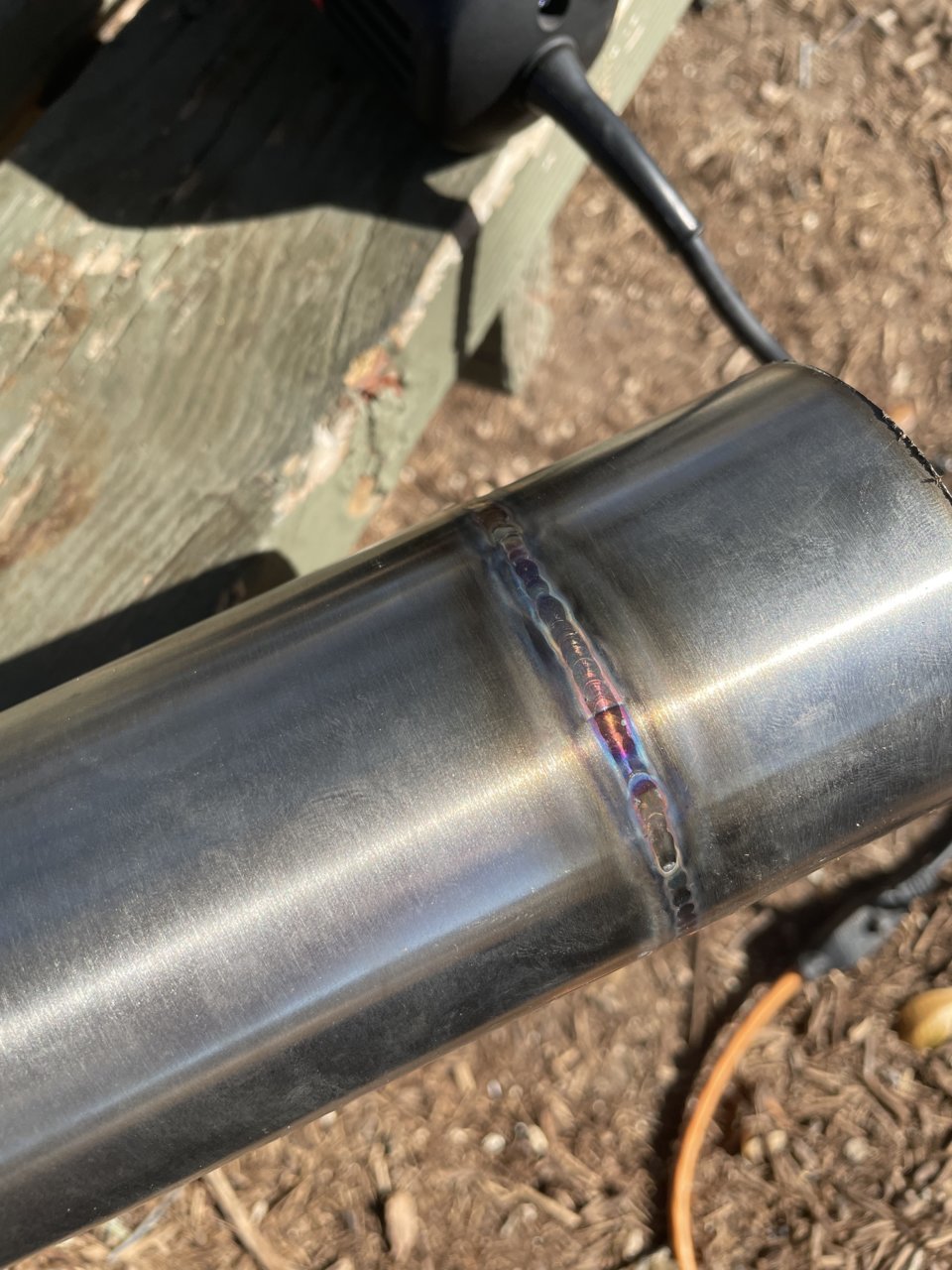

    Got a gas lens setup and #12 cup per @Torspd ‘s recommendation and tried it out yesterday. Night and day difference in weld quality. Should have done this a long time ago. Here are a few pics from the first weld i laid down with it. Definitely need a big cup for stainless, makes things way easier. This was on 16 gauge tubing for reference

  4. Apr 8, 2022 at 12:41 PM
    #64
    Torspd
    Torspd Tor-nication
    Sep 18, 2009
    #22958
    26,446
    Tor
    The Great America!
    MMVI 4.4L 4x4 Access Cab
    Torspd Custom Turbo kit [] Borg Warner 9180EFR Turbo [] Haltech Elite 2500 [] TiAL Q BOV [] TiAL V44 Wastegate @ 15psi [] CP Pistons [] CP Carrillo Rods [] ARP Head studs [] ARP Main Studs [] ARP Header - Head Studs [] Ported Heads w/ 1mm oversized valves intake/exhaust [] Brian Crower Forged Stroker Crank [] Darton M.I.D. Sleeved Block [] Kelford Camshafts [] Torspd 160* T-stat mod [] APR Large Fuel Rail [] Walbro 460 LPH E85 Fuel Pump [] FueLab FPR [] APR T56 Conversion Kit [] KP RACING Built T56 [] McLeod Racing Custom Twin Disk Clutch [] One Piece Aluminum Driveshaft [] MGW Shifter [] Custom lowering kit [] Ohlins Front Coilovers [] QA1rear shocks [] Custom Ron Davis Radiator [] Dual SPAL Electric Fans []
    You've quite the steady hand. :welder:
    In just a short time, your welding has improved significantly. :thumbsup:
  5. Apr 8, 2022 at 1:43 PM
    #65
    BassAckwards
    BassAckwards [OP] Well-Known Member
    May 3, 2016
    #186002
    27,954
    2009 Tacoma AWD Turbo 2TR-FE
    Full-time AWD & BorgWarner EFR 6258
    Thanks man, I owe a lot of that improvement to you. Lots of good tips and tricks learned while watching you build my manifold.:hattip:

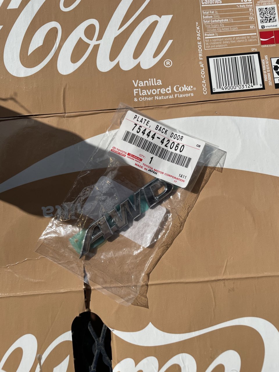

    Minor build update, finally got around to painting and clear coating the AWD badge I got for the truck. Started out as chrome, hit it with two coats of adhesion promoter, three coats base coat, and three coats of clear. In an effort to keep the badging in the Toyota family, this came from an AWD Toyota RAV4.

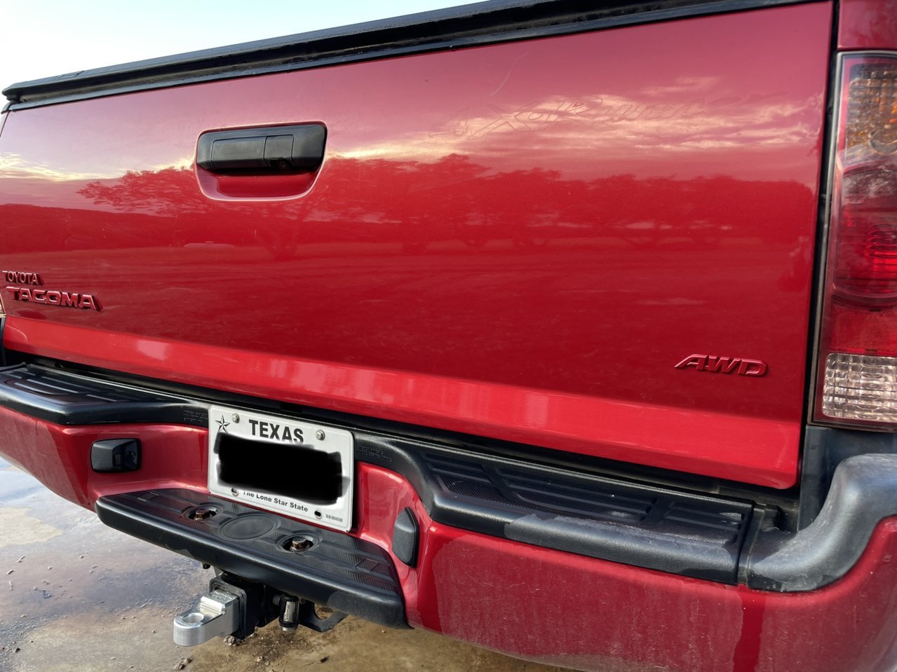

    I installed it on the truck today and put it in the same area as the V6 badge used to be.

  7. Oct 17, 2022 at 4:14 PM
    #67
    Torspd
    Torspd Tor-nication
    Sep 18, 2009
    #22958
    26,446
    Tor
    The Great America!
    Sick! Time for AWD donuts. :D

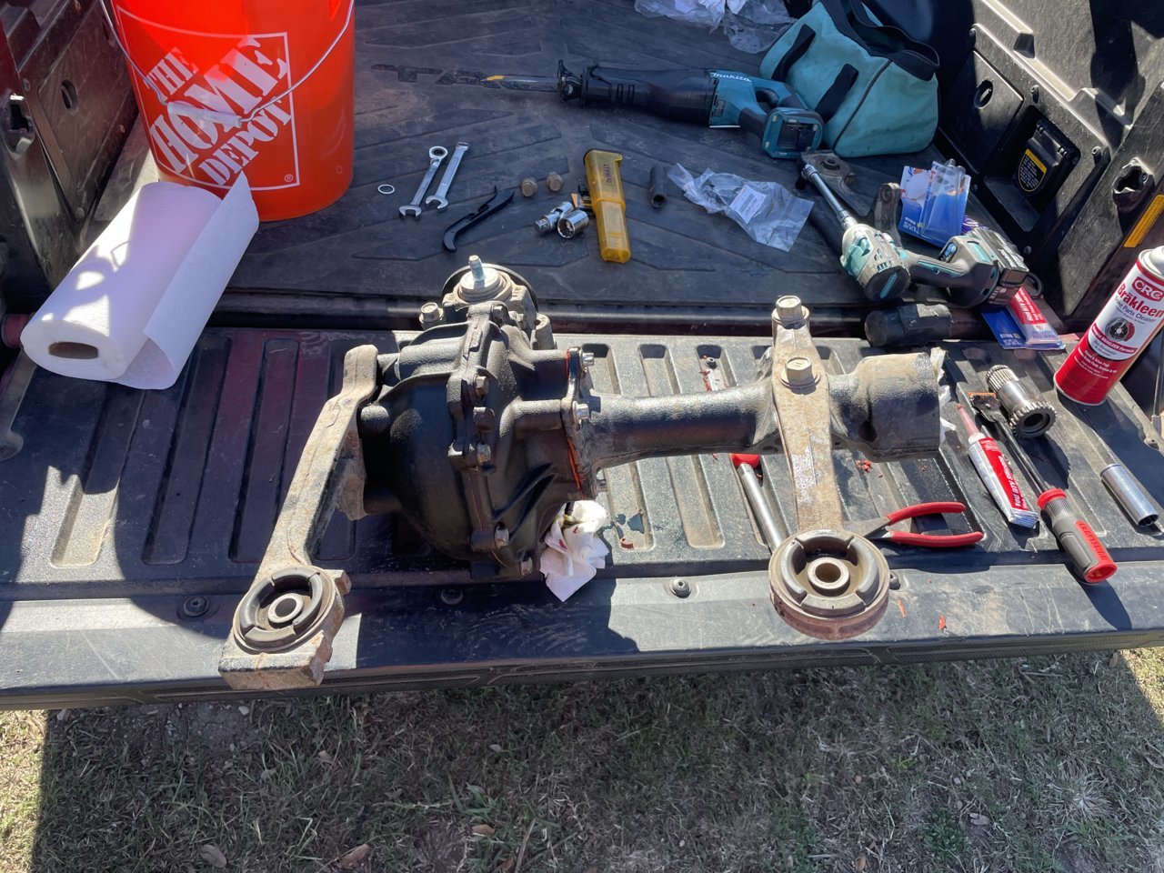

    Swapping back to 3.73s today so I can use the 4.10s out of this truck on my PreRunner for the AWD conversion. About to lift the front back into place and then it’s onto the rear. It’s my first time pulling CV’s so I’ve been taking it slow but it’s been pretty easy going so far.

  10. Dec 15, 2022 at 12:31 PM
    #70
    TodayWasTHeDaY
    TodayWasTHeDaY Hoser
    Jul 10, 2017
    #223673
    2,059
    Russ
    Calgary
    2015 DCSB SC M/T TRD Sport
    You've got some serious multitasking between two trucks and choosing the choice bits between them Hahaha!
    I get tired just watching what you're up to :rofl: :thumbsup:

  11. Dec 15, 2022 at 3:13 PM
    #71
    Torspd
    Torspd Tor-nication
    Sep 18, 2009
    #22958
    26,446
    Tor
    The Great America!
    PreRunner is going to love the 4:10's. The 2TR is now going to load up that turbo. :D

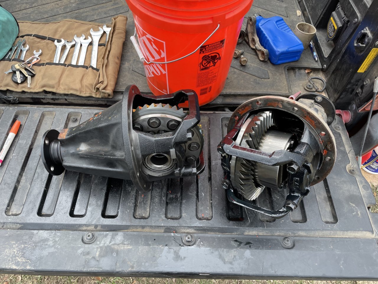

    Axles were hanging up while trying to remove it, but finally got it out with an extra set of hands. Time for cleanup and reassembly. This is a used housing/gears with all new Yukon bearings, solid pinion spacer, Detroit TrueTrac LSD, and an OEM pinion seal. Filled up the rear with 80w-90 & some 85w-140 I had on hand. The front diff got all 80w-90.

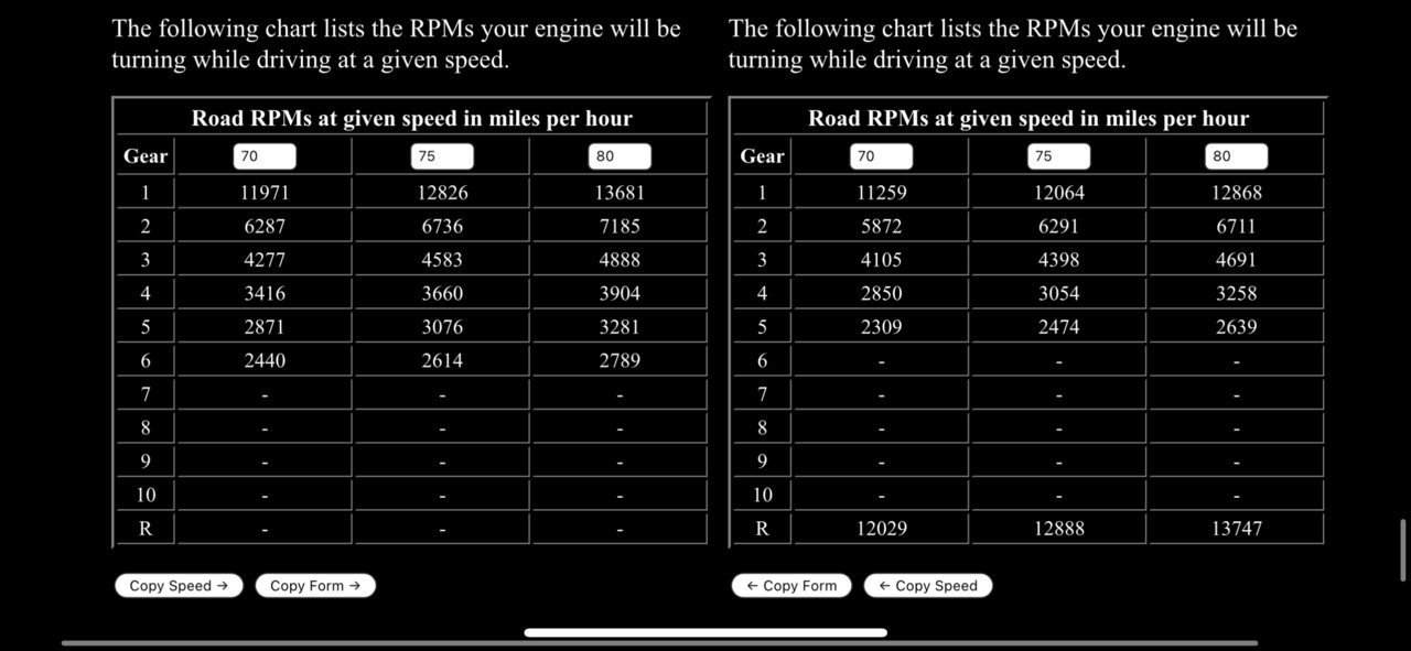

    All finished up on the regear. Also started tearing down for the PreRunner so I can hopefully get that knocked out quickly tomorrow, but I ran out of steam. Took the v6 for a quick drive and it turns about 2600rpm at 75mph now. It was at about 3k at 75mph with the 4.10s previously
    here’s a comparison of the two trucks with the new gears, and the rpms they will turn at hwy speeds. This is with 30.5” tires on the v6 and 33.8” tires on the 2.7L. Pretty close overall, especially in 5th gear & 4th gear (1:1 on both trucks)

  15. Dec 19, 2022 at 7:14 AM
    #75
    Torspd
    Torspd Tor-nication
    Sep 18, 2009
    #22958
    26,446
    Tor
    The Great America!
    So they have similar rpms per speed, but do the feel similar, when driven?
  16. Dec 19, 2022 at 7:25 AM
    #76
    BassAckwards
    May 3, 2016
    #186002
    27,954
    They feel pretty similar but the 4 cylinder seems to require a bit more throttle input or a downshift vs before. The drivability is still way better than i was expecting with the larger tires and stock gears. I have driven the 4 cylinder with stock gears and 33s, and 5th gear was absolutely unusable and drivability was way worse. I am very happy with how it performs now, and it's looking like gas mileage may increase a bit as well, so that's a bonus. It does feel like the 4 cylinder is getting put under more load now during regular driving conditions, which is to be expected.
    TodayWasTHeDaY likes this.
