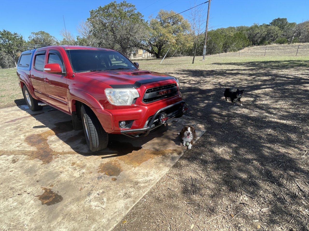

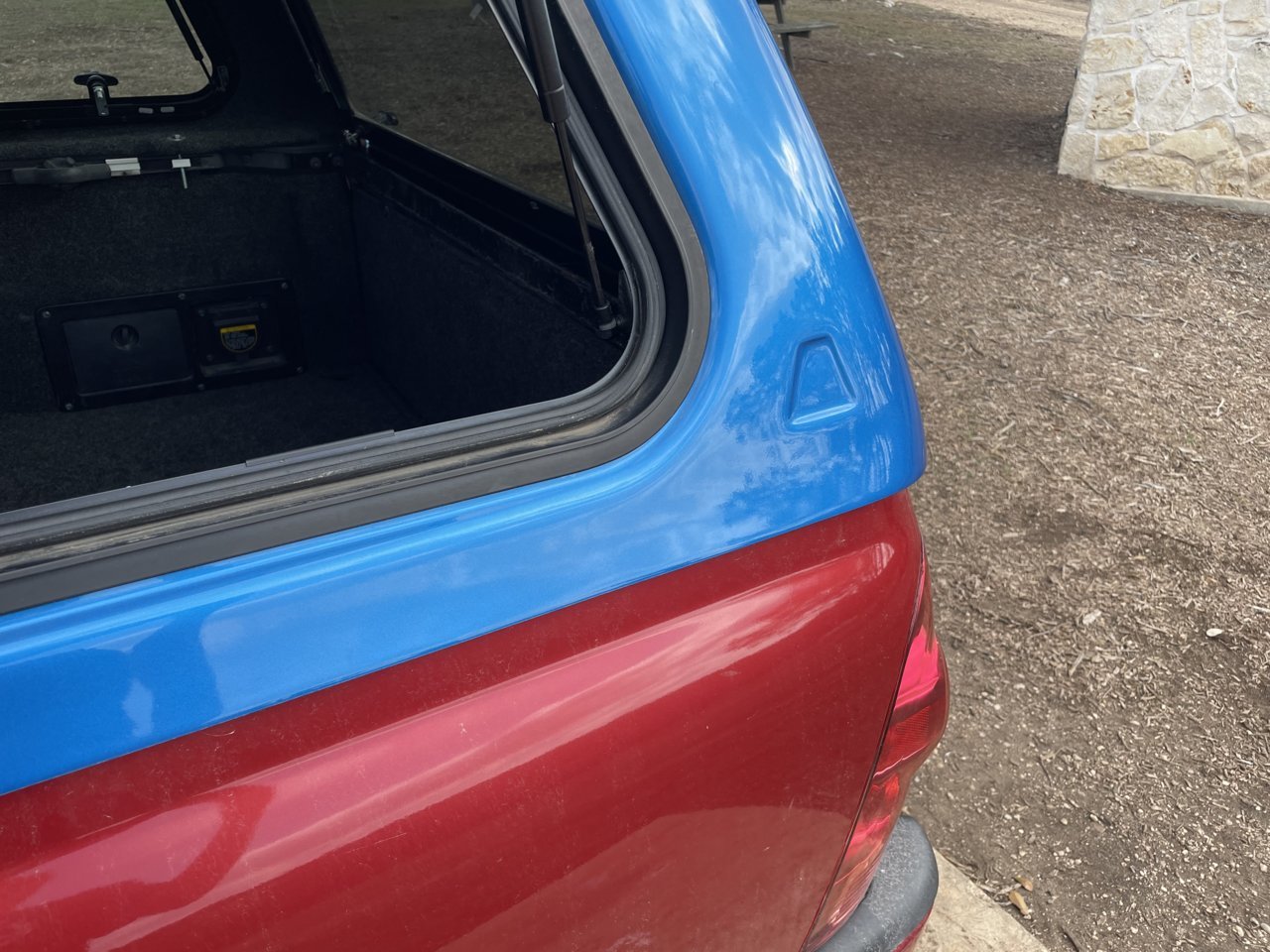

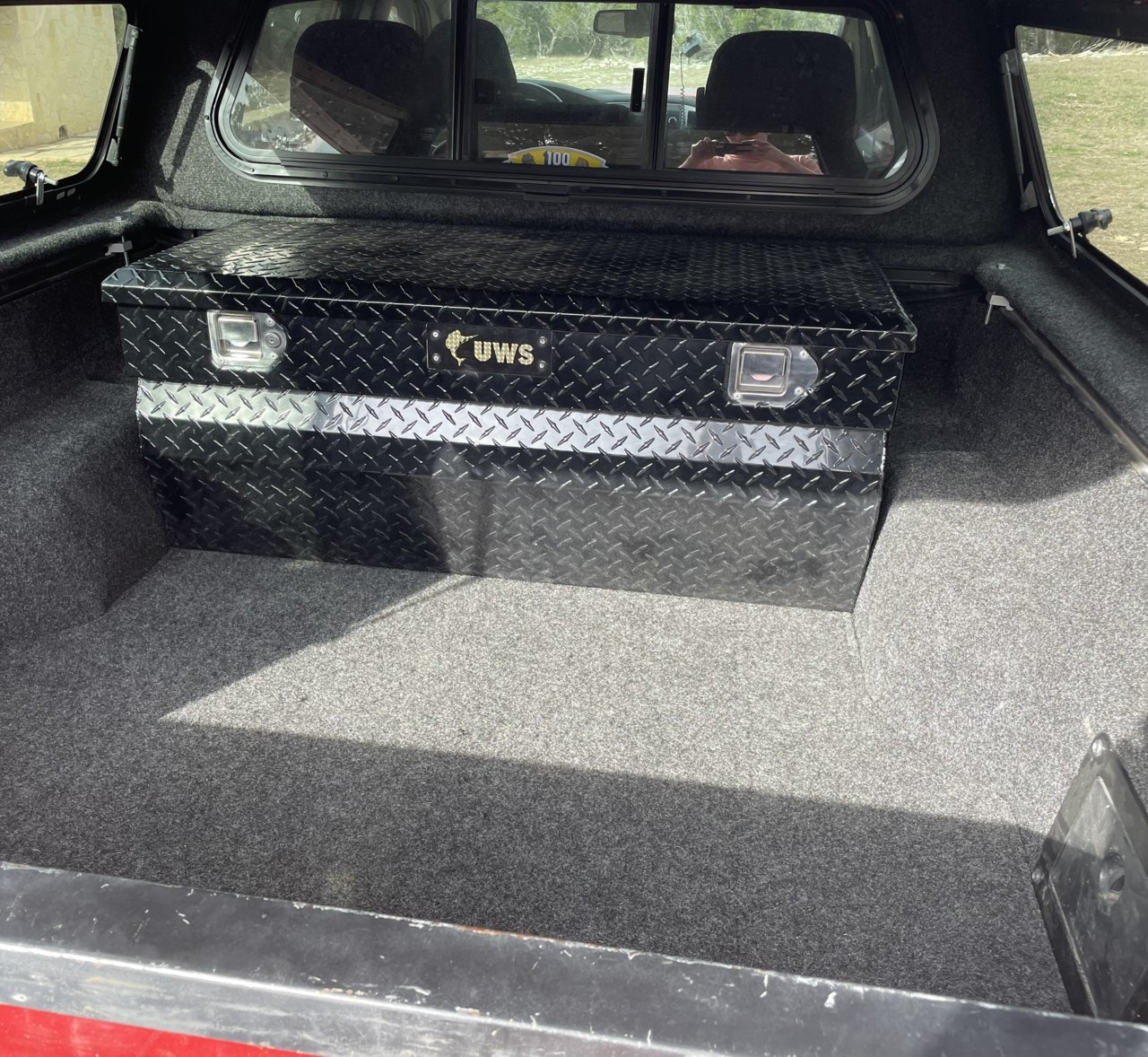

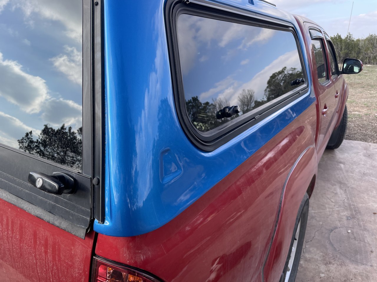

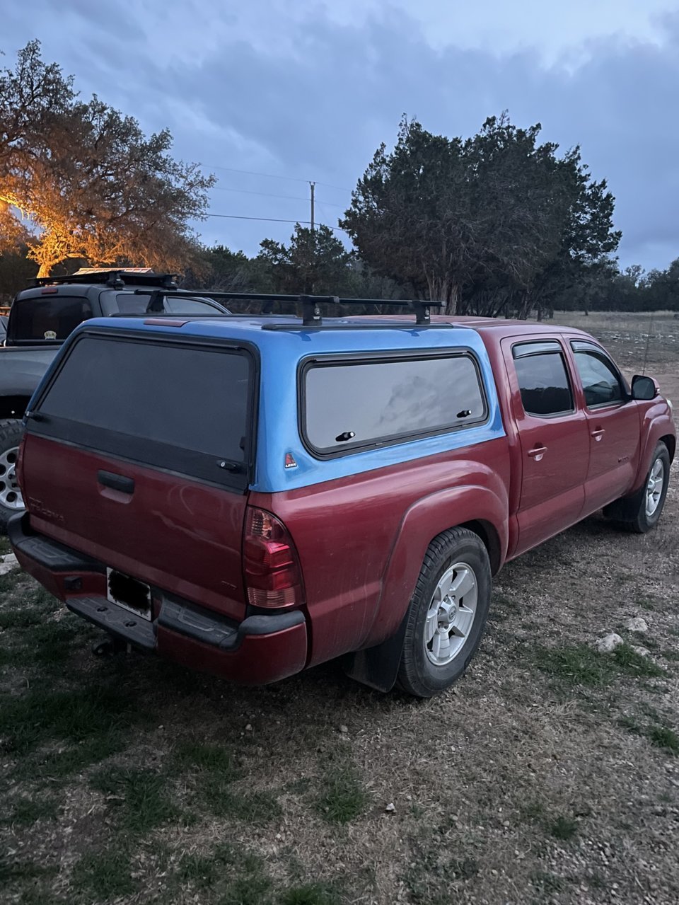

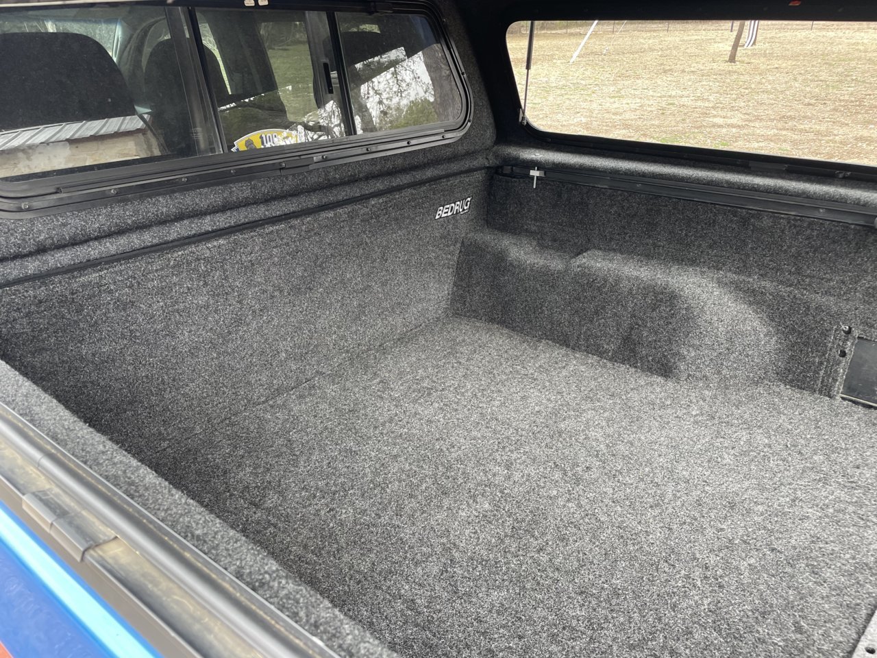

    Got a few things knocked out on yesterday.Started out adding some Thule cross bars from my other camper I had from when I added a basket to that. I also wired in a quick disconnect for the third brake light so it’ll be easy to unplug if the shell needs to come off.
    Then moved on and installed the bed rug. I had to notch my tool box brackets some to allow for a little more adjustment but other than that it was pretty straight forwardD9A9C322-F377-441B-88A2-A43028367D5C.jpg31442449-2F5B-4478-8866-FA170AA3E060.jpg
    Fully debadged to prepare for having it painted. Third brake light will be removed as well as it needs replacing so i got one of those on order. Also ordered some gas shocks for the rear window. I will say the side windows that open are a game changer. Makes it so easy to get to the tool box vs having to climb in there.
