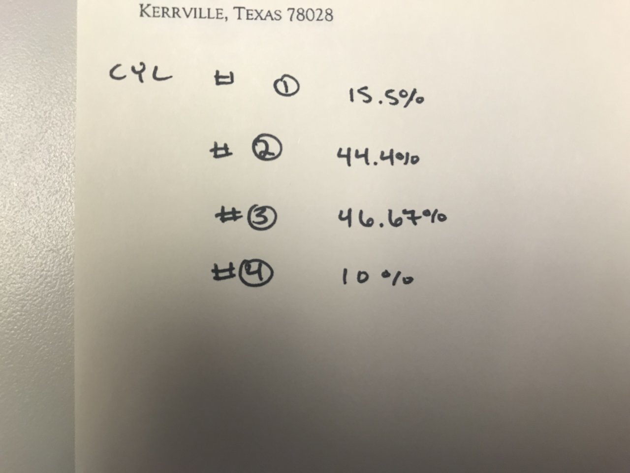

    Well hell, did a cylinder leak down test this weekend, and things dont look good.
    Cyls 1 & 4 have the best numbers and they're still unacceptable. Starting to plan to pull the motor and take it somewhere for a rebuild with upgraded internals. Kinda bummed to say the least, it was 80 miles short of reaching 265k. Weird thing is it hasnt thrown any codes but the coolant reservoir has been filling up and boiling over. Truck hasnt overheated so it should be a solid starting point for a rebuild/refresh

    #2191
    MattCowsmasher
    MattCowsmasher ( -_・)ᡕᠵ᠊ᡃ່࡚ࠢ࠘⸝່ࠡࠣ᠊߯᠆ࠣ࠘ᡁࠣ࠘᠊᠊ࠢ࠘
    Apr 7, 2017
    #215629
    48,694
    Temple, Tx
    O3 Rubicon wrangler
    Dude that sucks!! We’re you having any issues prior to boost?
  12. Feb 24, 2020 at 7:11 AM
    #2192
    BassAckwards
    BassAckwards [OP] Well-Known Member
    May 3, 2016
    #186002
    27,954
    2009 Tacoma AWD Turbo 2TR-FE
    Full-time AWD & BorgWarner EFR 6258
    There was a little bit of noise/pinging under high load situations above 4500 rpms, but other than that, no sir. There werent any issues with the coolant resi prior to adding the blower. I think boost just exacerbated the problem, i was on borrowed time from the get go
