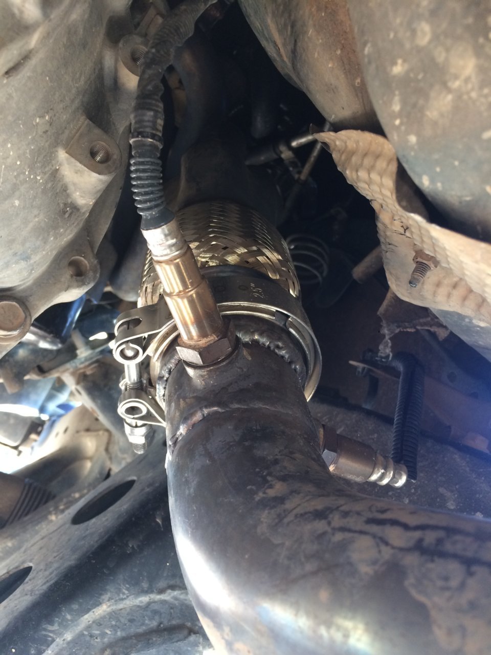

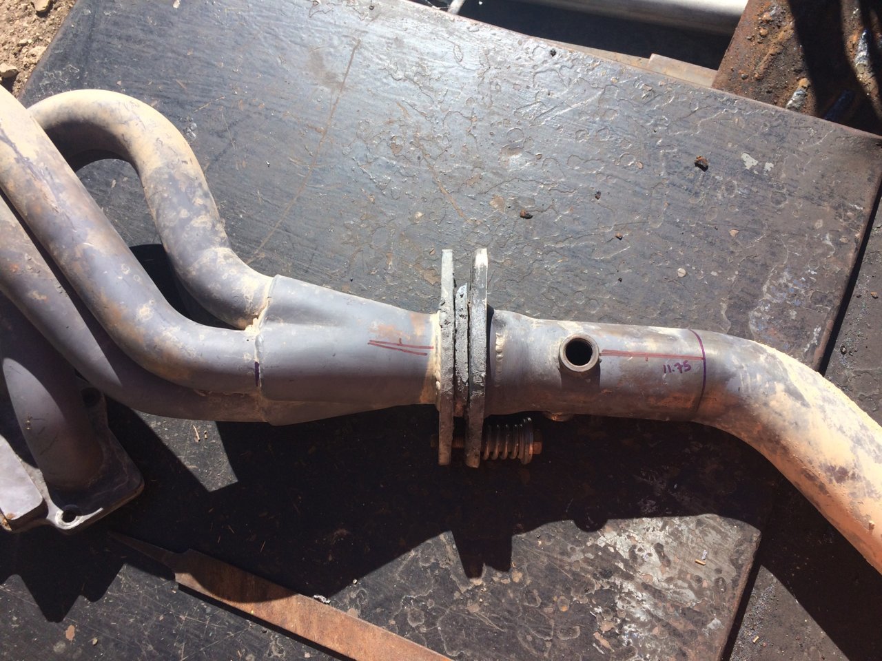

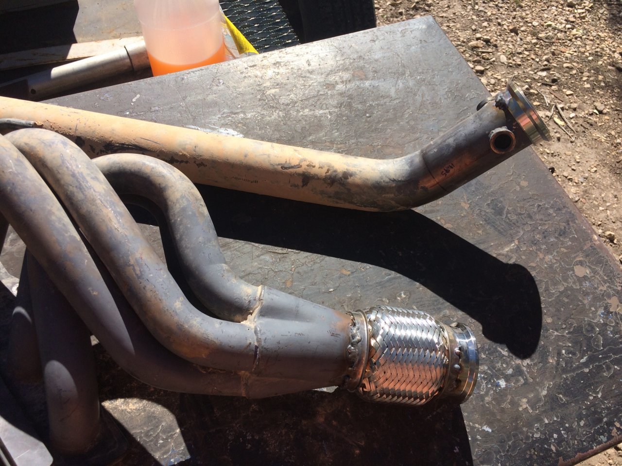

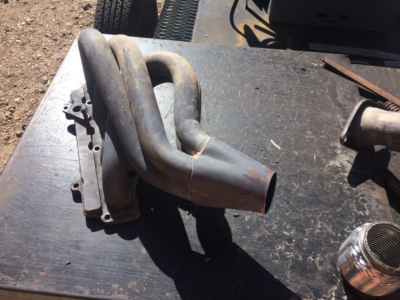

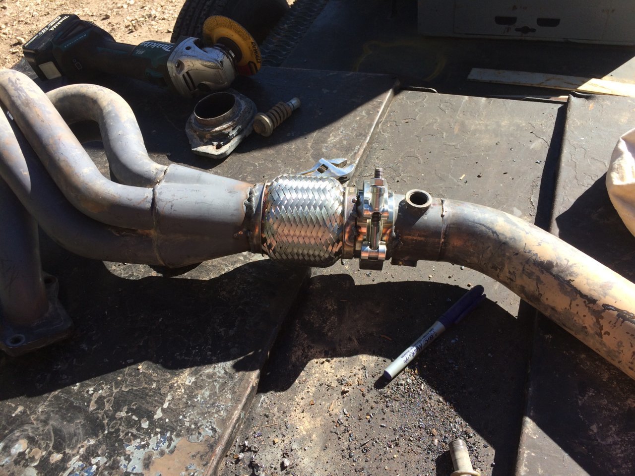

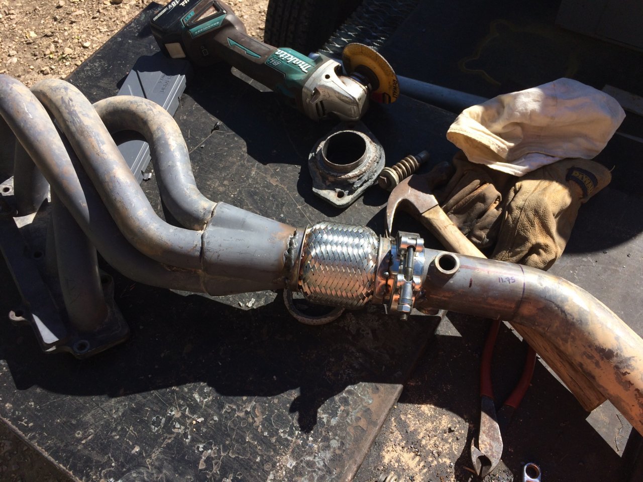

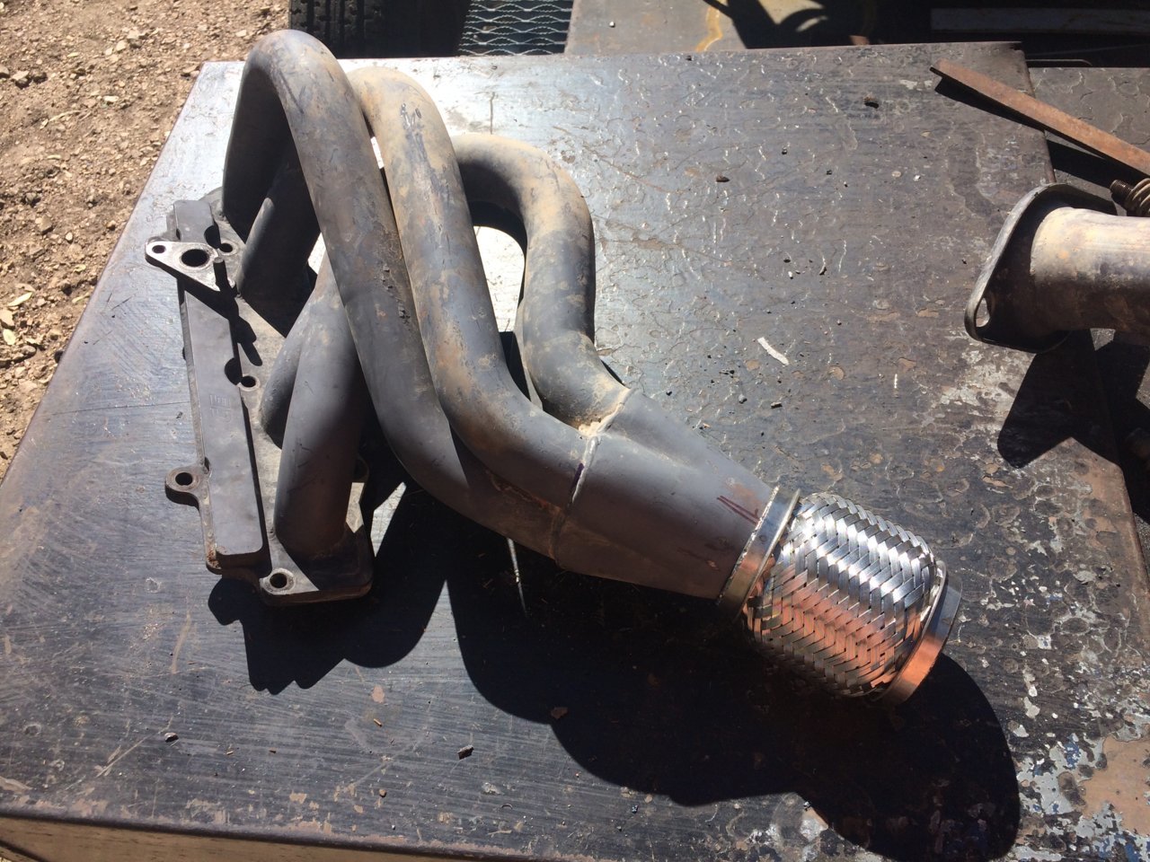

    Well i have been fighting an exhaust leak for too long, but i think i may have finally put an end to that this weekend. I installed a 4” flex pipe with v-bands and relocated the AFR sensors down stream a couple inches to make room. The welds arent the prettiest, but it seems to be leak free so far.

    Nice

    That's about a perfect solution for that I can think of

    You did well

    Thanks, i had to think it through but i am happy with how it turned out! I was definitely nervous to start cutting it all up though lol
    Thanks Maner! It was a learning experience for sure, stainless has been pretty difficult for me. I also need to get a good welding helmet. I tried buying an auto darkening one from harbor freight but it is too dark for TIG and caused me to mess up a couple times. Do you have any recommendations for a helmet that is good for TIG?
