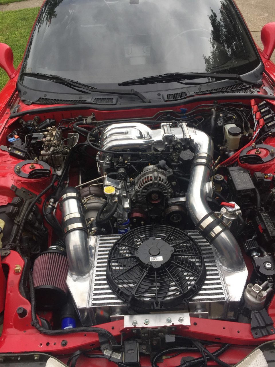

    A couple of years ago my buddy ordered a brand new JDM 13b long block from Japan. He basically said the same thing....lord knows what I'll get! :laugh:

    That's really cool, i've never seen a rotary engine, those things look tiny compared to a normal motor. Looks like he has got lots of time in that project!! Wild to see the intercooler mounted like that too

    Yes.....we've been working on it off and on for more than 2 years now. 400+ HP. It's a beast

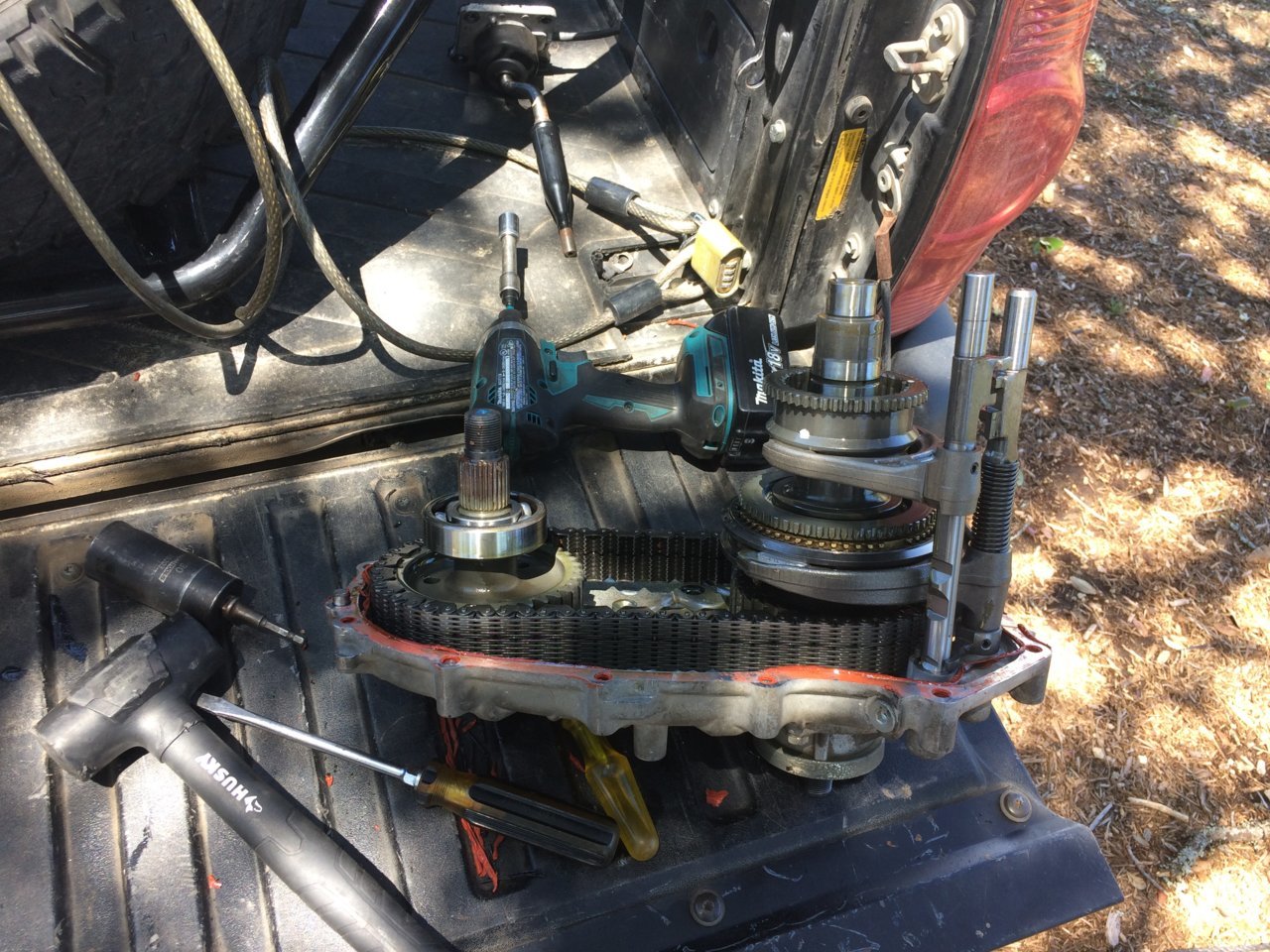

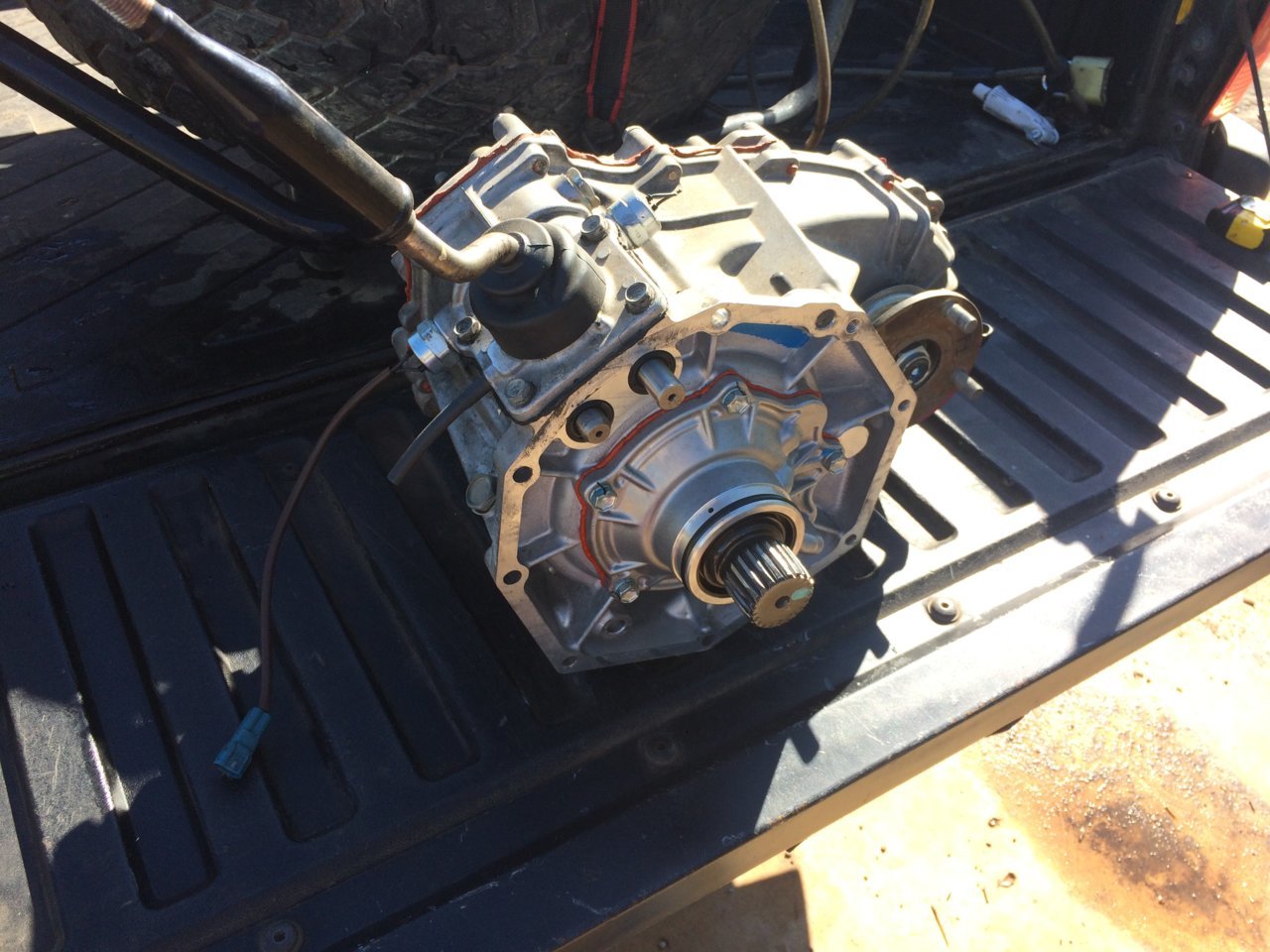

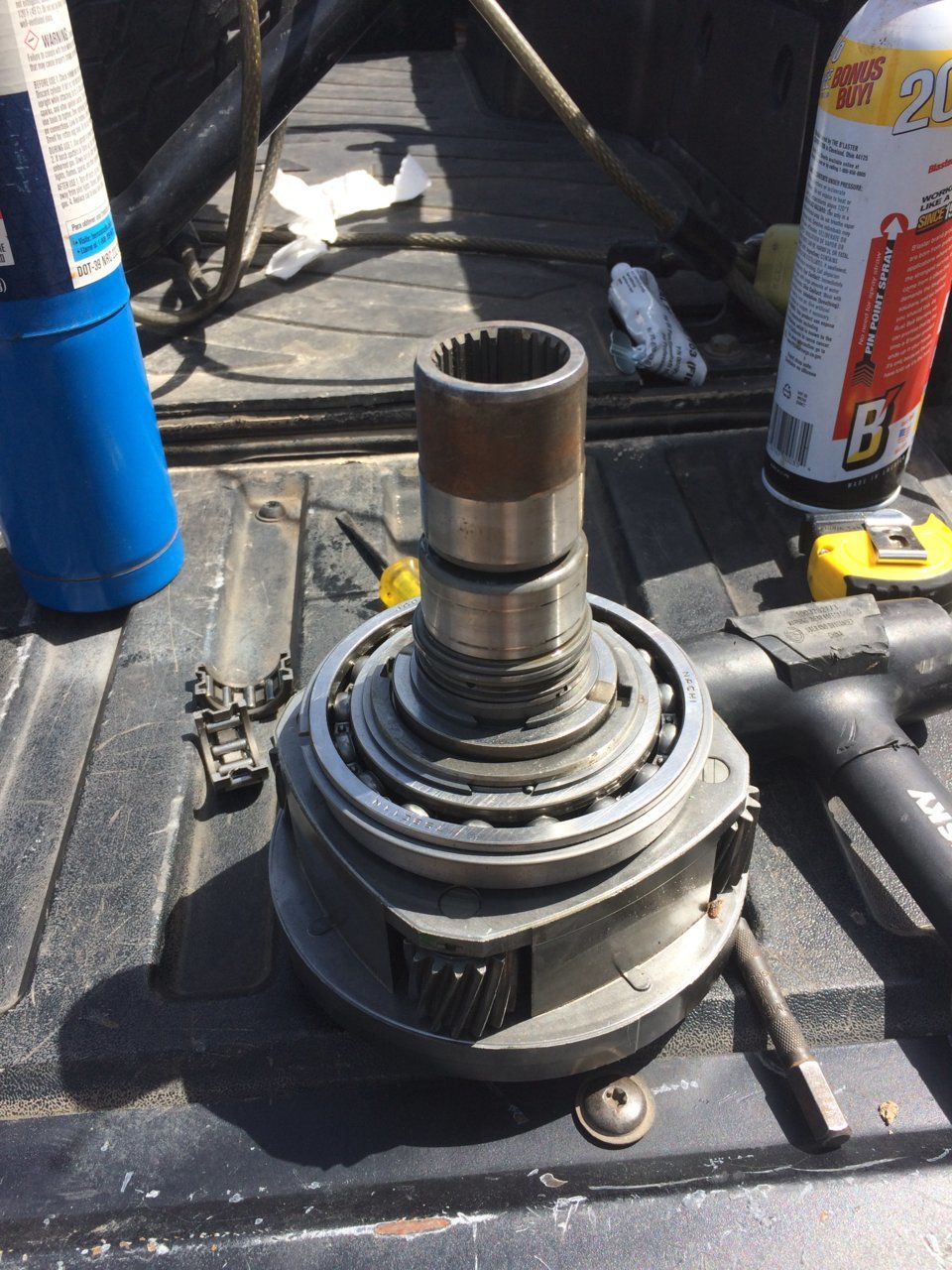

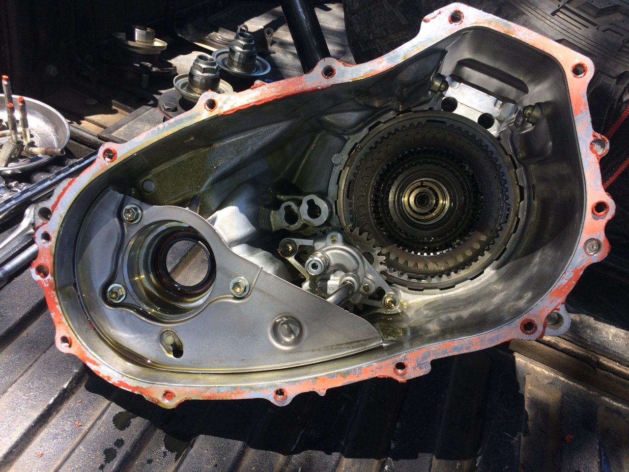

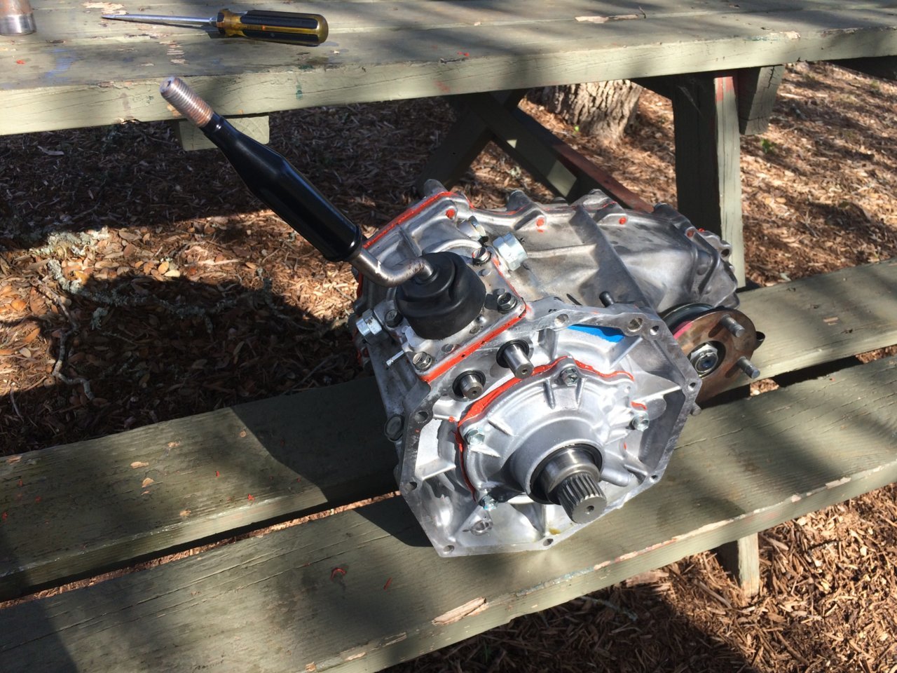

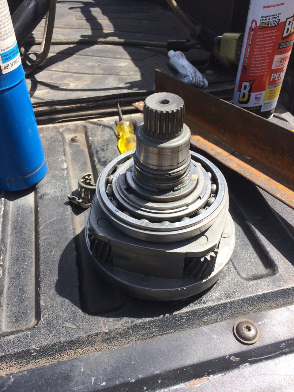

    Did some work on the 4wd conversion today with the FJ t-case. Got the coupler off of the auto t-case input shaft so now it should bolt
    up to a 4wd trans.
    Then moved on to splitting the case to swap the auto trans input shaft back in since it has one for my 6spd currently.
    Swapped inputs and ring gear, and cleaned up everything. Also replaced the input shaft seal since i messed that up the last time i tore this apart to swap inputs.
    Sealed up and ready for it’s partner in crime

    Good mornin Brian! Yeah the FJ swaps are becoming pretty popular these days. Speaking of that, did your case have a breather on the case and on the shifter? In the last pic above you can see a capped port on the case and then theres one near the shifter too. The breather is one of the last things i have to get figured out

    Yep here's what i used https://www.toyotapartsdeal.com/oem...filter=(1=1GRFE;6=5FC;7=DCB;0=GRN250L-PRADKA)

    My Tcase and trans has 2 breathers right next to each other so it connects them and shares one hose.
